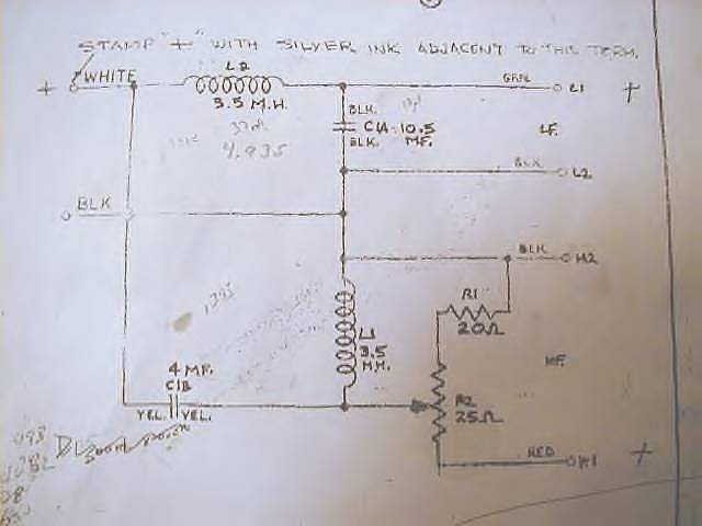

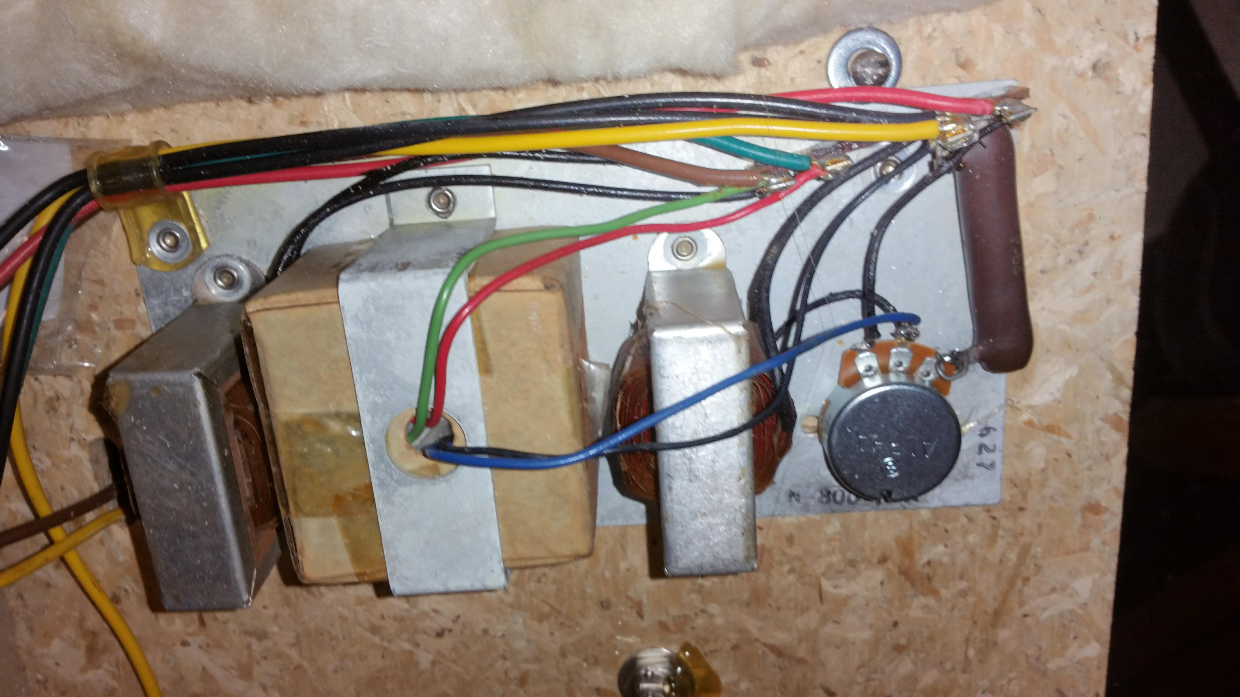

I just replaced the 25 ohm pots on my stock N-800-F crossovers because the originals were non-functional. Unfortunately, I replaced the called for 25 ohm pots with 25K ohm pots. Needles to say, they are also non-functional. I have a couple of 16 ohm L-pads but I am unsure how to wire them up in place of the stock pots+20 ohm resistors. I'm not smart enough to interpret the schematic for an L-pad and then transfer the correct wires from the pot+resistor.

Hi WntrMute,
This isn't really an L-Pad, just an attenuator.
What most fussy people do is replace that with a string of resistors. Depends what you have and what you have time for, because at this point the value you want you'll have to experiment with. I'd suggest getting a 5 and pair of 10s. Put them in series with R1 to (+). Then connect the wiper, or the arrow from the end of L1 to each in turn until you get the right level. So maybe like this:

Thanks EricS. I see what you are suggesting. Currently though, I really just want to replace that difficult to source 25ohm pot+resistor with an L-Pad. There are plenty of schematics on the web but I am having trouble figuring which wire would go where on the L-Pad.

Simply use the 16 ohm pot. Add a 4.7 ohm resistor either side of it, in other words change the 20 ohm to 25 and add 5 on the other side. Then, if you find you want more adjustment on either side, simply rearrange that extra resistance.
Thanks for the good suggestion Allen. I really need to know which wires/resistor in the original design go to which contact on the new pot. For instance, do I keep that big 25ohm resistor hooked up the same way when I substitute the L-Pad for the potentiometer?

If you replace the pot with fixed resistors, you'll want two of them which together add to 25 ohms. First connect one lead from each resistor together, this will be the arrow in the schematic. The remaining two leads are the outer connections of the 25 in the schematic.
If I understand you. The middle tap on the L-Pad gets the two wires (blue & black) that are attached to the middle tap in the picture. The single black wire goes to one tap, either 1 or 3. The 25 ohm resistor gets bypassed by a wire that goes from the last tap to the tag strip. In essence, removing the resistor from the circuit. Sound correct?
Yes. You mention bypassing the 20 ohm resistor and I assume you mean to effectively remove it. Have the two new resistors add up to 45 ohms or so.
The action of the pot in the original crossover is going to change more than the level, just slightly altering the response character, so there is some uncertainty to begin with. A little experimentation is in order.
