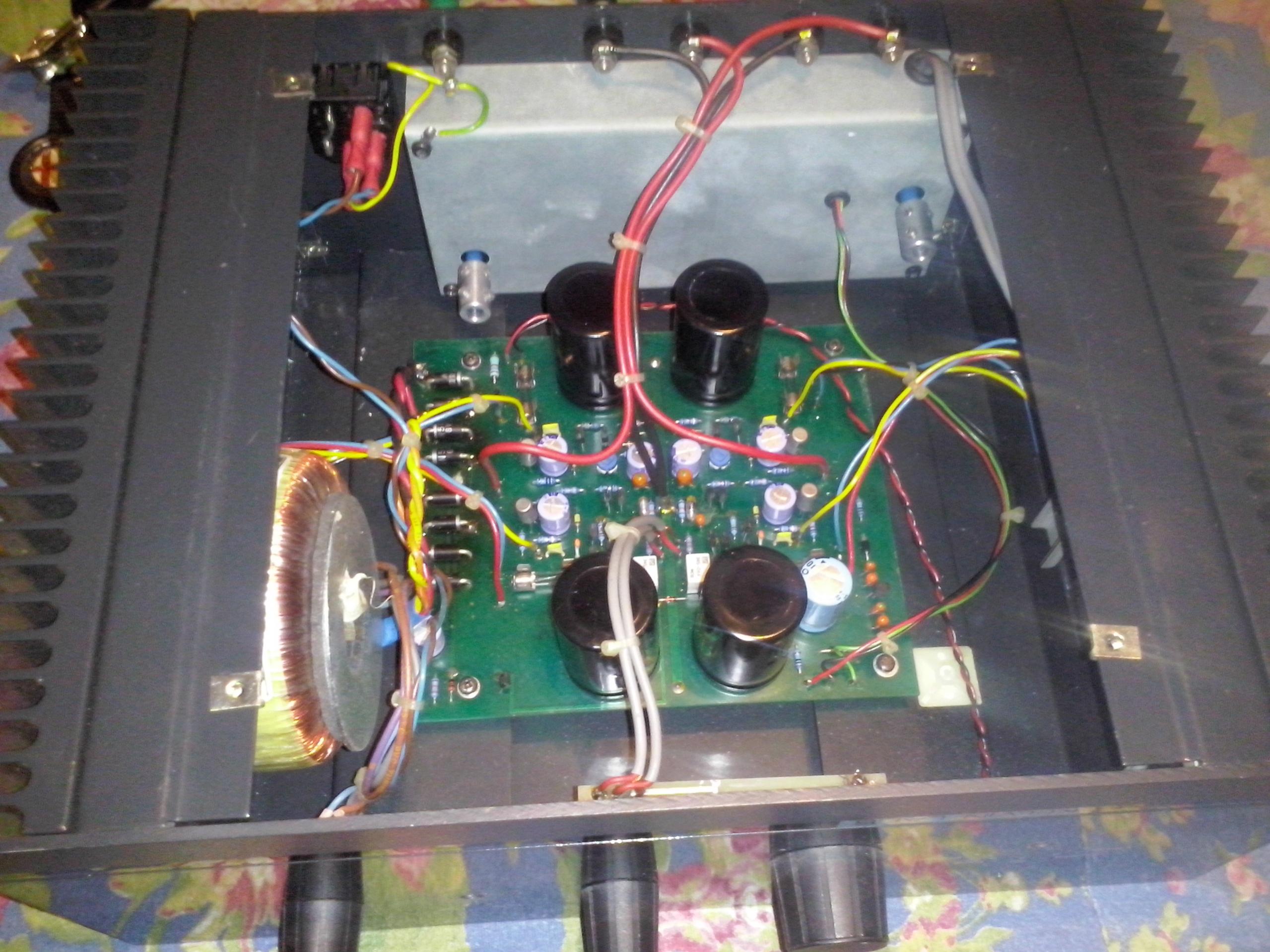

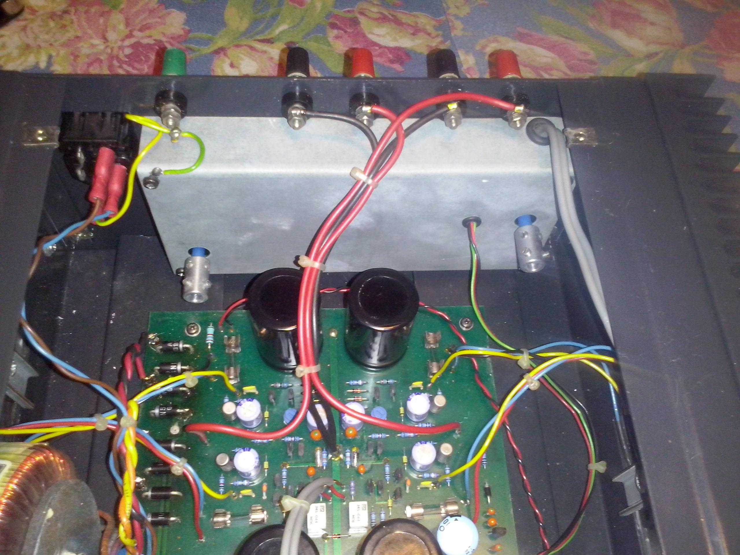

For the ones that never seen one of these amps here are 2 pics from the inside.
It's a small amp with around 330mm (about the size a midi system).
The small grey box in the back is the preamp.
Ric

I tried a Kelvin Labs amp once many moons ago.
CD input was good but I was distinctly unimpressed
with the phono stages compared to my Audiolab.
On CD (I believe directly switched to volume balance)
sound quality was excellent, * until the bass just gave up.
IMO would be a great amp for active bi amping, using
it for mid and treble. As I recall the preamp is op-amp
based, for MC and Phono, cannot recall if there was
a line amplifier or tape buffer, I do recall its pretty
jam packed with components, never a good sign.
Preamp output is top right, around to volume,
then to balance and then to the power amplifier.
Not shown are the knobs and rods for tape
monitor left, and input switching right.
rgds, sreten.

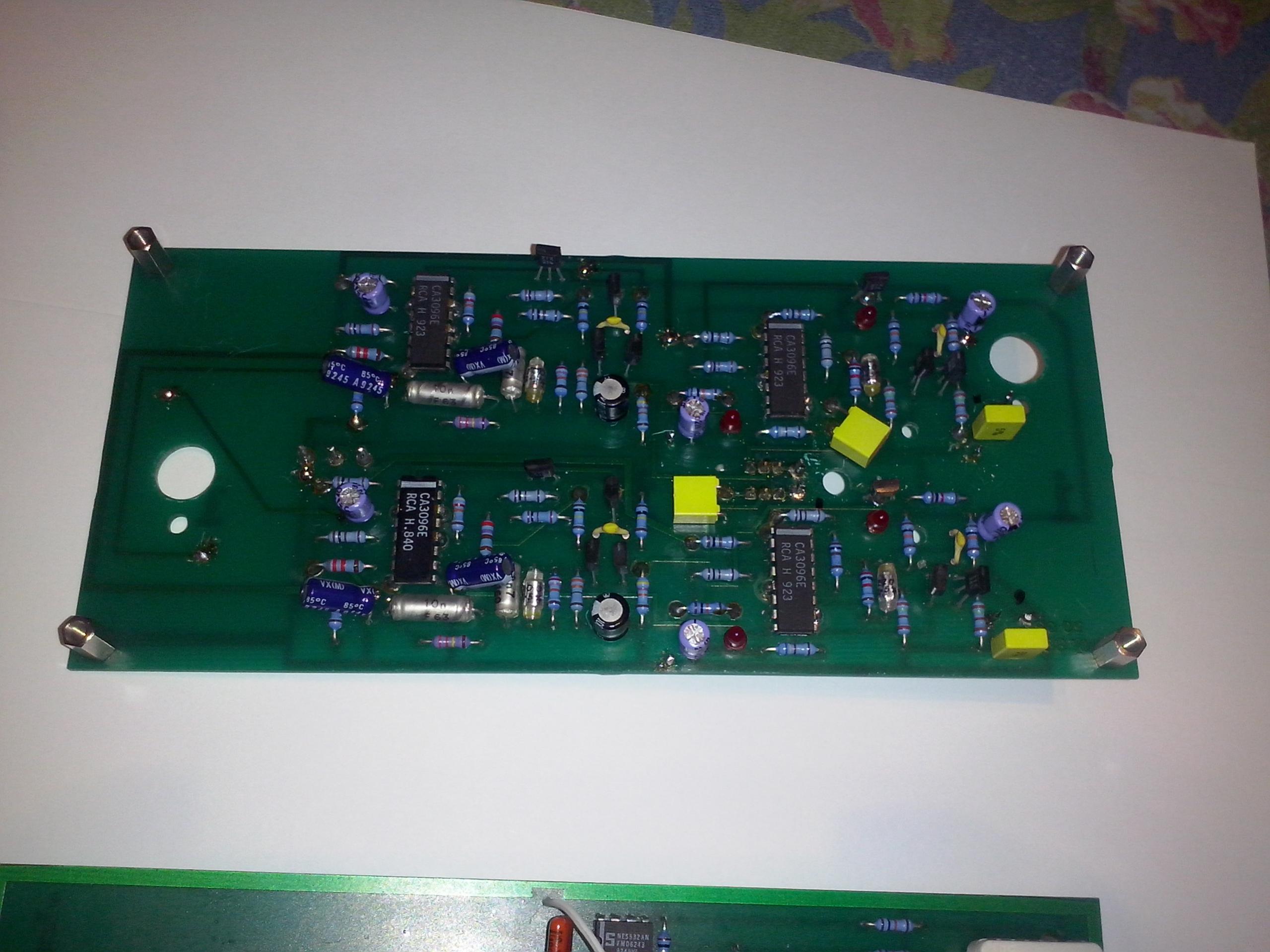

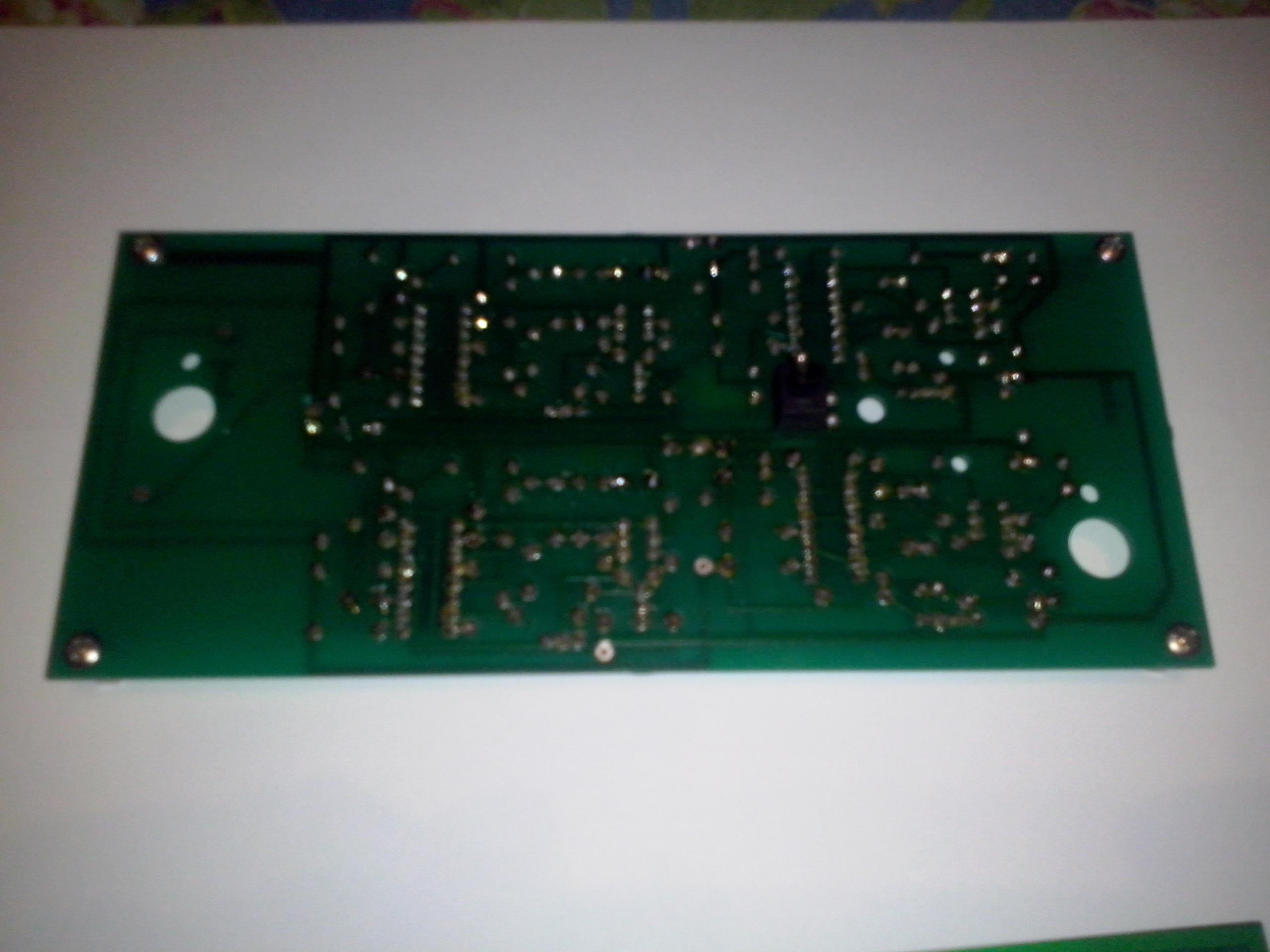

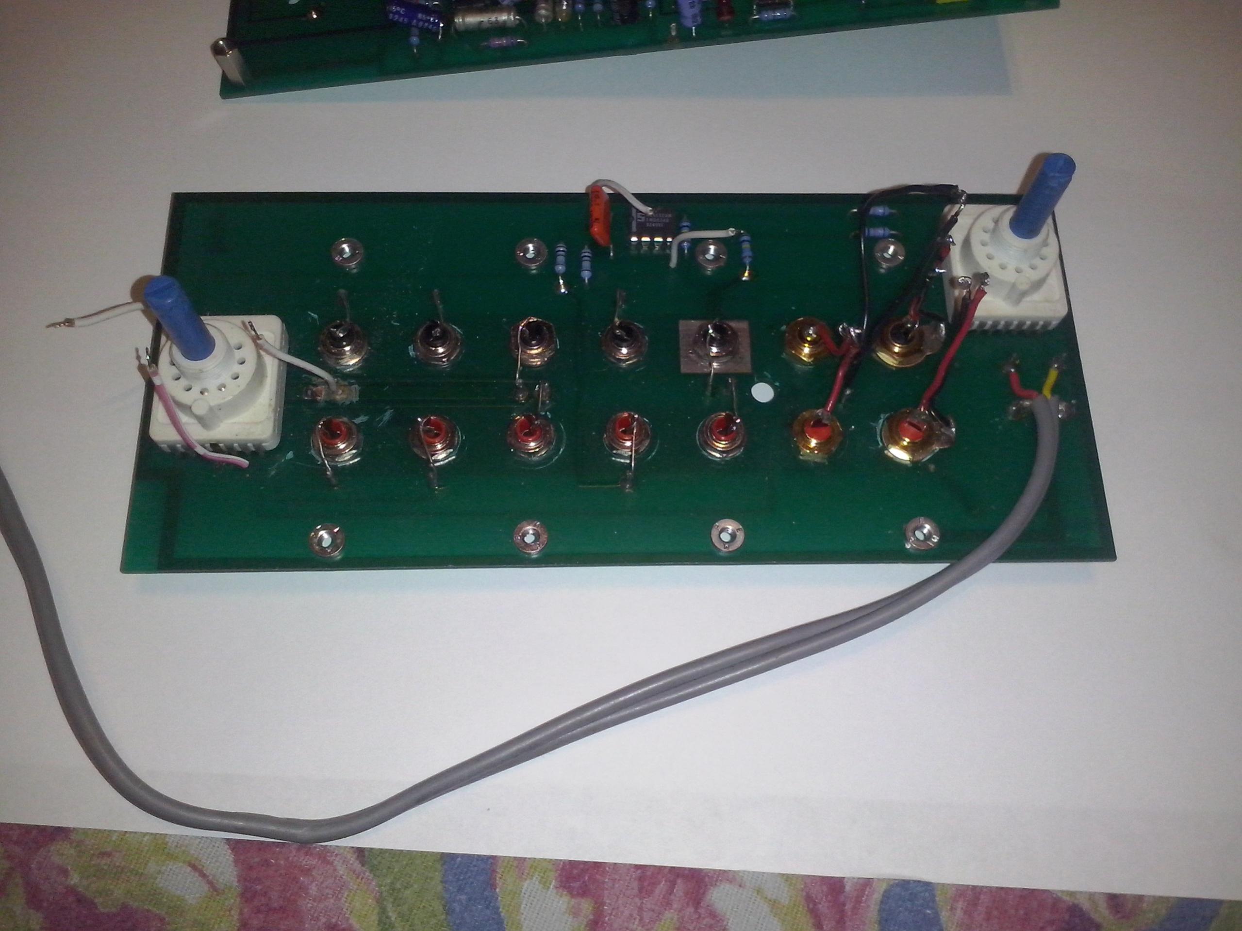

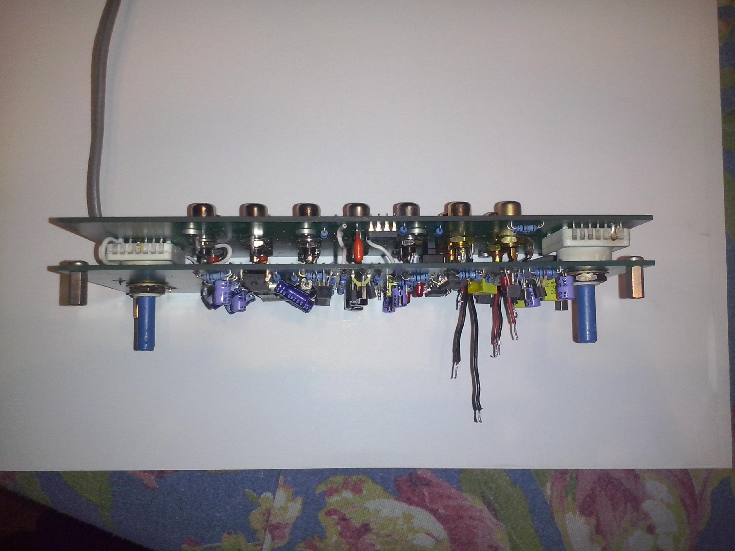

Here is some info on this preamp
1 TL072 opamp (didn't trace it so don't know yet if it is for the tape monitor or buffer output).
4 CA3096E transistors array and some ZTX214 and ZTX384 for input and phono stage.
All caps on the preamp are all tantalum ones and some mylar ones on the phono stage.
Replaced all caps on the preamp for elcos and the opamp for a NE5532.
Result... nothing everything the same, made a small video to record the sound and picture for you guys to have an idea what I'm trying to fix. :headbash:
Again every help is welcome
Ric

The pcb you show in post 10 picture 2 and 3 is the mm and mc pnono pre. I have a pcb just like that as a KL stand alone mm and mc phono preamp.
The ic's on the mm and mc board are just transistor arrays. You do not have a fet input on the mc. If you want to improve the quality of your mm and mc stages you can isolate the pins on the ic which provide the input pairs for each stage of the phono pre. On more expensive models KL used lm394 dual transistors as the input LTP's.
The line amp is all on the main amplifier pcb. The amplifier is designed as an intergrated amplifier with an added mm/mc section at the rear of the amplifier.
Many of the KL amplifiers have slight differences from amplifier to amplifier. On your amplifier the later versions used mosfets as output devices and some had a dac included. These were marked "digital" on the front panel.
Looking at the pictures you have provided seems to show that the rectifier diodes are brown. Have you checked those?
I do not have an overall schematic of your amp. However KL use similar circuits on all amplifiers and if it is of help to you e mail me and I will send you schematics drawings of your mm and mc pre and the two most common pre amp line amps. All of these have been back engineered for my KL amplifiers. ( My hand drawings are too large to add onto diyaudio.)
