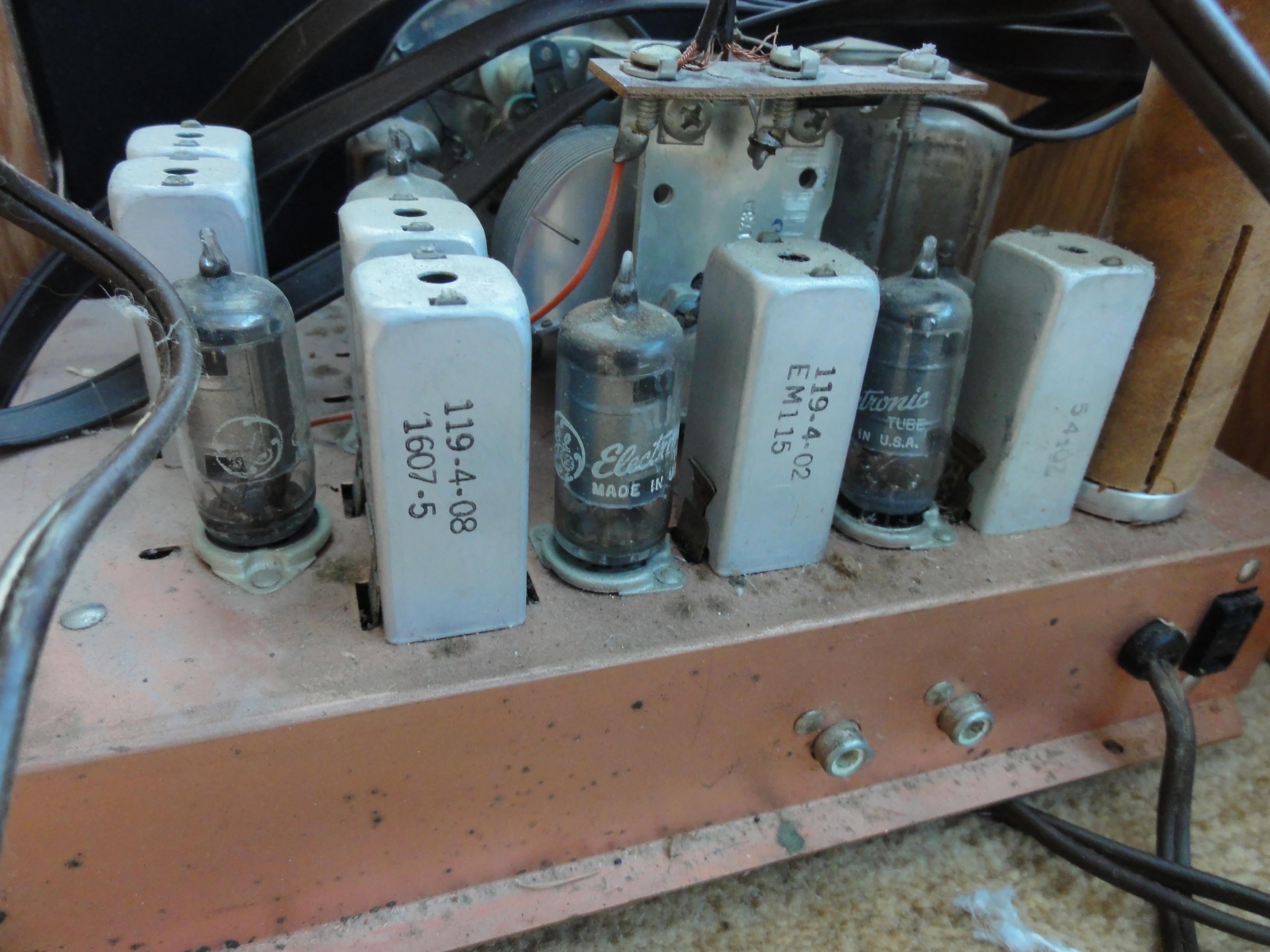

I'm hoping someone can help me. We help seniors downsize, and we have this very old, and because I haven't been able to find a picture of it, maybe rare, Harman Kardon radio and ??? I don't know anything about radios, stereo equipment, etc. but am very curious about this piece of equipment. It has tubes and only three knobs, Off/Volume; AM-FM-PH and Tuning AFC and a radio dial.

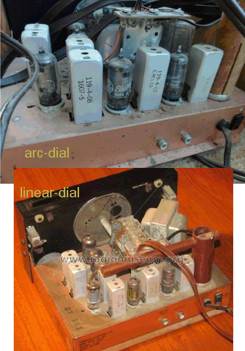

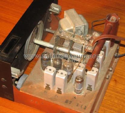

A-200 is clearly the same chassis with linear dial instead of arc-dial. See attached. (200 appears to lack the volume control of the 100.)

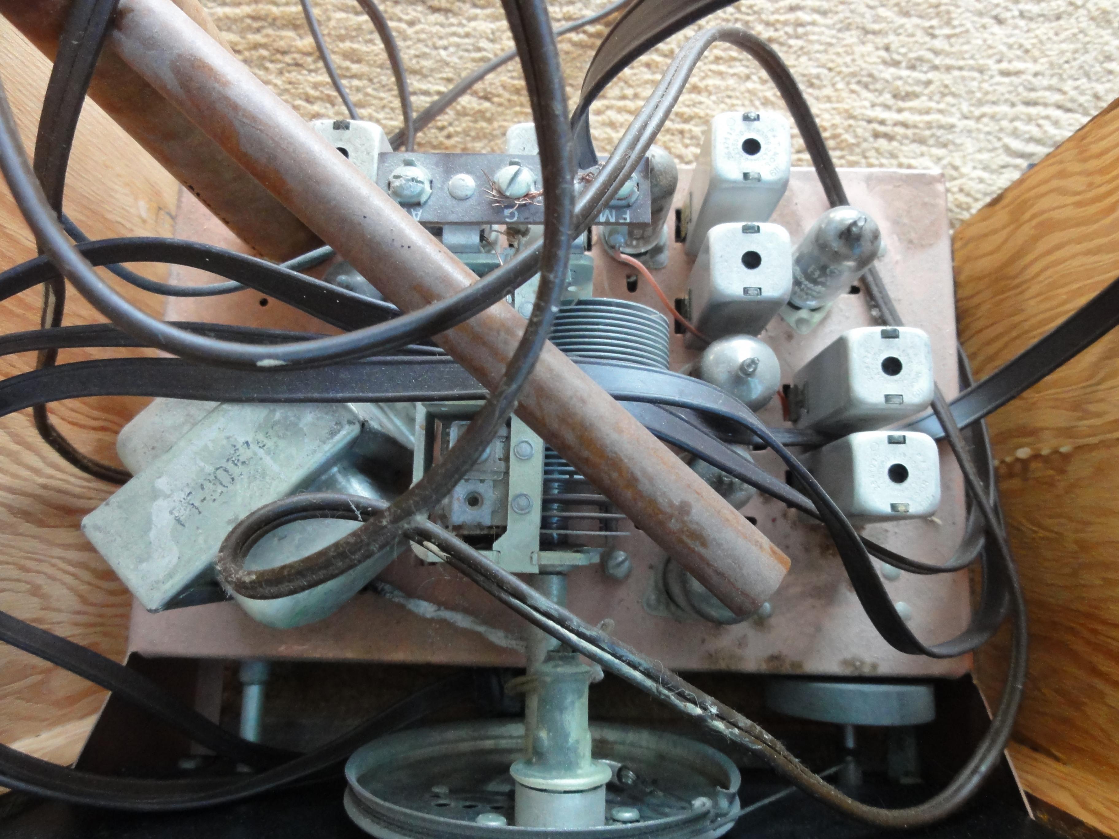

The "wood stick" seen in beasnod's overhead photo is revealed to be the AM loopstick antenna, cleverly mounted on the main filter cap can so it may be rotated for best reception. (And is surely a phenolic fiber tube.)

Wow, that's amazing. Thank you for sending the information and the old ad. So this would have been a piece of equipment you would have custom built into a cabinet? If I were to try and sell this for the owner's daughter, where/how to market and how much should I ask. You can see from the picture that it's in good condition (at least the looks), and it would be wonderful to have someone rebuild it or use it.
