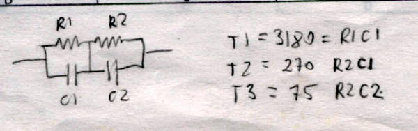

Anyone able to identify the two silver caps on that board?

Capacitor type.
If you mean what type they are : - they were called styroflex capacitors over here. I never knew why it was called that.
One doesn't find them nowadays in this market.
If you mean values , you might have to rotate them around. The value is usually mentioned quite clearly . I have several of these types ( old stock !).

Forgot some details.
These are metal film caps unlike the metallised foil that is very popular today. Basically I think they are made with two metal foils and a plastic film rolled up into a roll. I have no idea how good it is compared to modern day film caps. But I have seen 2.5% types and so they must be pretty good I think.
I have seen values from 100pF to just over 0.01uF.
If the circuit is a phono preamp, you could check the resistor values and calculate the cap values . It looks like a standard phono feedback circuit.

It seems like you already have the values on the attached schematic. Here's the equasions which you can use to check if the values are correct.

Edit: 270 and 75 should be followed by " = " which is missing in a drawing.

I believe 0.0027uF (2700 pF) and 27K ohms is what comes close to the 75 uS time constant. The exact value would be 2778pF for the precision people and could be a selected 2700 pF cap or selected 27K resistor picked to match the cap value.
