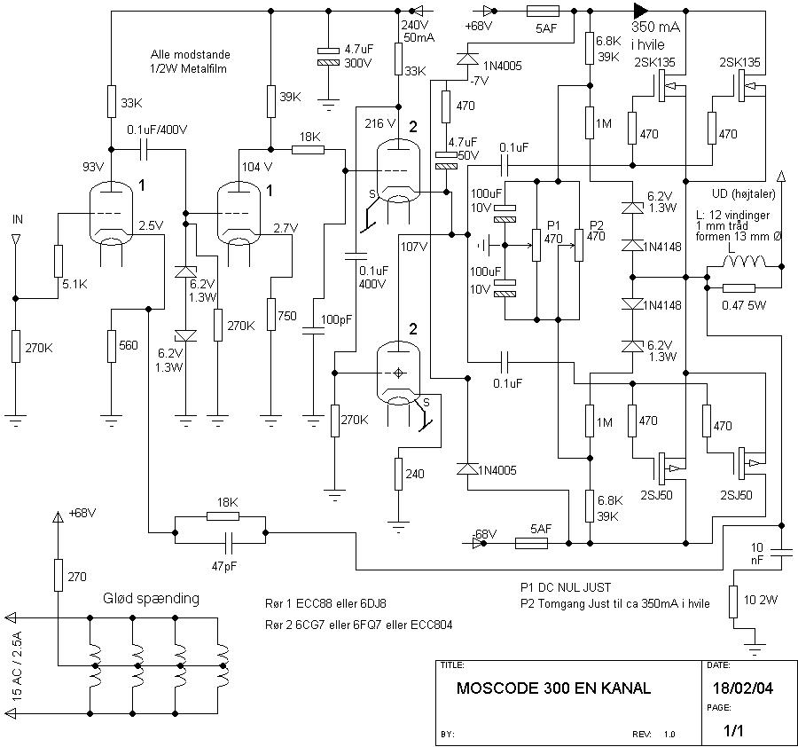

I have found a schematic of the MosCode 300, on the Web. And I am posting it.
Look it over, and for those who are not heavy into electronics at this time.
Talk it through with someone who is.
Later, I will post the original schemtic of the MOSCODE 300. So that we can compare them.
Take Care
Ivey

Hi Wavebourn:
I do not think that the MosCodes would sound better than any other power amplifier actually.
It does sound good. Great..., that is a horse with a different color.
I am not pushing hybrids because I care for them more than other power amplifiers. I am pushing them because they sound more linear than BJT's power amplifiers. They use some vacuum tubes and they are less expensive to build than an "all tube" power amplifier.
Vacuum Tubes pricing have gone through the roof. And it is all because the items are no longer made in the USA. And I feel that it is a crime that retailers are fleecing those that desire to use vacuum tubes.
It cost no more to import items from one country to another. The Free Trade Act, reduced tariffs, and reduced import fees and government incentives towards Imports and Importers, have reduced the cost of imported goods to America.
The problem today in our nation, is that Manufactures, Importers and Retailers; are passing not only their overhead costs on to the customers. But any and all costs that they may incur.
They have started this ripple effect throughout the commercial system. That is draining the savings and the life out of most citizens in this country.
I enjoy the sound of good iron and glass. But at the prices being charged today; I can not afford it. So my hobbies and past time is being threaten by the greed of Wall Street and their BMW driving crowds of yuppies.
So I am trying to get people to think hybrid. To think cost cutting, in an effort to keep the hobby affordable. I am thinking promote "through the hole" electronic parts. Because it is too difficult to remove and reuse SMD parts.
I am a jazz guitar player. I love a good sounding tube amp. But it costed me close to $100.00 to re-tube the Super Six Fender Amp, I once owned. So I sold it.
And I built a 100 watt, hybrid unit. It uses one vacuum tube.
If we can get people into designing more and more hybrids. We can produce better and better units. Until we have designed the best that we can produce.
I want these young men and women to see that with a little knowledge. They can do great and wonderful things.
Take Care
Ivey

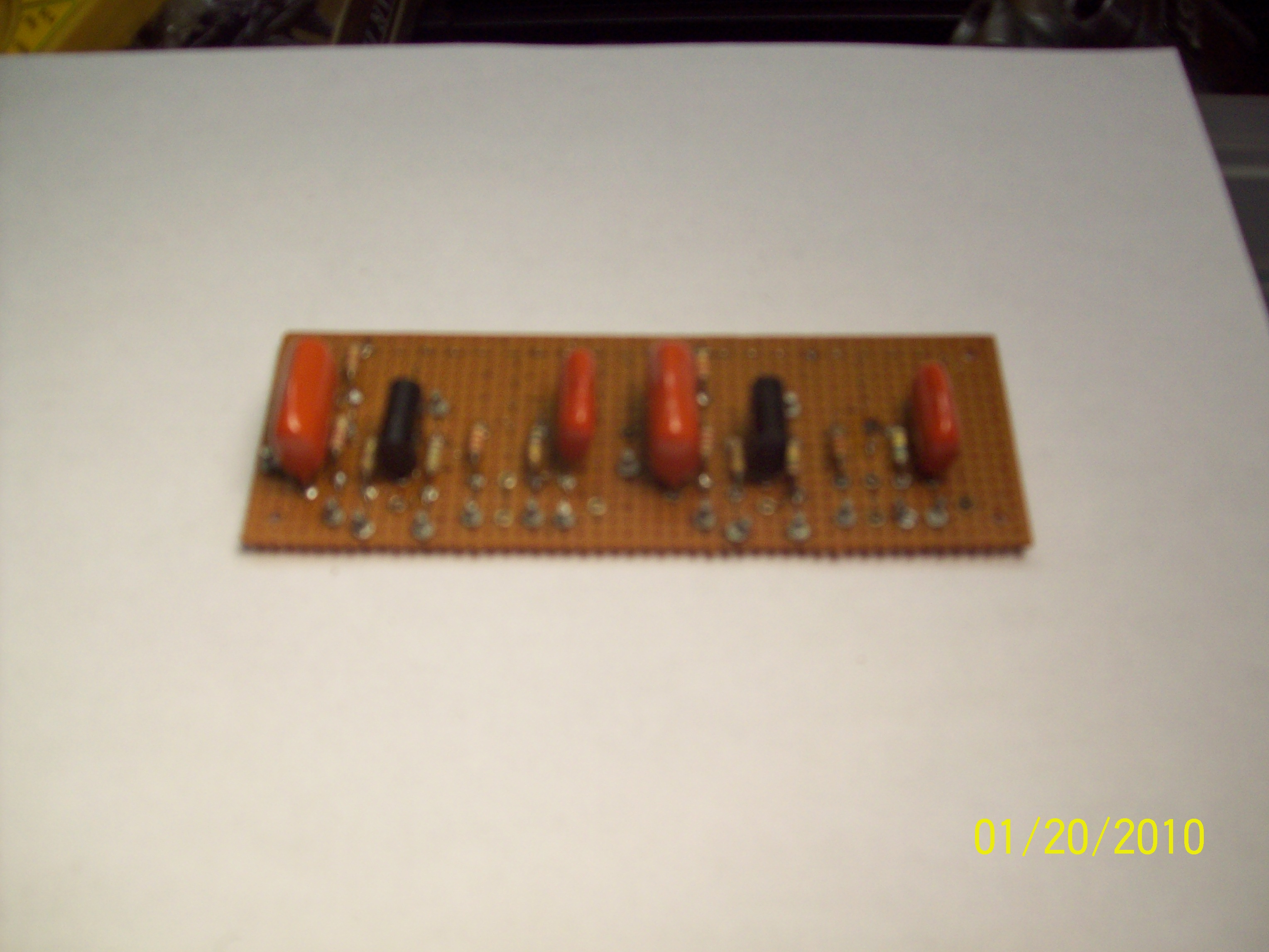

Here some of my circuits that I made for this thread. With lots of Wima Caps.
Take Care
Ivey

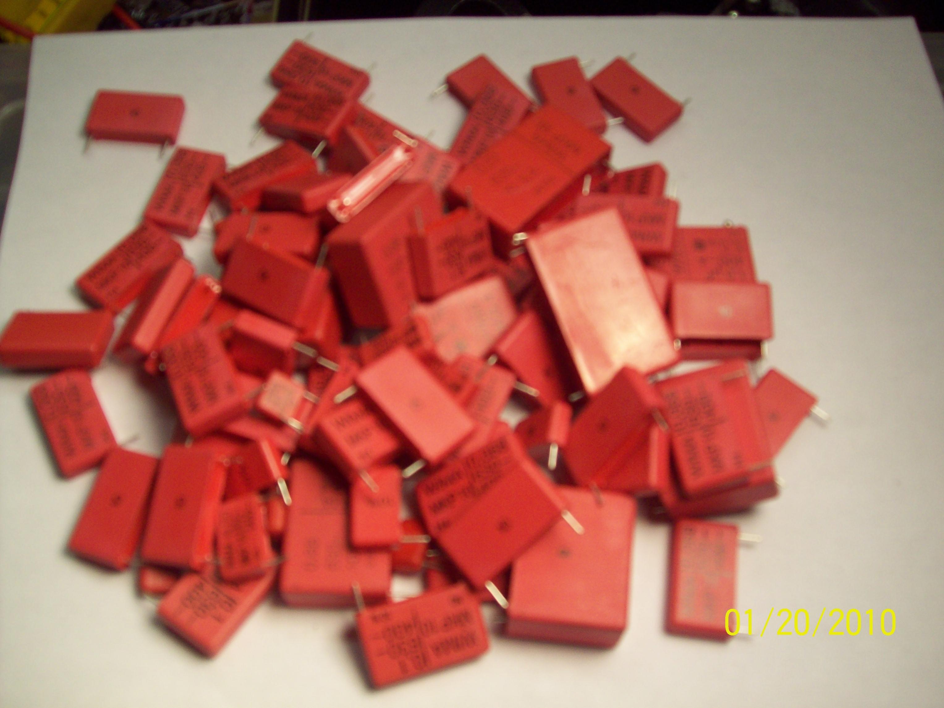

Trade!!!!!!!!!!
As you guys and dolls can see, I have lots of Wima Capacitors for trade. I like Wimas, I prefer Illinois MKS or MKP capacitors, at 5 to 10%
My Wimas are MKP10 250 volts, 400 volts, 600 volts. 5 and 10%
There are a lot more.
Take Care
Ivey
