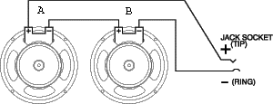

To wiring of multiple speaker systems, the speakers connected in series and parallel.
In series connection, is the speaker still have the basic parameter?? As in the diagram, 'speaker B' looking 'speaker A' as an inductor ...... or?????

you can say that with 2 drivers in series each looks like an inductor to the other but the inductor value of teh drivers are a bit small and hence can be ignored. all the same with 2 drives in parallel each looks like an inductor to the other too only this "inductor is in parallel not series.
