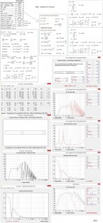

I've been scouring the threads on this board as well as the internet and I'm having a hard time figuring out if my cabinet design is going to cause me interference or diffraction on the back end?
I'm a little new to this, so you'll have to excuse me if the answer is simple or easy to figure out/find.
The black intersecting lines will be braces, but with large squares cut out to reduce internal ft^3, and keep it from being completely sectioned off...
Any help would be greatly appreciated!
It is a subwoofer, the wavelengths involved are so large they won't even see the outside of your cabinet.
With 2 woofers you really should take advantage of push-push loading, it will take a BIG load off the box.

just to be thorough, you are saying that the spacing between each sound wave will keep it from having interference, so the alignment in this scenario isn't an issue? I assumed, because each speaker will be playing the same frequency so close to one another and angled, that it might cause some sort of cancelation...
Angle is not relevant, it's the path-length difference between each source and the listening point. At the worst case, that's the distance between the drivers.
Given that the wavelength of 50Hz is just under 7m and your drivers are 0.3m apart, interference is not a problem - it will act as a point source. Once you get up to 550Hz, it will produce destructive interference in the lateral direction so make sure your crossover point is below 150Hz and it'll be totally fine.

I'm repurposing two Lanzar Max 12d subwoofers. I have a shoddy trunk that is leaking, and I don't want my speakers to get ruined... so, instead of retiring them, and since my girlfriend is wanting more uumph to her the home theater, I'm creating this project around her strange aesthetic requests.

FYI:
b:)
