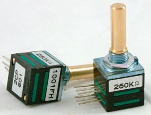

I measured DC on the pot and here are the results:
pin 1=earth
pin 2=signal out
pin 3=signal in
pin 3 fluctuating from 1.1. to 1.7
pin 2 steady at 1.5
across pins 1-3 fluctuating from -3.0 to +1.7
While measuring the pot I came to the interesting finding, if I place one hand on the pot and the other hand anywhere else on the chassis I get no more scratchiness while turning the pot up or down, I am not saying the the pot is completely silent but it is 10 times less noisy then. Does that indicates grounding problem?

The differences in voltage. One side of R535 and R536 both go to signal ground and so those points are taken to be are "zero" point. I suspect the tiny voltages you are measuring are down to method/equipment/leads etc. To read the voltage on those resistors try reading across each one rather than from ground to each end.
The two ends that go to ground should read zero between each.
Sounds very strange that the pot is less noisy when you touch it and the chassis.
Isn't the pot fitted all plastic bodied.
It won't harm to wire the pot in parallel but the results could be misleading. If it's quite then you have to isolate the old to further prove the theory 100%

I will then measure across those resistors, I have two DMMs, will use them both.
It isn't all plastic, look at the picture.
The metal mounting should be electrically connected to screen/chassis.
It is, that nut tightens it to the chassis. Andrew, I often remember your words "Life is so easy for a retired single person", I even showed your post to my friend who is also married and we both agree with you, he said that is something Jedi master Yoda would say probably.

Check continuity. What is the resistance from chassis to metal mounting?
Resistance is 00.2 ohms

Hi Mike, welcome back. I must explain my actions, I was rotating the volume potentiometer without the knob. I just found tonight that rotating the pot with knob or some other kind of isolator between my hand and the pot shaft makes rotating the pot completely silent, yes no more scratchiness Is it allowed to touch that brass shaft directly, and if it is not why was the scratchiness in right channel and not in left also?
Touching the plastic body with fingers produces a noise in headphones, like a slight buzzing which intensifies with fingers moving closer, but i think the noise does not come from the pot itself but from the wires that go from points 11 and 12 on the schematics to pot output pins. I was using pencil with graphite (probe of the poor) to trace that noise following the the leads to pcb.

As I suspected the ground on the volume control shaft is not working and your body is the source of the voltage being picked up by the control. Welcome to the world of electrostatics! the cause is, in essence, arcing that occurs between the volume control shaft and the grounded mounting collar to be picked up and amplified by the gain stage following the control. Touch the chassis ground and there is no voltage difference between the shaft and the chassis so no noise. It's caused by the same effect that causes one to experience a shock when touching a doorknob after walking across a carpet on a day with low humidity. You'd be amazed at the normal voltage levels present on the human body and the things that cause them. It does point to a bad ground in the control though, and the answer to your question: yes you should be able to touch the control shaft with no noise.
Why one channel is noisy and not the other is a combination of leakage paths, proximity effects and impedances that come into play that allows one channel to easily recieve this transmitted signal and the other to be unaffected.
The simple thought here is that the control is not right as most of these controls do have a ground wiper and a ground path for this reason.
The buzz when you put your finger near the control is a different issue but not uncommon and probably has no effect in normal operation.
