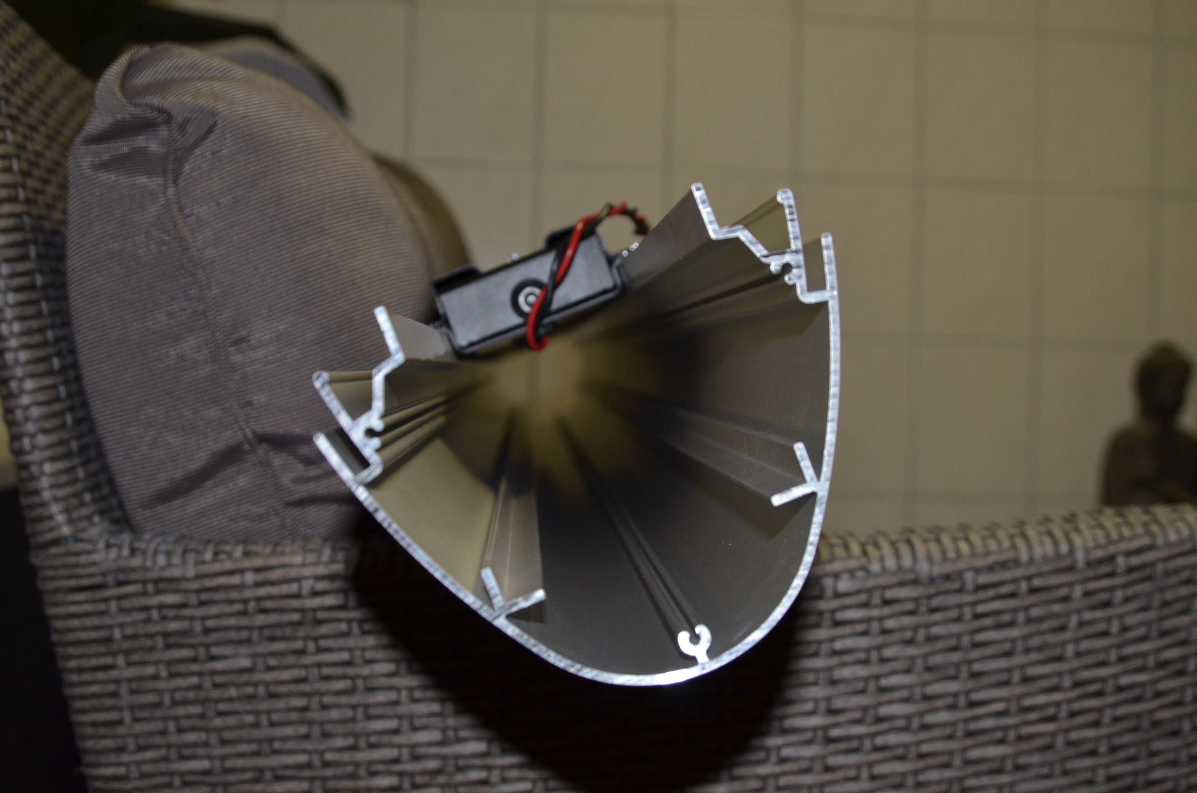

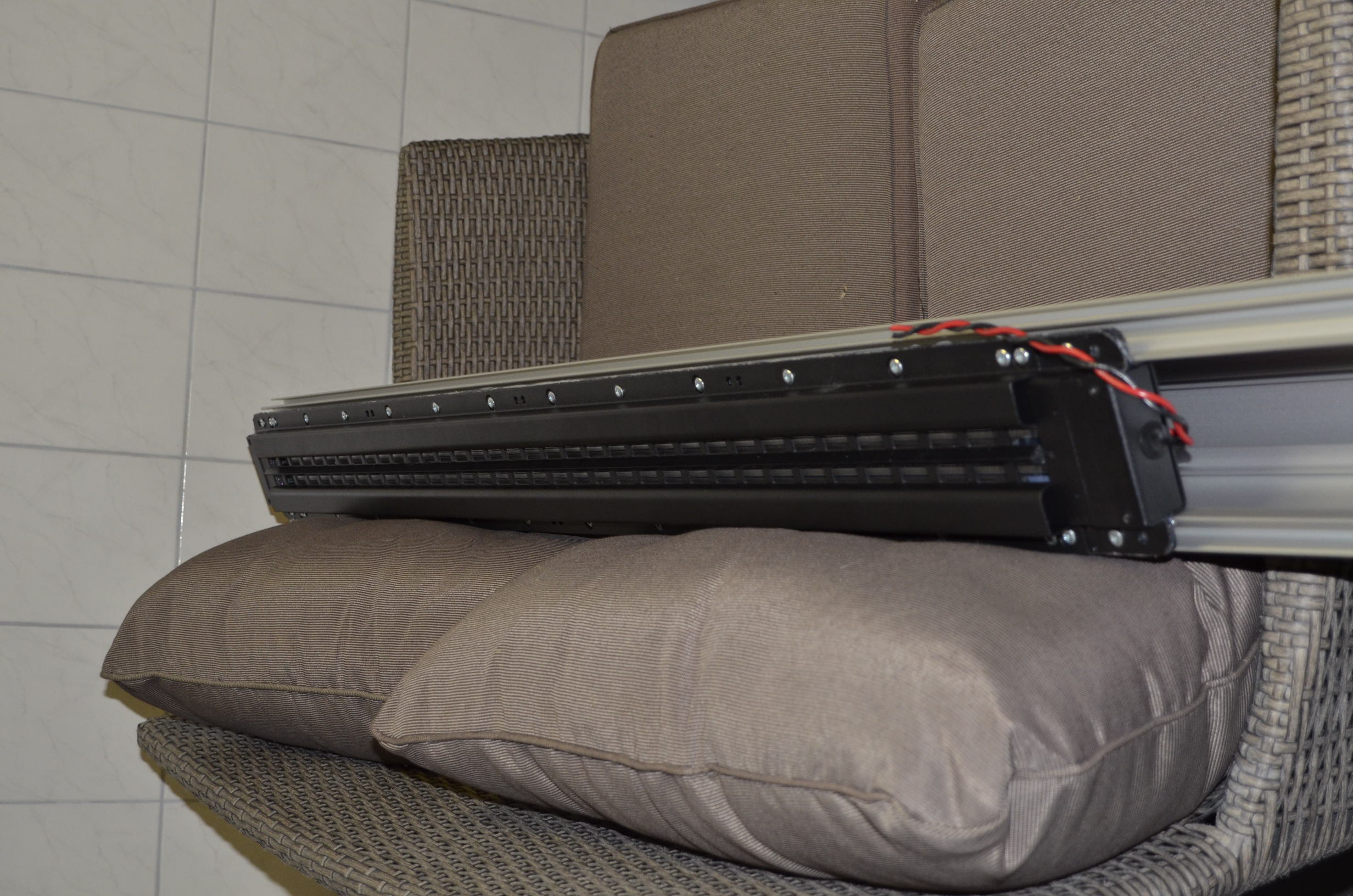

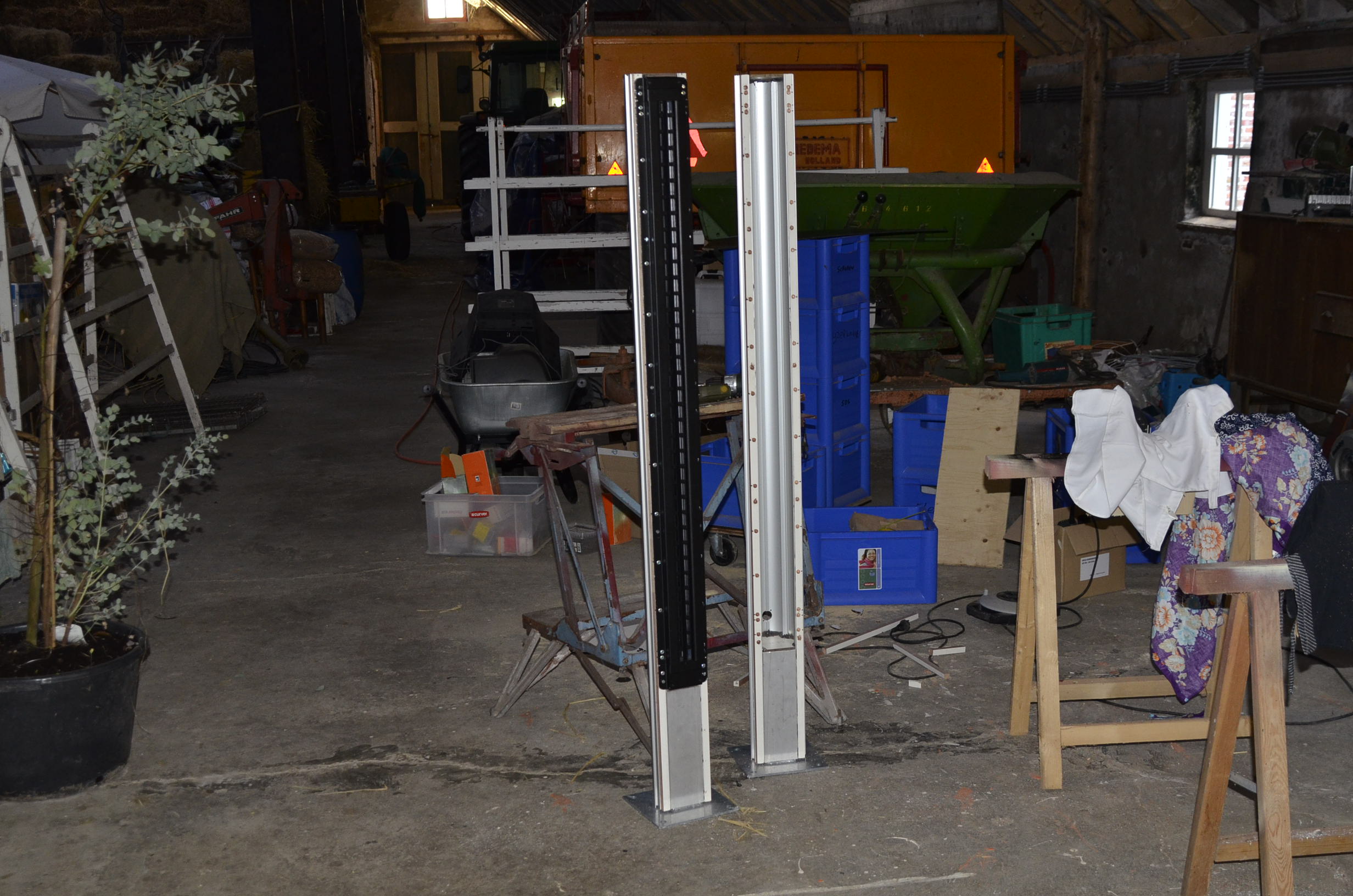

Thanks for the pictures. Is there a minimum volume required. What kind of damping material did you use. What crossover frequency did you use? How does it sound?
GWho
There is a minimum volume mentioned in the spec sheet and the freq. plot is done with this enclosure. I am using a little bit less volume because I discovered this nice aluminium profiel ( used for advertising boards). Can not tell something about the sound, I am still in the building proces. It will be combined with JBL 2235 15" low drivers and will be powered with 4 Hypex Ncore's and DLCP
Thanks for the additional pictures. That is interesting. I will look into aluminium extrusions and see what is available out here.

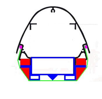

And what are your plans? I was hoping for answers and for hints more then a year ago :eek: . Well at the moment I am planning a sealed enclosure for the RD 75 analogous to the attached drawing, about 2 m high. In addition I build one or more subwoofers with isophon PSL 320/400s. All together actively driven with hypex plate amplifier model FA502
