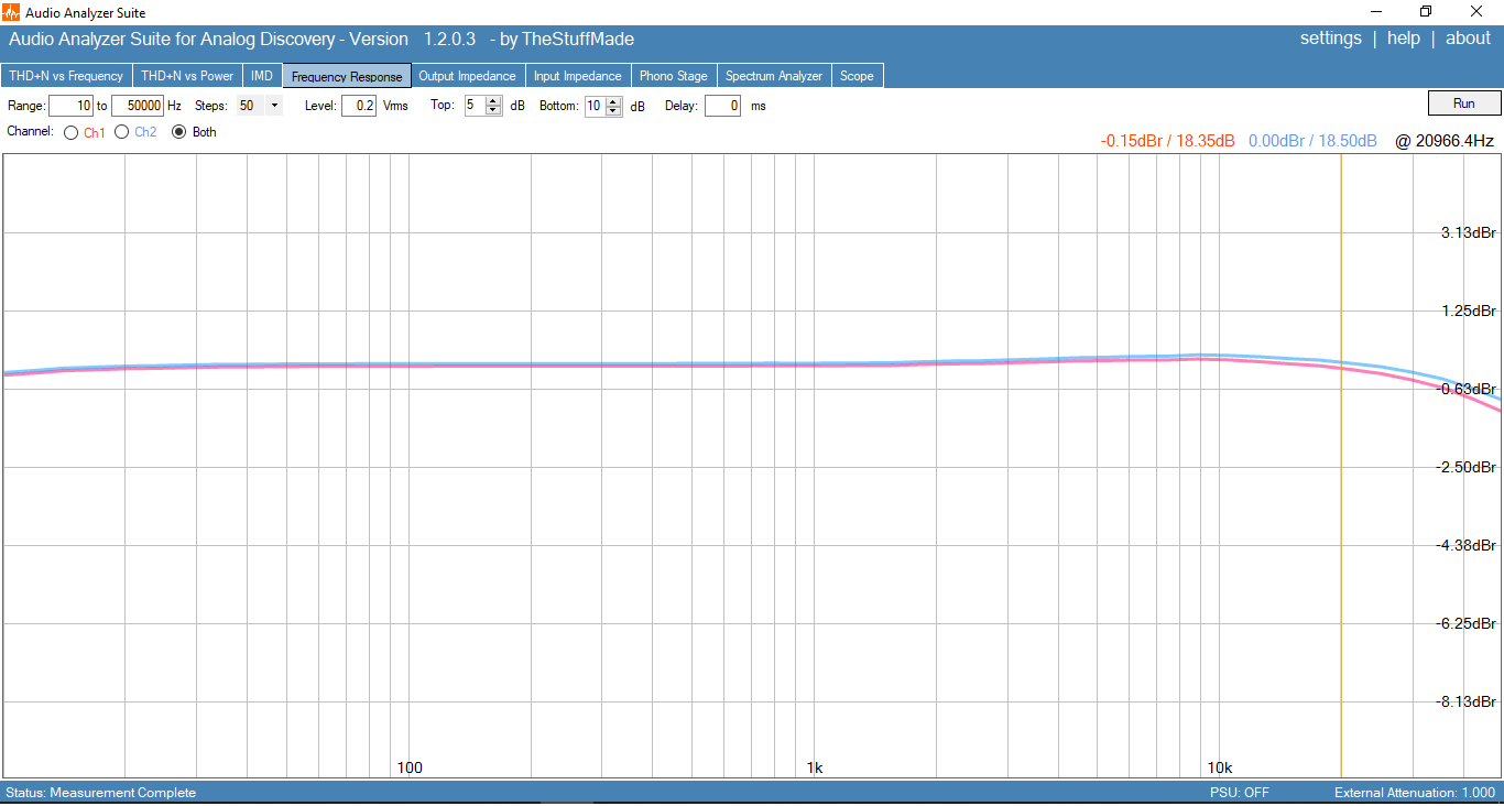

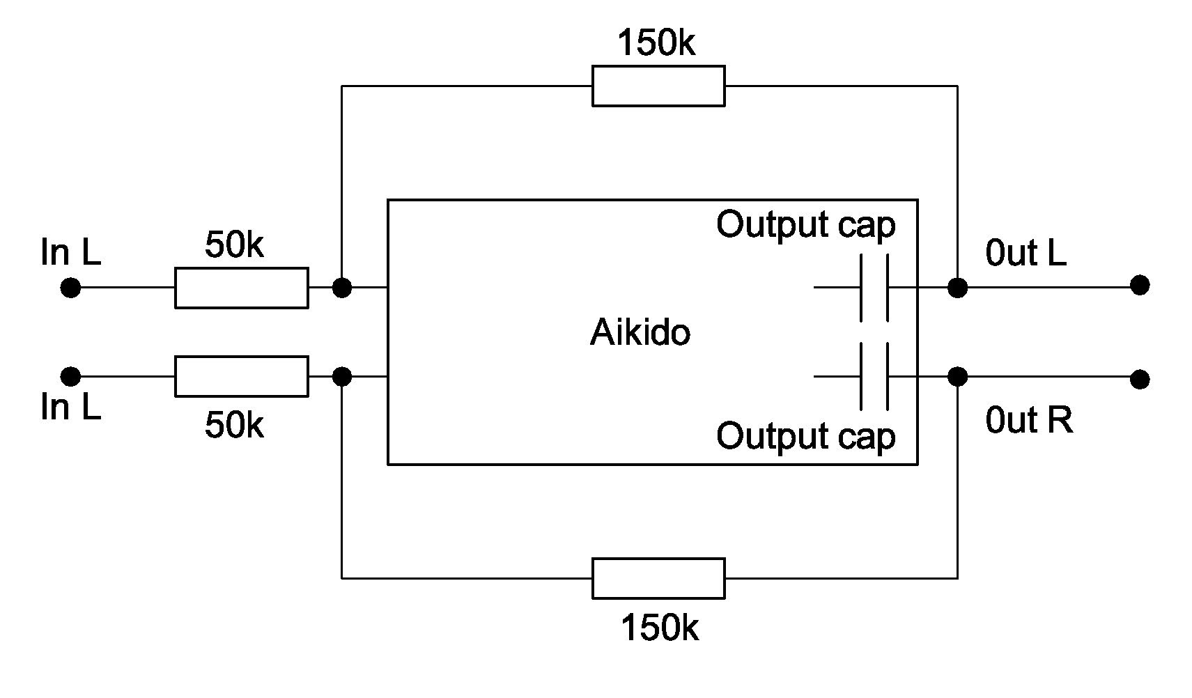

In my case, this is how it was done with the NFB. The amplification is now about 2.5x (8dB) and it was 18x (25dB) with 5670/6CC42 tubes. Checked with an oscilloscope and everything is stable, no oscillation. The sound is better than without NFB, cleaner and faster, with more details. The frequency range is wider, before it was around 200kHz -3db, now it is around 500kHz -3db. And the output impedance is probably lower, I just didn't measure it. Only the input impedance is lower now, around 35k, that is inevitable.
