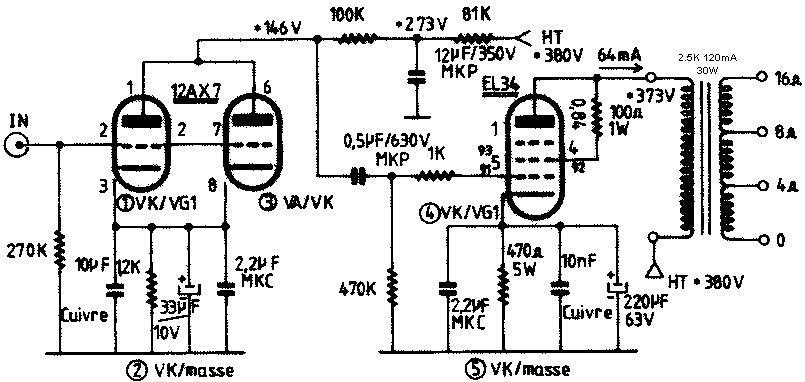

anyways, if you end up not using the 6f5gt, I would suggest a 6SL7gt with the triodes in parallel like this one.
if you end up using the 6f5 I would go two, possibly three triodes in parallel to lower the tube's impedance characteristics
