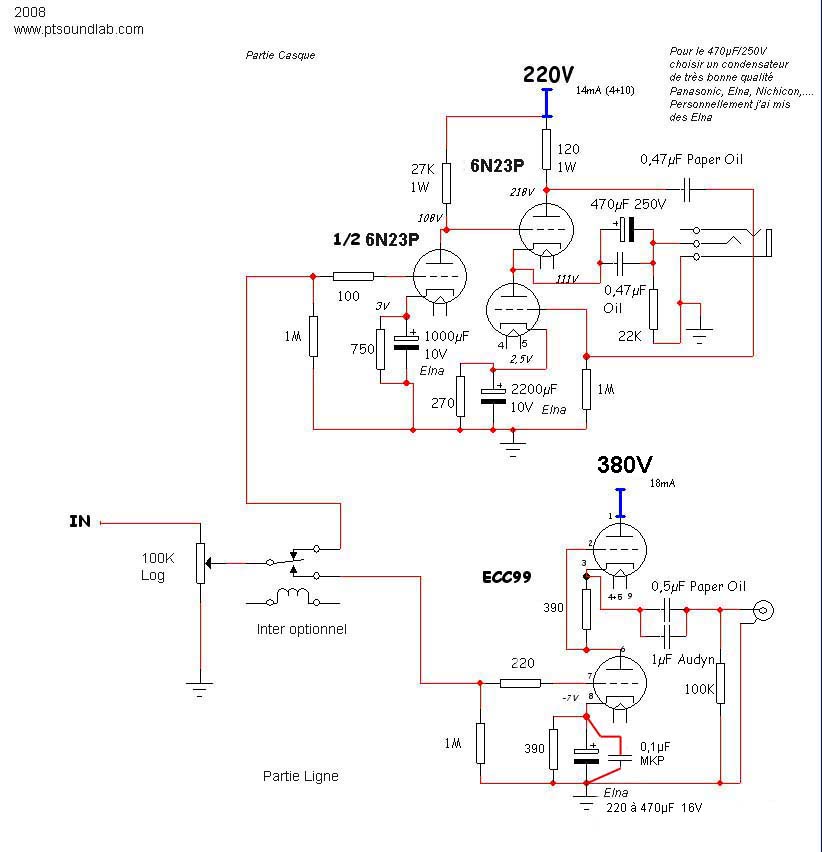

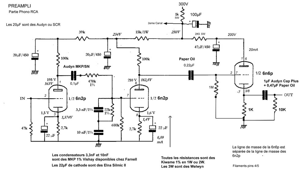

I am building up a phono/line/hearphones preamplifier based on the ptsoundlab schematics.
I putted the schematics as an attachment.
It took me time to purchase all the right parts and I am already there.
Regarding resistors, i am thinking about Kiwame, and i am wondering which wattage to choose for the resitors with no indication on the schematics...
My gess is : Is it possible to fit 2 watt resistor for all the resistors ? I beleive I can put some 5 watts everywhere but the price would be much higher...

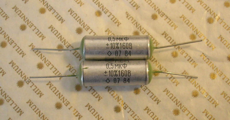

Here is again the schematics of the Stage Line.
You'll notice, on the ECC99 zone, there is a 0,5uf paperoil capacitor with no voltage indication.
I bought this product (see attachment): 0,5uf, 160v PIO.
Would you say this high voltage could cause any problem ?
