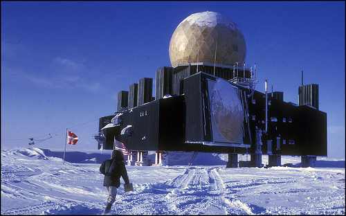

Dang, and I used to work with the US 4684th ABGp in Sondrestrom, Greenland supporting the Dye-2 DEW Icecap station. (1976~79)
Can't say I ever saw the 6204 at Base-Supply. I would have remembered the nice pale-blue color :)
