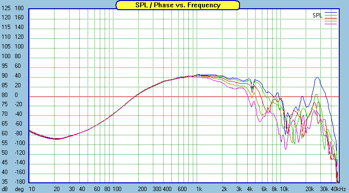

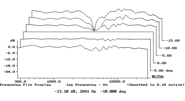

Actually I was surprised how well Tekton measured. I would have put the hex tighter. Sad that Stereophile doesn't publish distortion measurements.
Vertical shows extreme angles, up to 15¤ is ok, better than many 2-ways. Anyway perhaps woofers must play too high up.
Allen B : As Juhazi points out, it's' the vertical plot that reminds me of Dr. D'Appolito moving to use higher order filters and the rational behind his choices.
That's pretty awful, but from a practical perspective, owners have been quite happy with it and haven't noticed.
I read the comment: ["The closer I sat to the speakers, the less focused the aural images were;"]. This leads me to believe that either the baffle edge contribution, or the vertical polar response (fig.5) is troublesome.
Then I read this: ["Getting the Impact Monitors to focus their best required placing them closer together than I ever could have imagined would work—the centers of their central tweeters were only 5.6' apart"]...
So I was inclined to question the horizontal smoothness. On the polar there is a flawed region between 3k and 6kHz. Could be Patrick is right in suggesting a lobing issue?

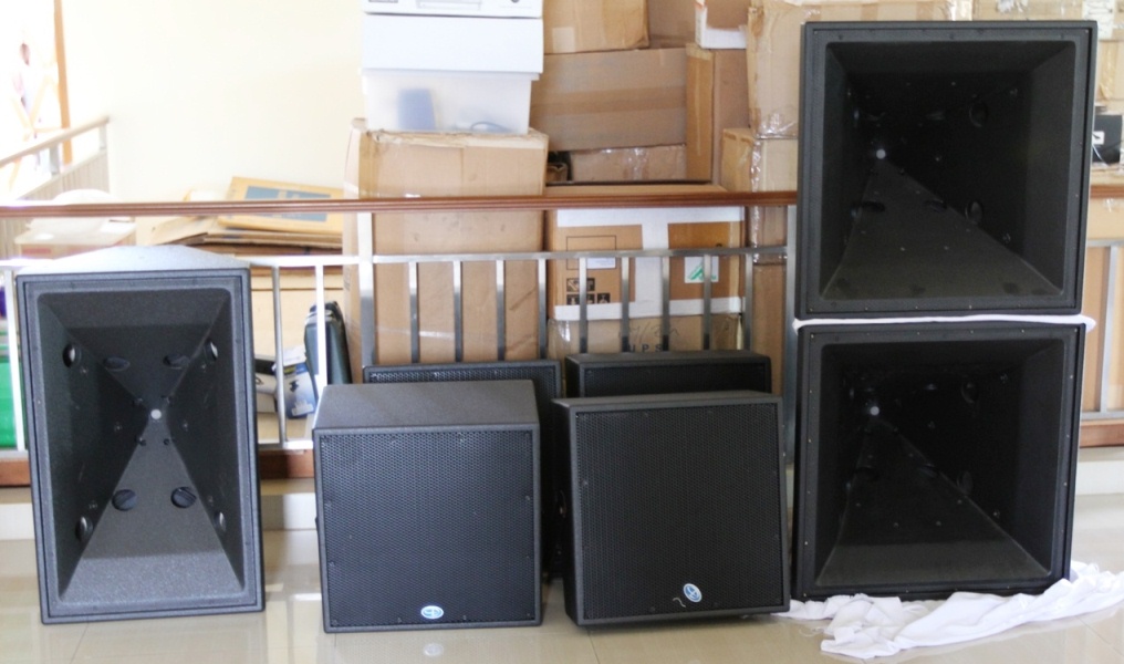

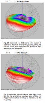

The CBT loudspeakers control directivity in one axis: the Y axis.
image.php
Horns like the SH50 control directivity in two dimensions : horizontally and vertically.
Basically, the wavefront of the CBT is uncontrolled in the horizontal axis. I'm not trashing the CBT at all; I think that wide horizontal directivity is A Good Thing. But the CBT and the SH50 sound noticeably different. I believe a big part of this is that the SH50 has a beamwidth that's consistent in the horizontal and vertical axis. The CBT only has narrow beamwidth in the vertical axis. It would be possible to make a two-dimensional CBT, but no has tried it... unless you consider the Tekton array to be a CBT.
Keele has not constructed or at least not published a speaker with a cross of circularline arrays. In the papers available on his site, all are just vertical arrays and he has studied their lateral and vertical dispersion. It is controversial if a 180¤ wide lateral radiation is good in a room.
Seems like most people forget, that studies and first implementations were for Pa, auditoriums and arenas etc. large spaces.
Real-world measurements however tell that lateral response is not symmetrical if mid and tweeter lines have separation. This is from paper #4, proto with small fullrange drivers
