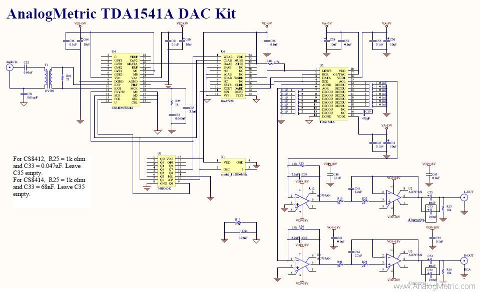

I have just built the analogmetric tda1541a dac kit...but I am not sure what type of clocking it uses, ie re-clocking, synchronous, etc.I would like to add a discrete clock as I have a surplus lc audio clock 2 (45mhz ) and was going to change the crystal on it to 11.296mhz.

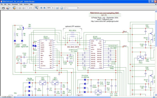

I2S has a bit clock. So the data is clocked in on that, and samples are presented on the WS signal.
A 'clock' as you put it in the normal sense usually refers to the master clock, which runs at something like 11 or 16 MHz. You need this to drive the decoder or digital filter, but not this DAC.
The resistors are used to reduce the current going into the DAC to reduce distortion. A LPF is apparently better still (I haven't tried). If you search for a thread called 'tda1541 info', you'll find a lot of info on that there.
Reclocking can be used to square up the I2S lines, basically using a bank of flip flops and a master clock to clock the data into the flip flops. The idea is to reduce jitter induced by previous stages by reclocking to a low jitter clock.
DEM reclocking: The TDA1541A uses Dynamic Element Matching (DEM) which uses an oscillator to switch between different internal current sources. DEM reclocking replaces the oscillator signal with one derived from an assumed better clock. Again more in that thread on this.

not working
I removed the 74hc4040 chip and cyrstal ( schematic is on the first post here ) from the board and then operated as per philpoole's schematic...but no sound at all...but ok when I went back to my original setup.
I checked all connections from cs8414 to tda1541 dac and all seemed ok...does it matter that the reciever is not cs8412 as in philpoole's shematic ?
any tips what I should look for?.

No, there are not for "reducing the current". It's on digital side, current it is only ON or OFF. There are there for reducing the front of the signal. Signals with fast fronts can put out ridiculous edge rates which can cause EMI and couple to other traces, they can stress your power supply, they can cause ringing on traces that can make chips do weird things, you name it. Especially if are long traces and if there are going to a slower device (like the old TDA 1541).philpoole said:The resistors are used to reduce the current going into the DAC to reduce distortion. A LPF is apparently better still (I haven't tried).
Thanks for the correction. However, from what I recall from the TDA1541 info thread (link below), a Philips engineer from the time mentioned this and its affect on the chip's substrate, and how also the voltage levels could be adjusted to improve matters, as well as an actual LPF.

I see that there is the same opinion: "Not faster than 10 to 30nsec rise time. This rise time is already faster than required is the ft of the pnp is taken in acount. A lateral pnp is in this process not faster than 10MHz, a vertical pnp slightly faster."
The current in itself I don't think it is a problem, the chip is calculated for the TTL signals after all. But the ultra fast rise time it is what it was not taken into account at the time when this DAC was designed. CS has nice fronts for the modern circuits and for 96kHz Fs, but for this particular case it is different.

Sorry....I should have said as supplied by philpoole.That wasn't my schematic!

Bugger! ( another mistake )...hotiron supplied the schematic.....sorry bout that philpoole !But I didn't post the schematic either!

if you want try your dac without reclocking (HC4040 and XO removed) you have to change the 8414 from mode 3 (M0=1, M1=1, M2=0, M3=0) to mode 2 (M0=0, M1=1, M2=0, M3=0).
In mode 3 FSYNC and SCK are input (generated from XO and HC4040), in mode 2 are output generated internally with the clock recoverd via pll from spdif input.
As always it's all in the datasheet.
