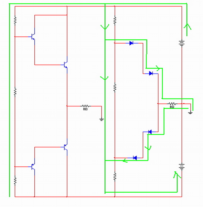

Positive or negative is referenced by the output line that is zero volts...it gonna be connected through the speaker into the ground...speaker is 8 or 4 ohms... a low impedance to ground...output line is almost ground...it is zero volts.
How we have positive and negative?
Observe a emitter follower output (Dx amplifiers use emitter follower output)..observe there are junctions of base to emitter that are diodes.... two transistors represents two diodes in series...each diode has a voltage drop of 0.6 volts aprox.... so.... the two transistors you have upper the output line are posive...and the others goes negative referenced by the output line that is "almost" ground.
What "decides" were gonna be positive and were gonna be negative are these diodes because connected to the output line that is "almost" ground.
Transistor junctions have their limits..you cannot plug high voltage with the hope the junctions control the stuff... junctions overheat and goes shorted if you do that.... because of that we plug a resistor conducting a controled current inter connecting these diodes (base to emitter junctions).
