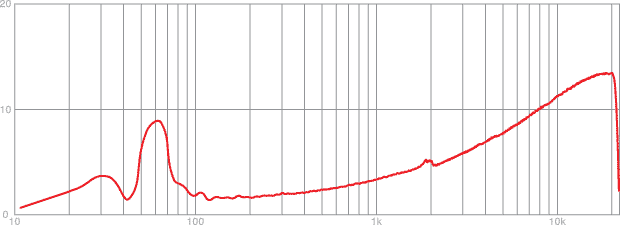

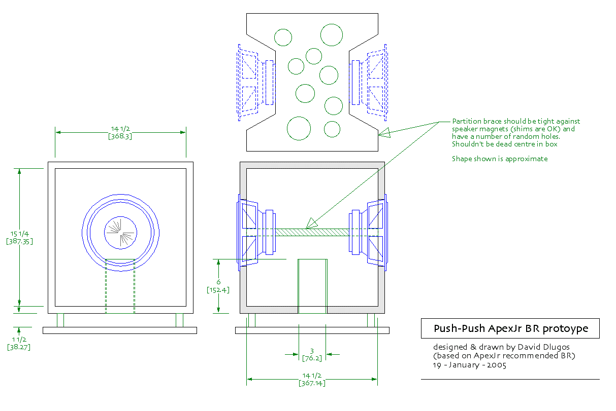

I was frustrated getting reasonable results out of the MJK worksheets (i will revist that at some point) so we went ahead and threw together a push-push bass reflex based on the Super 8 4th order on Steve's site.
All i can measure is the impedance curve -- but i'm sure to someone more familiar with BR the shape of those 2 humps tell a lot... any suggestions on optimizing the tuning?

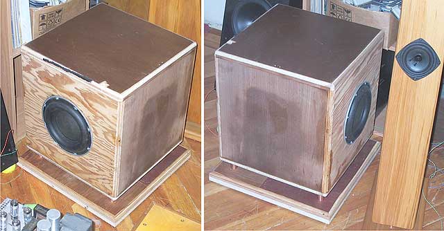

And what it actually looks like -- only the finest scraps were used...including recycled venerred particle board from some old speaker, 40-yr old plywood, the top from a console hifi, and part of a rejected table top with inlaid marquetry (currently the back of the speaker (i think i'll move the terminals to the face you see).

I think these speakers have potential... currently hooked up as an HT woofer only using the XO out of the decoder, each driver driven by a channel of a Don Stenton Signature SS amp (50W/channel).
Starting to break them in -- Frank Zappa's Baby Snakes DVD on ATM.
Once i remove the base i'll play a bit with port stuffing (i'm much more comfortable with aperiodic).
The HT Processor doesn't have enuff adjustment to turn them down enuff... i'll be breadboarding up some XOs to see what we can do to improve on that.

Hmm, I can see why Chris never lets you loose on the woodwork! :)
Well, it looks like you nailed the alignment fairly well, the well smoothed first peak being very indicative of the higher order alignment. The second peak is a little wide, but that is probably due to slight differences in the drivers blurring the curve.
Is that impedance curve calibrated, or just relative?
That looks very like a good HT sub for the money, I would be a bit wary using it as a music sub, though, the group delay is "interesting", though I have seen worse.
calibrated. I'm using Fuzzmeasure for OS X.

Fine Woodworking?
Sooooo, you decided to show off some of my fine woodworking. I must say you got the photo from a good angle. I am glad it is just a prototype. Maybe a can of black paint will bring the best out of that fine looking box I made? All in all it was an hour or two well spent. Besides I was just going to burn the wood anyway.
I am sure you will figure out how to make sound better than it looks. Then we can show off a nicer cabinet.

Well I never did get to hear them. I guess they must have potential or you would not be wasting time on them. Once we get a design worked out I can make up a real nice cabinet. I have a few furniture integration ideas that might be interesting. How about a set of short leg end tables.

Still in progress... i stuffed a handfull of poly into the port, and have been enjoying them in my HT.
Found out what was screwing up my MJK sims and will revist the TL for these (gotta do an extremis 1st thou)
