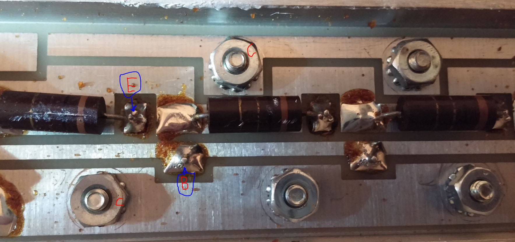

perhaps I have found the problem
hi Zen perhaps I have found the problem

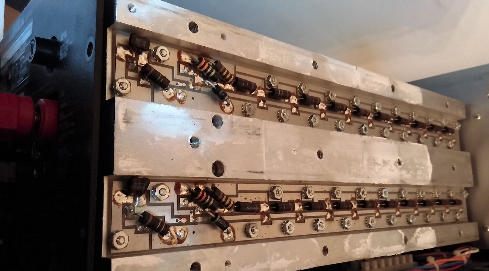

i have dismount the output stage to check all 22 power transistor
and if i test whit the test in posistion test diode between the pont incicated B and EIi see an short circuit also if i change + and - tester tip, see folloging picture:
attachment.php
B shold be the base of transistor and
E shold be the emitter of transistor
but betwhen b end e i see an short
si i think the transitor is damaged confirm my idea ?
or i make an error ?

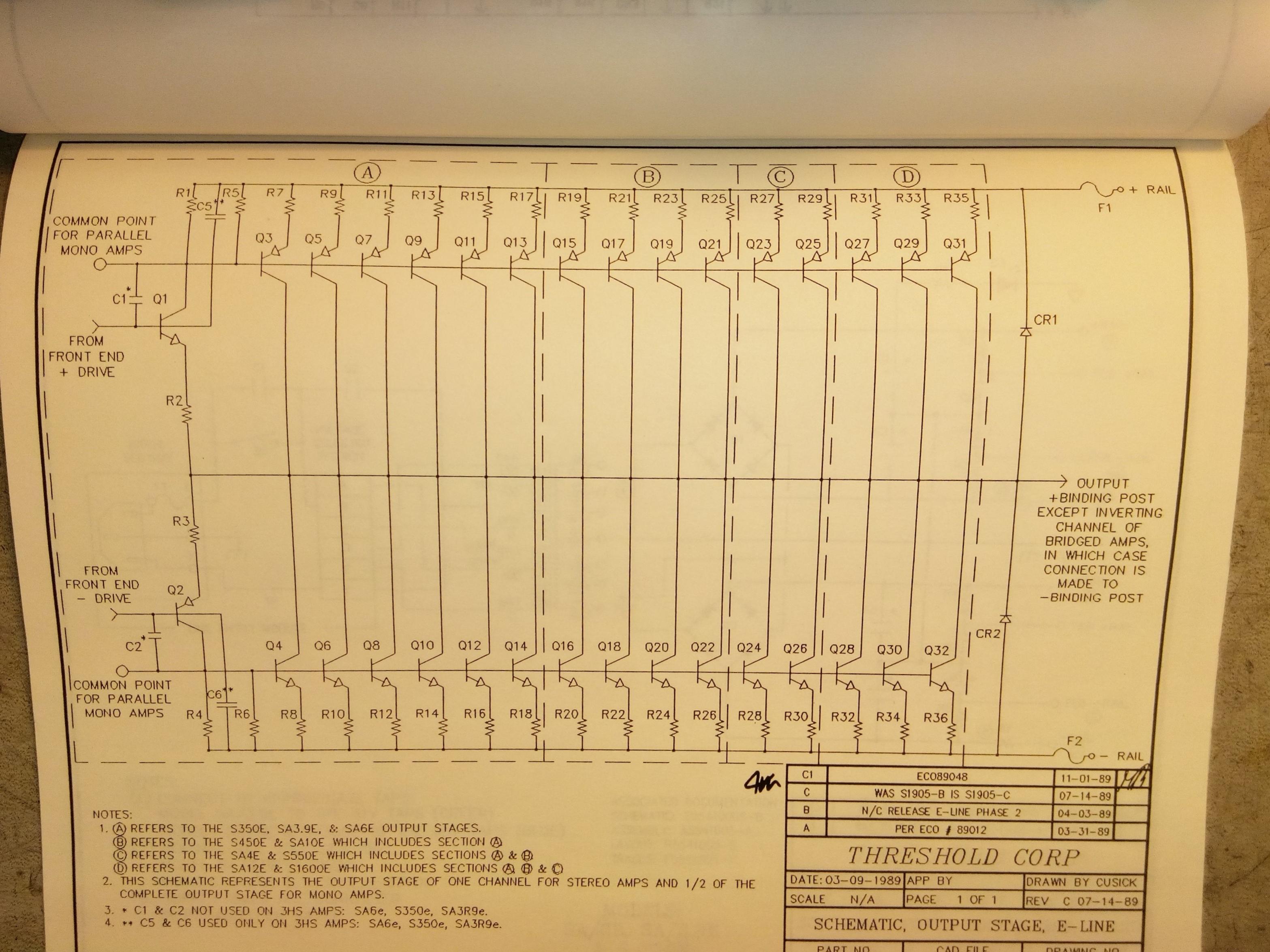

so it is true for all 20 thansistors indicated in the schemaindicated
q4 q6 q8 q10 q12 q14 q16 q18 q20 q22
and
q3 q5 q7 q9 q11 q13 q15 q17 q19 q21

Official Court Jester
Joined 2003
all upper ones are in parallel , same as all lower ones
so , you can't be sure which one is shorted , without unmounting them from pcb
in fact , for B-E and C-E measurement you can , desoldering emiter resistor of transistor you're measuring , but for B-C measurement , you need to pull out one by one
