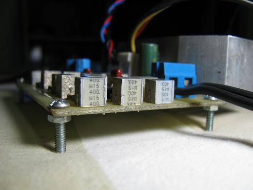

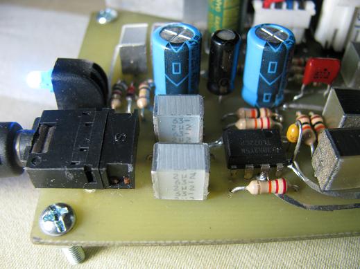

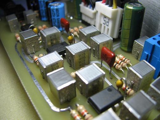

I got a bunch of these caps and wanted to know what dielectric they are. searching the net made me think it's PPS? but not entirely sure.
Anyone know what they are exactly? (the grey square ones with no plastic encapsulant)

I have some that look like that which are polyester. Very unlikely to be PPS. If you want to sacrifice one, cut out a few pieces of film, ignite them with a cigarette lighter and cautiously sniff. If they go right up, they're definitely not PPS. A sort of sweet smell is characteristic of polyester. A burning candle smell means polypropylene.

That are Siemens MKT (polyester) capacitors. Open construction but good sounding. The older ones with greenish sides are MKC (polycarbonate) and those were somewhat better.
One drawback of the open construction is dirt/moisture sensitivy and lead wires that can come off when mechanically treated too rough. They were popular as values could easily be changed by sanding off some material on the upper side. I would not do that but it is possible.
