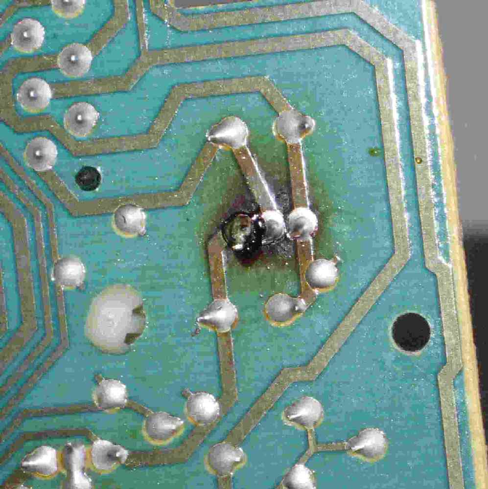

I had a case of DC-offset at the output OP which was cured by resoldering bad joints at the voltage regulators. Still the upper board was sensitive to knocking, toggling sound on and off. I resoldered the pins of the small board that is stacked over the DAC chip at the left corner (seen from the front) and the unit played well again. I would not discard a PCM II.

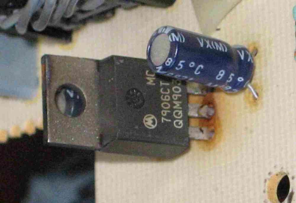

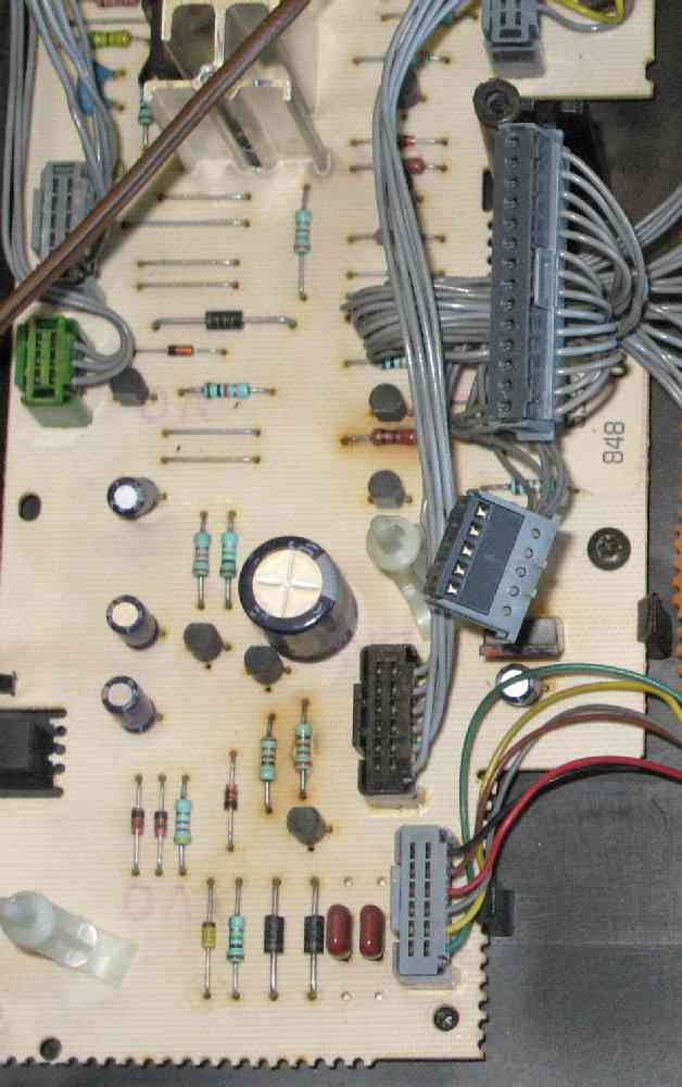

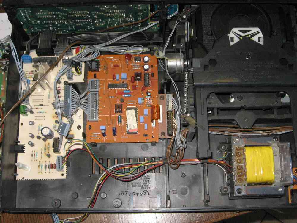

I have probably fix the error without service manual. After switch-on the cd player is dead, but screen (VFD display) looks like a blinking christmas three illumination.
The pos. rail of 5VDC provide only 3V5.
Because the input voltage of the associated voltage regulator was above 9V, I suspected the 5V regulator itself as the part causing the error but no changing the situation after replace by a new part.
After temporarily cutting of numerous conductor tracks I note after disconnect both the operating processor board and the Philips processor IC MAB8461P-W127 itself - go to
https://www.diyaudio.com/community/threads/wtb-mab8461p-w127-mission-pcmii-controller.121935/ that supply voltage on the mentioned regulator rises up to 5V.
I note a resistance of 120R between the supply pins of this processor (that means idle current of approximately 40mA) and I guess, this IC must be replace.

image No 3 show this processor-IC after zoom - it is the MAB8441P-T054.I have a PCM7000, I can watch this weekend if you want.
