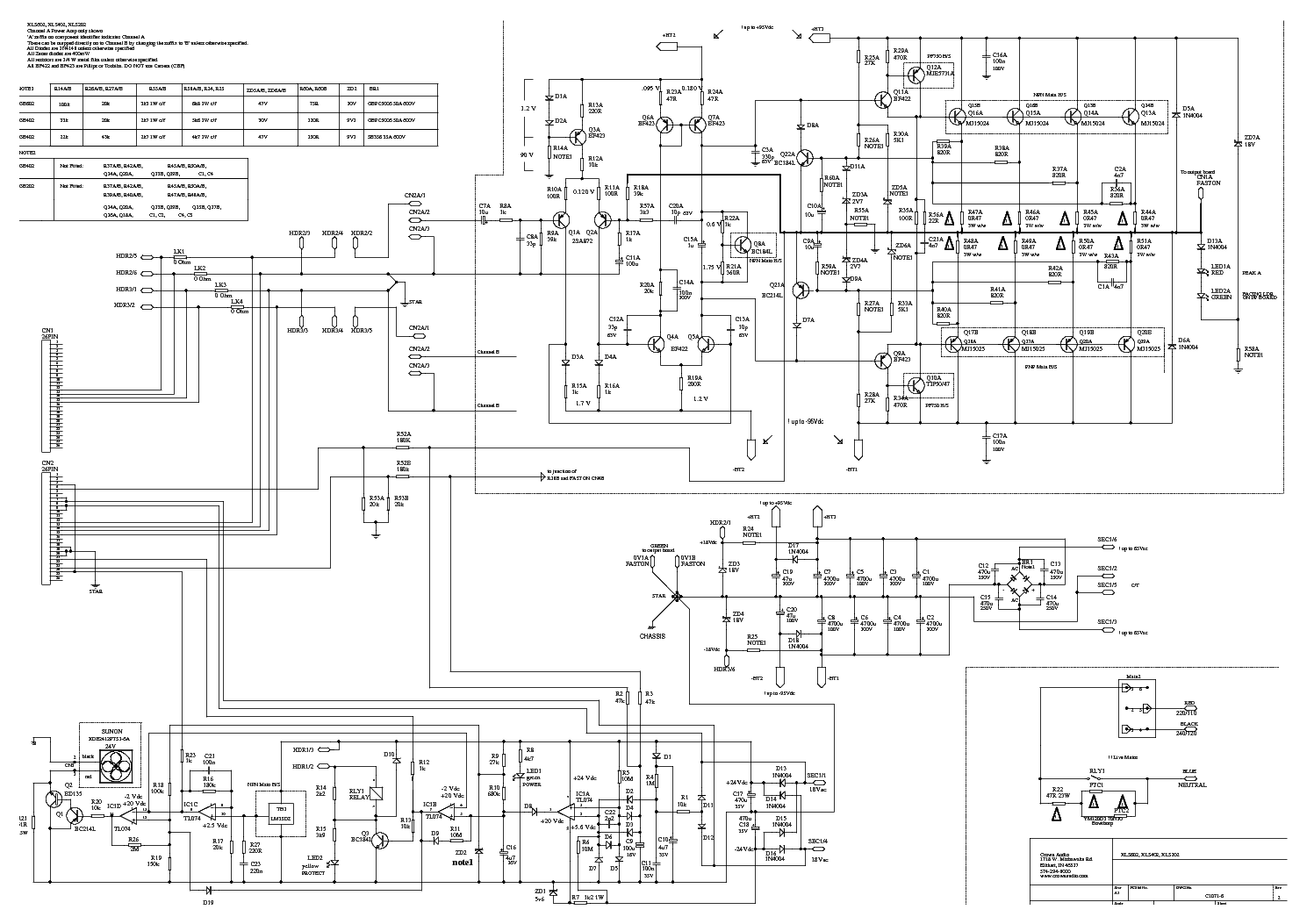

Help to fix C-Audio GB402 Amplifier

The C-Audio GB402 is similar to Crown XLS-402. And this schematic is attached.

I looked at the schematic in the above post and it is as I expected. The amplifier uses the same input, second stage and pre-driver circuit but a slightly revised driver stage as the output devices have been changed from those on earlier models and a revised protection circuit. The schematic gives you the expected voltage drops across each resistor in the whole driver circuit which will help fault detection.

Hi Sajti ,
Thank You for your 402 schematic attachment . I am not realising that the Crown XLS-402 is the same with GB402. Unfortunately the attachment as ".png" it is not
very clear. Please can you send me a PM, as a pdf ?.

pdf version attached.

From experience. when these blow, just pull all active devices and replace them. replace the speaker relays too. you will most likely find a large % of bad/blown devices and I wouldn't trust whats left. the small transistors are not expensive so why risk it? the speaker relays are pretty crappy, when an output device fails, the relay overheats and the internal contacts bend and warp and short out.
a really cheap crappy design IMHO
Hi
It is normally a good idea to replace all cheap transistors but the problem with replacing all the small transistors is that non of the input stage, second stage or pre driver stage transistors are available now. You can use replacements but they will all have higher capacitance.
I would therefore try running the amp on a low voltage and try to see where any problems are.
When I repair a C Audio amp I replace the soft start circuit fuse with a 100w light buld connected accross the fuse holder and start the amp that way. This way the amp runs at about half voltage and if there are any large current draws from the amp most of the mains current will go to the 100w lamp which will glow brightly. When all faults are repaired the light bulb becomes dim.
Don
Hi to all of you,
Problem solved with your help.
R14 on Q3 base it was cut but with no visible site of damage, and
C9 on protection circuit it was dead.
