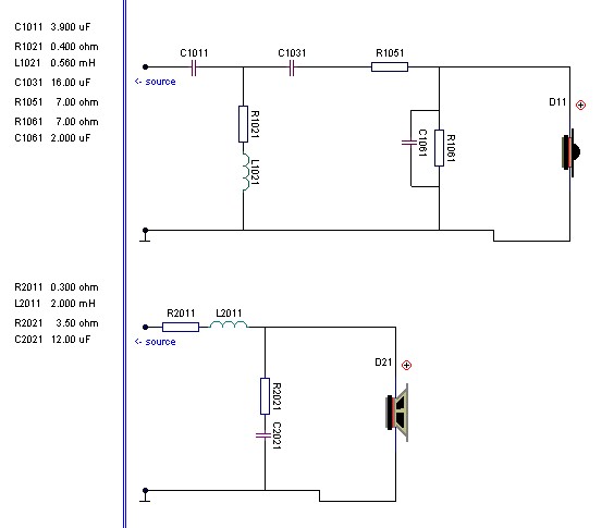

Just looking at some different schematics online of Xovers, I have noted several that have this type of resistor / coil sequence
Is the resistor seperate or a inclusive of the coils resistance (DCR)?
Thanks for the help,
Ron

Nigel Goodwin said:
It's separate, you don't show components internal resistance separately like that. The resistors in series are to alter the response of the crossover/speaker combination.
Sorry to call you out like this, but I think you are wrong. I've seen plenty of crossover schematics where the DCR of an inductor is shown as a separate resistor in the crossover schematic. The easiest way for me to tell is to look at the DCR value in context. If the DCR value is small (usually less than an ohm) and matches about what the DCR for an average gauge inductor of the given value would be it is probably not a separate resistor.
IIRC, you are not supposed to put a resistor in the schematic, it is supposed to be spec'd out below the inductance value. However this is just a convention and as long as you put a note on the sheet it is valid.
I would agree that the determining factor is the magnitude of the resistance in series with the inductor, if you look at the table of values you will notice they are .2-.3 ohms which is typical of an inductor. This method assumes the person viewing the schematic has the basic knowledge of inductors to draw the conclusion about DCR versus series resistor.
BTW, go easy with definite statements like "you are wrong" especially if you are going to follow it up with "I've seen plenty of..." this is anecdotal evidence and does not mean that the schematics were done properly.
-J

It is as I suspected......(after closing up the speaker Boxes) DOH!!! the resistor value is in reference to DCR of the Inductor.

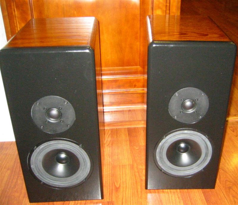

I suppose surgery is needed to remove the extra resistance, but other than being padded down in volume they sure sounded great for the $$$ invested.
Seas P17RC & Seas 27TFFC in a 19.5 liter cabinet.
Thank you all for your input, and for helping those of us who are not professionally educated in electronics.

Have seen a site where the schematics were drawn with the same software as this one, and the poster explained that the resistors were added to simulate the inductor's DCR.
Doesn't matter anyway, they can be assumed to be necessary resistances and the inductor DCR can safely be deducted in any case.
I wouldn't worry about any left over tiny fractions of an ohm :)

To me it seems as if the resistors in series with the coil represents the DC resistance of the coil. Their values seem reasonable for coils of those inductances. They are probably drawn in the schematic because that it is the only way to simulate the DCR in this particular simulator.

Has no one as yet mentioned R2021? - this might or might not be a real resistance. The value of 3.5 ohms is far too high to represent the typical esr of even the worst bipolar electrolytic so it is likely to be part of the x-o design..
I usually mark my dcr/esr sim resistors as such and would encourage others to do the same?
Hmmm.........
R2021 is obviously a real resistor. The others are inductor DCRs but
the point is they do not have to be - they are the values used in the
simulator and could be somewhat pointlessly made up from lower
DCR inductors and real resistors, common sense indicates that they
are ballpark inductor DCR values.

You are correct R2021 @3.5Ohms is too high for a DCR property of a Cap. It is indeed a component in the Xover. I do not think it is a property of the -)l cap, but the other Rs next to inductors are the inductor DCR.
A poor way to lay out a schematic if you ask me. There were no footnotes to explain the mysteriously small resistance(s).
That was my purpose of this thread. I know I am not the only one to see Xovers like this example. Now I know how to read them.
