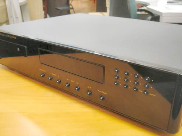

Here you go guys, that earthed copper box does`nt house the d/a convertor as i thought, but it`s some sort of interstage transformer it has 3pin input and 3 pin output potted. The shielded cable comes from the small re-clocking /line condioning board to the input of that interstage transformer, the output of the interstage goes the the tubes. I finaly found the d/a chips, they were well hidden under the main board, and the numbers on them are YDG-101f and the other is GDR-101.
Can anyone shed anymore light on this, essecially the interstage trannie?
Cheers George

I had a look at the pics. They sure look like ECC88s to me.
Here's what you can do to make absolutely sure:
Check the valve stem (were the pin base is welded to the bulb) for acid marking.
If the tube is made in Europe, the base should have such a marking: usually two lines of three to four characters and figures combined.
Cheers,;)
What Tubes are On The Musical Fidelity Limited Edition CD Player
My Technician MR: Peter Gay Suspects That They are ECC88 on The TUBE C D Player, and he has been Working on Tube Amps for over 50 Years, I guess he Might be Right,:cool:
