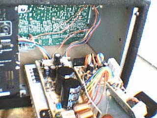

hello guys,
I am currently servicing a Phonic Powerpod 7 unfortunately the technician from the other shop who serviced this mixer/amp the last time erase the part # on the power modules/ic's.:( I emailed phonic corp. and they told me that they do not provide schematics for their products (gee, talk about technical support:whazzat: ) seems that they are only interested in selling their products. I tried googling and digging for info but none avail. I tried powdering the power ic with graphite to see if I could lift out some markings (ala CSI) but none is left. The power modules where the STK, STR,STV type I guess. Please help me identify the power modules. Thanks a lot.

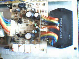

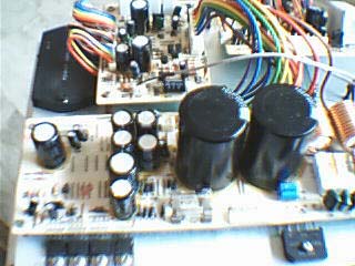

hello anatech, zeonrider,
The power modules is at fault, there is a large dc voltage on their output. I've measured the supply voltage directly on pins of the power module. +50V on pin# 14, -50V on pin#12 reference to Ground which is pin# 3
hello destroyerX, zeonrider
Glad you love those images sir. zeonrider, that is my guess too, an STK powermodule. Anyway I got some clues from the amp board; the power module is a mono amplifier 100W into 8 ohms, runs on a +/-50 power supply, pin #14 is the +Vcc, pin #12 is the -Vee, pin #3 is the Gnd, 4 external .33 ohms Re resistors connected to pin #13,17,16 and pin #18 connected to the speaker buss. I'll try to cross reference it to STK's amp diagrams to see if I could find a match. Don't worry I'll still be a loyal Phonic user. Look at my rack:D
