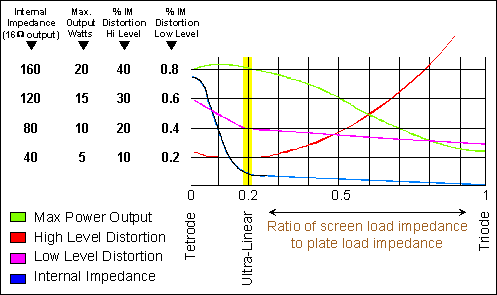

The optimal tap percentage in Ultralinear depends on the tube, the trnasformer impedance, and the design goal. In their patents and early papers, Hafler and Keroes showed some very interesting graphs which beautifully illustrate the tradeoffs.
To make a long story short, a 20-25% tap will give you higher power but higher distortion than a 43% tap.

Let me see if I can scan one of Hafler's charts and get it posted. "Fair use."
edit: here's a link to the relevant chart
http://www.tubecad.com/Classic_Articles/page4.html
