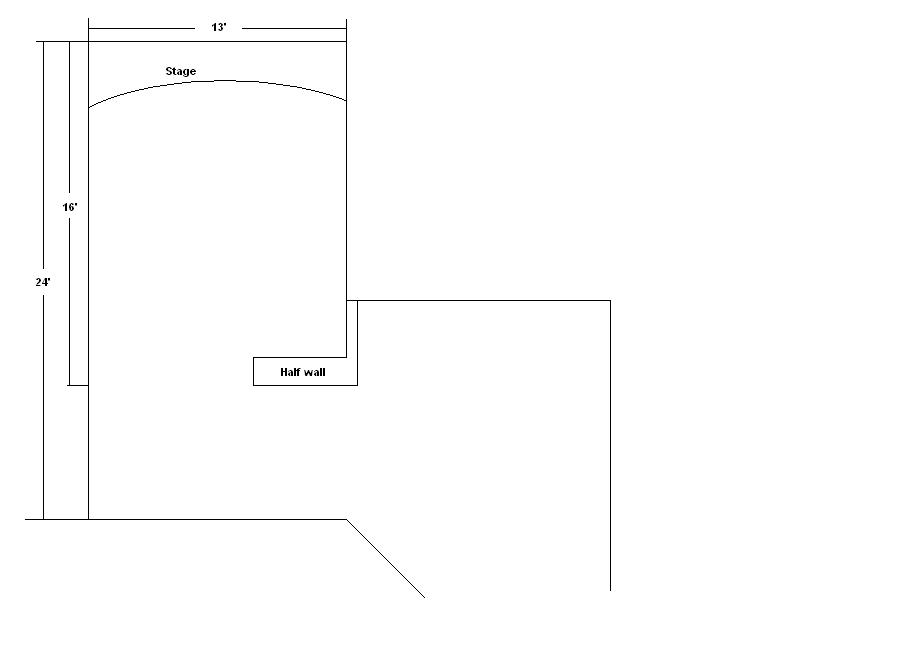

I've been looking around on the net for the last couple of weeks for a good (meaning affordable, decent SPL and quality) subwoofer driver and i've finally come to a conclusion; i have no idea which one to choose!
First off, my HT is in my basement (which i've been finishing) and occupies only part of the total space. The HT is not fully enclosed but has a half wall on one side and is open on the other (see attached pic for a very crude drawing). I've got about 400w x2 available (into 4ohms) and have been looking at a pair of 15" high excursion woofers (Titanic, Soundsplinter etc). At present i have a pair of 12" diy subs i built a several years ago which still sound OK considering the woofers used (Kicker Solobaric - yeah i know, but they were free at the time!), but i am pretty sure they will not have the grunt necessary to fill the HT with acceptable levels of quality bass.
So i've come here looking for help and advice. I'd like to stay with sealed cabinets (for sound quality and safety factor) and under 3 cubic feet per enclosure - and i guess i don't have to stay with 15" subs either - if 12" subs could do it, that would be OK.

A few thoughts -
There was a thread recently where GRollins (IIRC) said that his early long throw sub drivers exhibit a real world rising response, with a pretty big hump 80-100 Hz. This may or may not be true of current generation drivers, and Adire claims it is an artifact of the measurement technique in their Tempest white paper.
With most of the long throw drivers I have modeled, you'll need a bunch of EQ or a Linkwitz transform for deep bass in a sealed cabinet. Not necessarily a bad thing, just something to be aware of.
Zaph says that in his experience low xmax woofers sound better. He's talking woofers, not subs though. Applying this observation to subs makes sense to me. If you're only moving 1 mm, your distortion is likely to be lower than 15 mm, even with all the good stuff like XBL2 and Faraday rings and a 34mm xmax.
As you know, low frequencies require lots of displacement to reproduce at HT levels. If you are going to limit excursion to keep distorion low, then you're going to have to go to big drivers.
I am sure that there is some pride of ownership kicking in, but I have never heard a 12" sub that I have liked, and very few 15" subs do it for me in anything but the smallest room. My subs use the long out of production JBL2245H 18" pro sound driver. I have a pair in a room about the same size as your basement and 750W available for each. They are each in an 8 cubic foot ported cabinet tuned to 24 Hz, with a variable Q equalizer that allows flat in room response to 20Hz or so. I haven't heard anything that comes close to their impact and they are great for music, too.
So, without recommending any specific driver, my recommendation is to use the biggest drivers whose cabinets you can live with, and lots of them. Four 15" subs would not be too much in that room, and it gives you the opportunity to come close to the "optimum" placement that the Harman sub placement white paper recommends.
