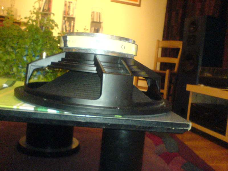

with A-shaped I mean that the cabinet is wider at the front than at the back (in this case the front is 200mm wide, while the backside is only 132mm wide). This has two effects, one positive and one negative.
The negative one is that there will be a pronounced peak of several dB at ~200-400Hz -depending on the cabinet´s size. As long as this peak is well above Your desired frequency range You can cope with that problem quite easy by electrical filtering (a simple lowpass might be sufficient, a notch might be needed)
The positive effect is that the drivers freeair resonance is lowered more than a simple OpenBaffle or a U-shaped cabinet would allow for.
The 16 drivers had a mean Fs value of >40Hz and a built in Fs of 34-35Hz, which I consider very alright for a 6.5" driver system. Too does this cabinet shape look more pleasing to my eyes.
Even though the drivers were quite cheap, they feature a nice stiff membrane and magnetical shielding and a really nice set of parameters for dipole use.

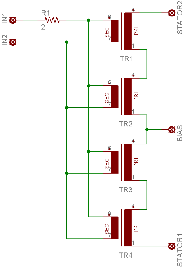

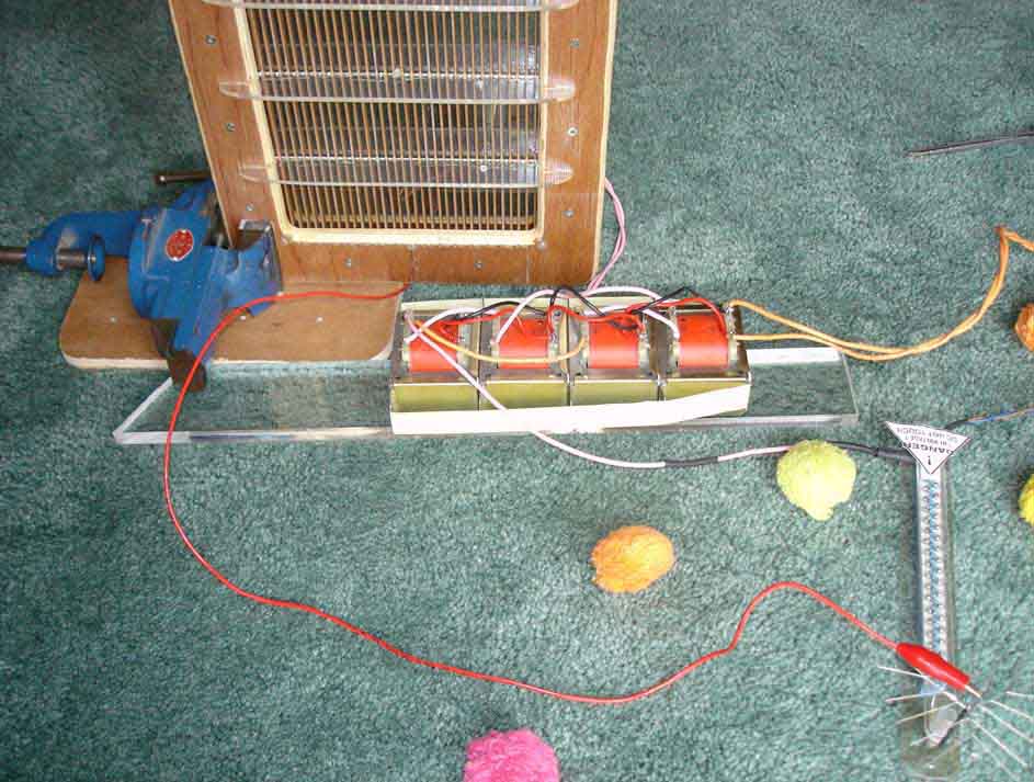

. hi
the 4 tranny setup does work pretty good .
toroids seem to me as more linear . with better bass
iron trannys sound thinner . these are not big diferences
i use 4 ohm in series to condition the load to the amp and dump transformer ringing .
adding more trannys same way stresses the insulation of the ending pair making them hiss and sound like music .
