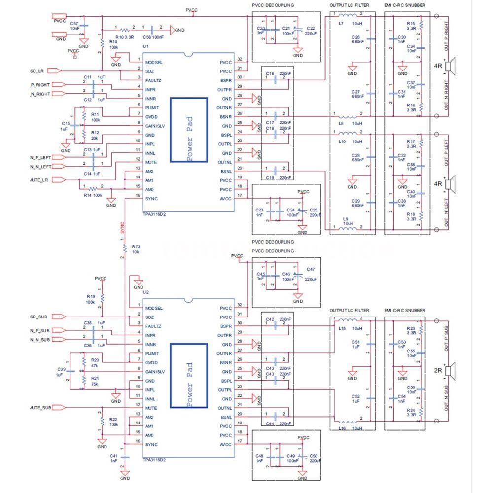

No. You will not install a pot there. See the attachment.
You have to access the circled resistors and change their values to obtain a higher gain.
With the values shown in the schematic you provided, the gain is 26dB.
You can go to 32dB or to 36dB

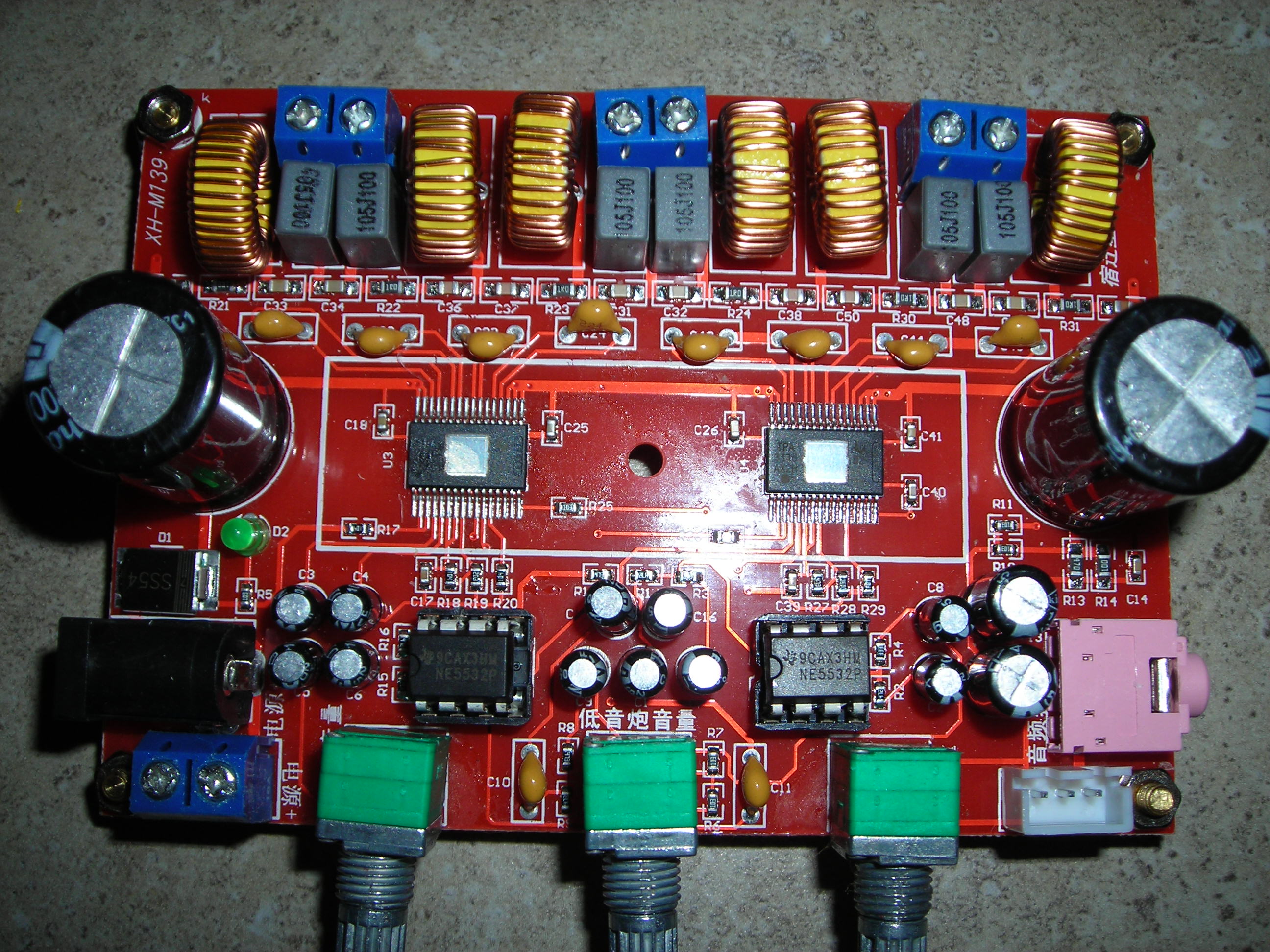

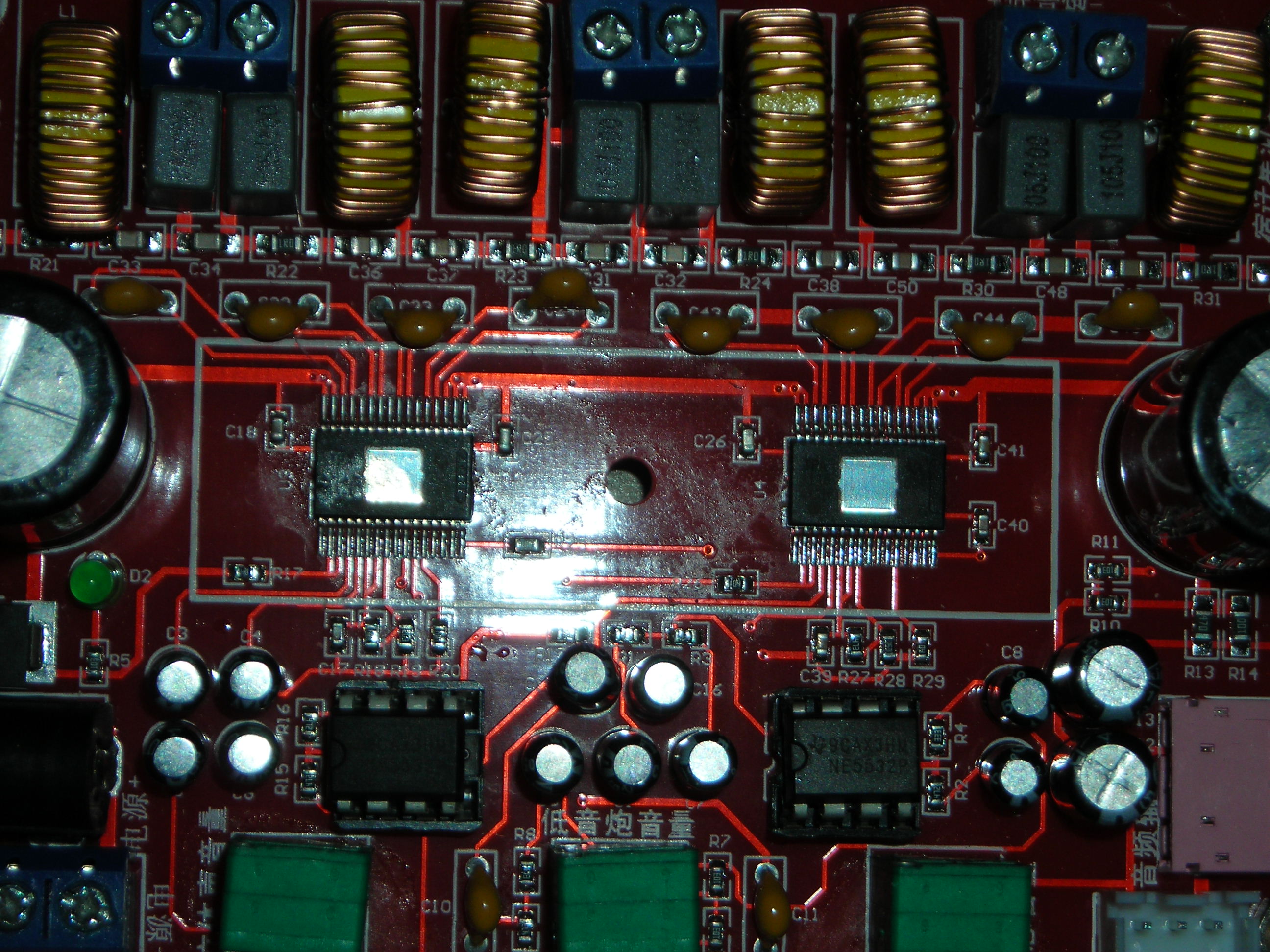

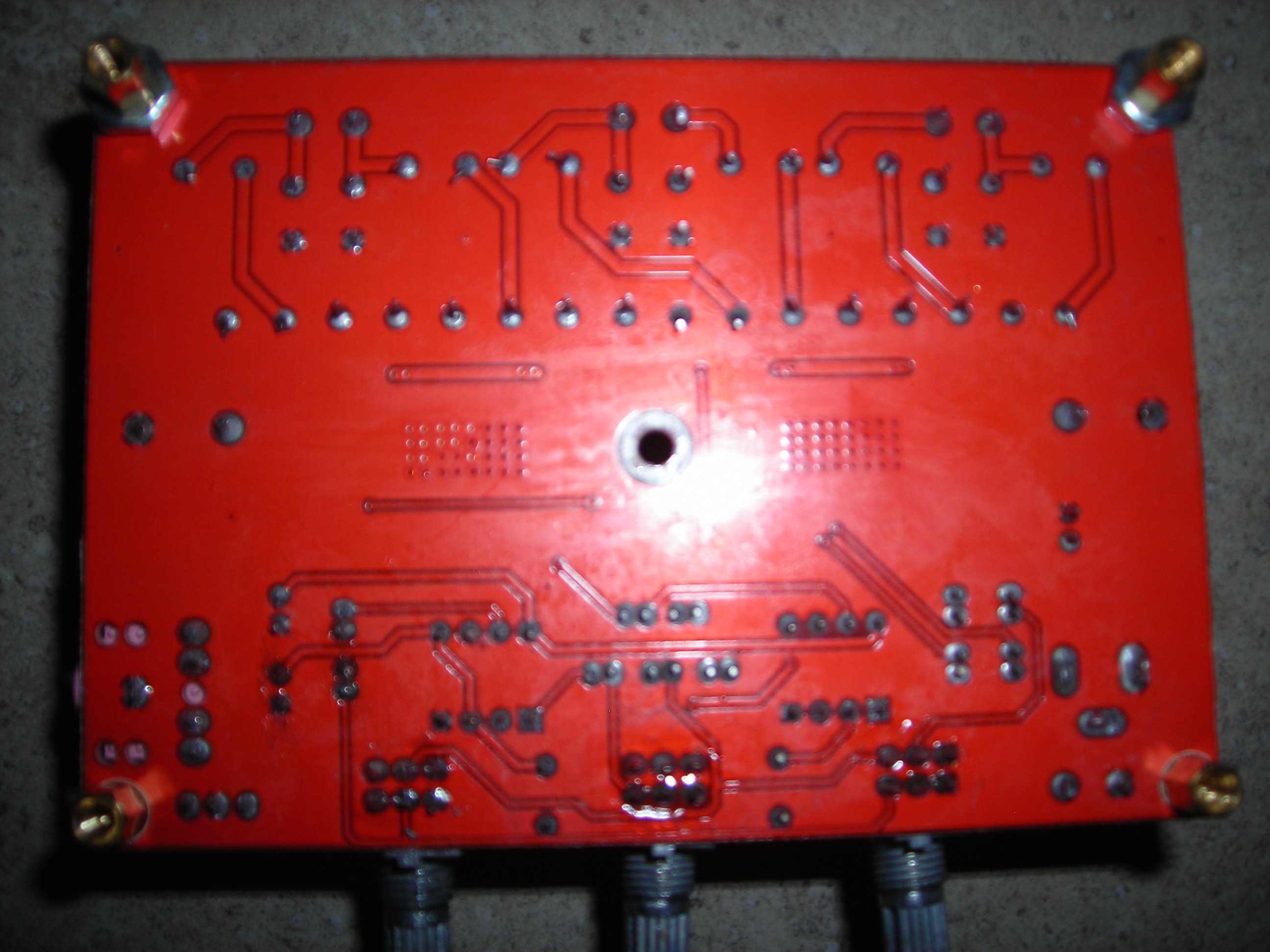

I think that if I can just change the resistors as mentioned it will work. The only thing is that it looks like it was soldered my machinery as the resistors are really small, and I don’t know if I can work on it, but I’m willing to give it a try.
I’m also enclosing some photos that I hope would help as suggested by “irribeo”.

Gainsetting indeed is standard (26dB) datasheet, stereo left right is master, bass is slave here. Standard datasheet r25/c40 values do not function, and resistor r25 is datasheet value, so likely c40 is too. Master is supposed to send signal to slave so that slave's switchingfrequency is equal to master's. Here slave does not receive signal from master, which most times means slave will switch at ~100kHz. Some report noise issues and distortion issues, maybe slave isn't stable at ~100kHz, I don't know, minimum switchingfrequency for the chip is supposed to be 400kHz, here master is operating at that frequency. For bassfrequencies it won't be a direct quality problem, however you might have some indirect problems, because the outputfilter hardly attenuates the 100kHz switchingresidu, there will be a very strong high frequency (100kHz +) noise signal on bass output. Better not connect a multiway speaker (with tweeter) to bass output.
Intended correct values for r25/c40 are 4k7/47pF, you could change those too or if you find it easier, remove r25 and set both amplifiers as masters, use identical resistor pairs for the gain/master/slavesetting r18/r19 , r27/r28

The TI data schematic may not be the same for my board as I tried measuring the resistance the following resistors on my board and it didn't match the resistance on the data sheet.
Actual measurements taken from my board.
R20=15K
R11=5K
R12=19K

If you are able to remove the tiny resistors without damaging them you could swap them, r27 with r19, r28 with r18, and end up with 36dB for left right and 36 (or 32) dB for bassoutput. Maybe 32dB for bassamp because datasheet gives 16k value for 36dB slave.
If you only remove c40 you have a slave amp folowing the masteramp, but highfrequency noise from master gets injected into slave. 47pF there filters some HF noise from master amp.

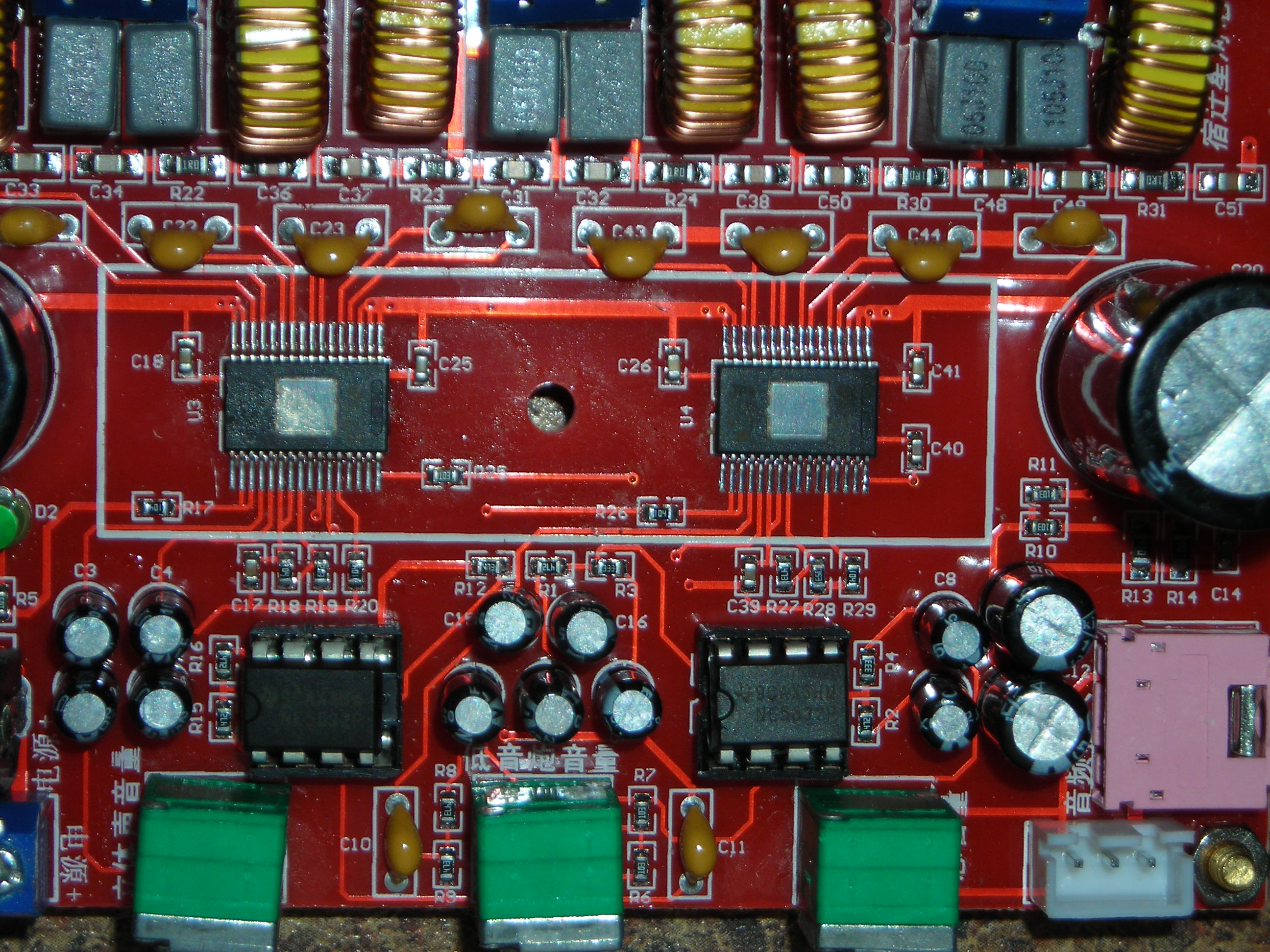

Thank you for taking the time to decode and explain what needs to be done. I understand now what I need to do. I think that if I work slowly and carefully that I’ll be able to swap the resistors.
Replacing the C40 with a 470pF part that maybe a little tricky, as it’s located under the heatsink, so I may have to order a SMT Chip Capacitor.

Do you have a DMM with Frequency option ? Or one that can measure capacitance ?
Without c40 bassamp works properly, with standard 1nF it doesn't, with your 470pF it is not likely to function properly. The zero you add is important.
No, I just have a basic analog multimeter. Also I made a typo I meant 47pF instead of 470pF.
Are you saying that I can just remove the c40 capacitor and the amp will work properly as a slave and master? I remember that you said I needed c40 to be 47pF to filter HF noise from master amp.
Yes without c40 the slave will follow master exactly. Yes the master synch output might inject some more HF noise into slave chip than with small value c40. You can never hear that, maybe a wireless connection or radio/tv reception or other electronics functioning in house will notice, but c40=1nF causing the slave not to receive synch signal seems more likely to cause all that. But I can only guess.
