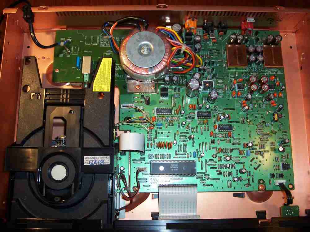

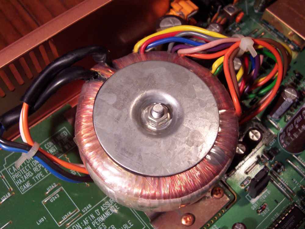

Hi, the primary on the toroidal mains transformer is burnt out, it's an ILP 1E627 looks to be part of the KI upgrade as the board seems to be made for an IE core tranie not a toroidal, sent a n email to ILP but no reply yet, anyone got one spare or have any ideas for me to get this classic going again?
Here are a couple of pics.
Cheers George

The toroid is the only major change in the KI, apart from value changes in many components.
You can replace with the standard tx from a '63.
Andy

The only real problem is providing the supply to the display.
Your cd-p will benefit from multiple transformers especially if you split the +5v supplies to the digital and analog sections.
