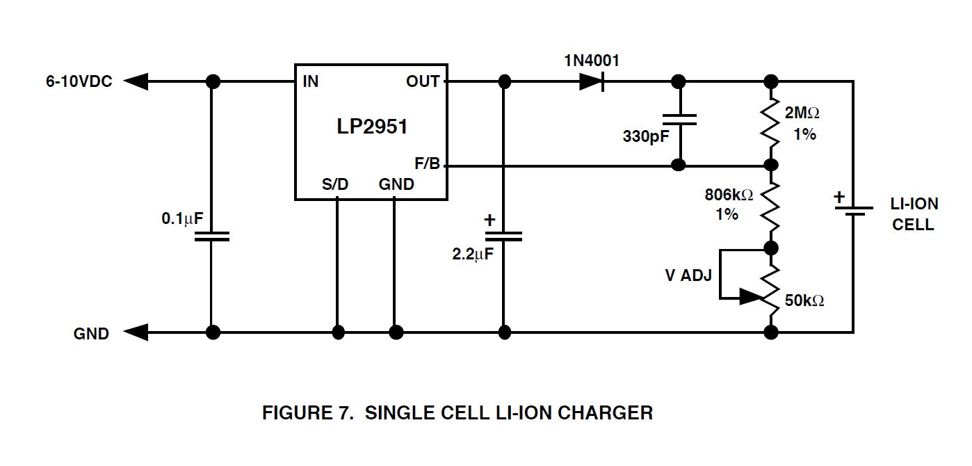

To check the current out from your circuit you could use a resistor that would give around 6-7V with your set current limit. Then check that the current is OK.
If you want 100mA charging current, test with a 60 ohm resistor. The current should be 100mA and the voltage will (according to ohm law) be 6V.
