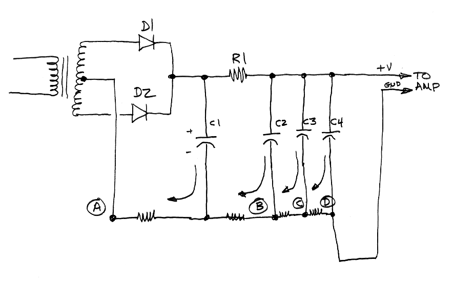

It's possible that your design is OK but its physical construction is not great. You want to connect the output ground (to the phono stage) after all of the capacitor connections -- see figure.
The physical wires that conect the center tap and the capacitor minus leads, are not perfect 0.0000 ohm superconductors. There are small (milliohm) resistances in the ground leads; I've drawn then as resistors between "ground A" and "ground B" and "ground C" et cetera. Capacitor ripple currents, drawn as curved arrows, flow through these resistors, so there will be ripple voltages produced. You don't want to pass these along to the phono stage, so you want to physically connect the "output ground" to point D, the very last point in the ground chain.
Maybe you could draw a similar "how it's actually constructed" diagram for the power supply you have now, and show how the center tap is connected to C1, C2, C3, C4, and the output ground.

Thanks, Transistor. How great you drew this - sorry I didn't provide it (and yes, that's exactly what I've done).
It's a bit hard to draw exactly as built as I'm using an old (previously used) Radio Shack prototyping board for the build which has parts going in odd directions because many of the copper pads beneath are shot. The ground is a bus in the middle of the board right next to another bus used for the + lead. But...not all cap negatives are connected directly to this bus. It's a bit of a mess, but functional and I've built like this before and not had problems.
Here's the board: http://www.radioshack.com/graphics/product_images/pRS1R-2265164reg.jpg
In answer to your question, though, the point at which the ground is pulled from the bus is just before the second cap, so what you say could be a factor. Easy enough to move that and try again.

OK, I took a little time to work on this and pulled the amp ground from after the last cap as you suggested, twisted the transformer wires, then found the following:
1. The ground bus trace was broken and the last cap was not connected, so while I got output from my first build, it was with no help from it.
2. After fixing the ground bus, I got output of 18.5v or so using all 4 caps, with an AC component of 0.001v (according to my digital vom). AC had been more like 0.005v when I had only the 470uF first cap and the 2200uF second cap (other two caps were added later and I didn't measure AC component before moving the ground per your suggestion). I do have an old "boatanchor" scope that I'd hoped to use to measure the ripple but couldn't figure out how to get a good measurement from it.
3. Plug it into my phono amp, and I'm still getting hum just as bad as it was before.
4. Power "umbilical" is just two twisted wires (maybe 20-22ga), no shielding, and about 5 inches long, terminated with a DC jack.
5. Battery supply has a small amount of hum compared to the linear supply but it's very noticeable at full volume on my 2W SE tube amp (also DIY) which is otherwise VERY quiet into my 92dB +/- speakers.
Is there any problem having the amp case grounded at the power inlet? Should I be doing anything else with that?
