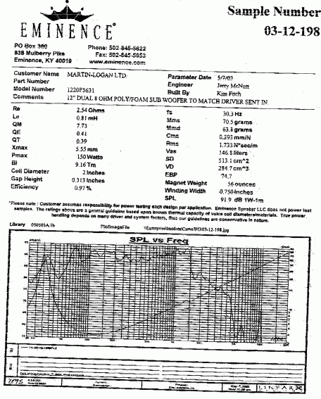

Exactly what I measured a few years ago, this was the fix a freind a I developed for it and it works like a charm.

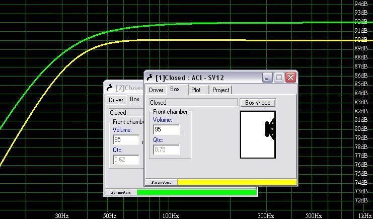

So there are extra c/o components to consider....
The apparent ineptitude in the crossover design is staggering.
(implies only Re and Le were used for design - so wrong, and
what about testing the thing before you flog it to the masses ?)
Almost certainly you will need a new parallel network for the ACI.
According to the total sim having R2 in circuit is almost mandatory
if you don't have the conjugate bass impedance circuit connected.
It indicates without the impedance circuit that bypassing L1 or L2 to
give 5mH instead of 10mH response will be far better with the ACI.
(the simulator does not allow adding the conjugate circuit)
S1 (adding R2) with 5mH then seems to work very well.
Concerns about driver distortion seem academic with low frequency
inductors involved, unless they are of utterly herculean proportions.
:)/sreten.
Streten, I never cared much for the -3 switch position, esspecialy after the LCR was instaled, it did reduce the output but also somehow made the bass muddy.
Streten I,m not understanding the last part of your last post too well, are you saying that I should short out one of the 5mh chokes when I use the SV12?
And I should re-design LCR for a different frequency/level hump that is going to be there?
Cheers George

For the ACI I get a peaking response at 45Hz, it looks a
lot better if you change L1 from 10mH to 5mH, well it did
whilst Basta! was working, seems to have stopped.
Will have to restart my computer methinks.
Working again 5mH gives a milder peak at 55Hz, looks
about right, crossover point does look around 100Hz.
With the Eminence parameters I get a utterly stupid peak at
60Hz, adding R2 reduces it somewhat, just looks all wrong.
