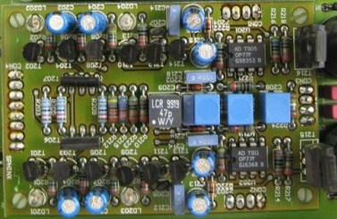

how can we confirm if its the same circuit as the A 1?
If Musical Fidelity are not forthcoming with a schematic, best thing would be you take really good quality photos of the PCB.
Also I have been reading on the AD825 op-amp, would it fit in my circuit? the opa627 is quite expensive, but if its worth it, I'd go with the most expensive option...

The following is based on the assumption that the circuit closely matches the Phono in the A1 (here: Musical Fidelity A1 - Technical), with the two 5534 as the EQ Op-Amp's and the 5532 as the Powersupply (please do read the information in the link carefully).
In this case I would change the following Capacitors (nubers are taken from the schematic in the reference, so will differ from your Phono) with Elna Silmic:
C27, C32 (use biggest value you can get/fit, voltage can be as low as 4V, bigger is better here), C30
I would replace the Op-Amp with OPA627 and then short out R51/C26.
The output Coupling Capacitor (C29) I would replace with a suitable value film Capacitor, MY PERSONAL preference are Tinfoil types, if you want to make sure you can handle a 10K input impedance at your preamp, you need 2.2uF. Physical size and cost are really the main constraints here.
C28 is already a film type, however upgrading this to a Tinfoil type is recommended.
Finally, the EQ Capacitors (C23/24/25) should be changed to polystyrene types. Philips used to make excellent Tin/Leadfoil & Polystyrene capacitors with 1% tolerance, these would be my first choice, they remain available as surplus, but values and availability is now very limited.
LCR makes several ranges of polystyrene capacitors that remain in production. The versions with extra plastic case are suggested. Last time I looked Farnell & RS-Components carried them.
You can afterwards play with the signal circuit resistors if you like. Those are mainly those in the EQ(R52/R53) and around the transistor input stage (R58/59/60/61). There are many options, I would probably use Takman or Beyschlag Metal Film, maybe the TKD Board type resistors, but these are to found outside the far east, where they justly enjoy cult status.
In the powersupply I would for starters retain the 5532 and try upgrading the 100uF Capacitors to the largest value, small size normal types you can find. Sanyo had a series of very small size, large value capacitors (green sleeve, silver/gold printing), they had 1,000uF/16V that should fit the PCB...
I think in the above, buying from sensible sources the budget should be well below 100 Pound.
The resulting Phono stage should be really of very high quality.

I'm waiting for a answer from musical fidelity for the schematic
Good luck. Until then, if you can post some pictures I can probably figure it out from them, IF you take clear photos and of both sides of the PCB...

Musical fidety told me that its impossible to give me the schematic. I will post pictures tonight.
