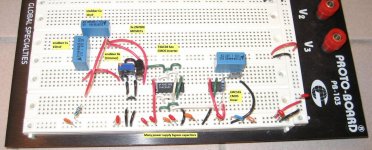

The "complexity" of Quasimodo is one transistor and two ICs; it can be slapped together on a proto-board in two hours, picture below. It worked quite acceptably. Later I built another Quasimodo, this time on a PCBoard, so I could reclaim my proto-board for other experiments, projects, and foolings-around.
A pleasant safety feature is that you can connect your transformer to Quasimodo, and connect Quasimodo to a 9 volt transistor radio battery: (example). You don't need any connection to the AC mains {or a variac} to optimize a snubber. Nor do you need equations; it's a "no-math" empirical approach that uses measurements only.
Connecting an oscilloscope to a circuit powered from a 9V battery, is considerably less dangerous (and less frightening to newcomers), than connecting a scope to a circuit powered from the AC mains. The lethal AC mains. Especially so if the transformer's secondary voltage is higher than the mains voltage, as occurs in vacuum tube circuitry.
