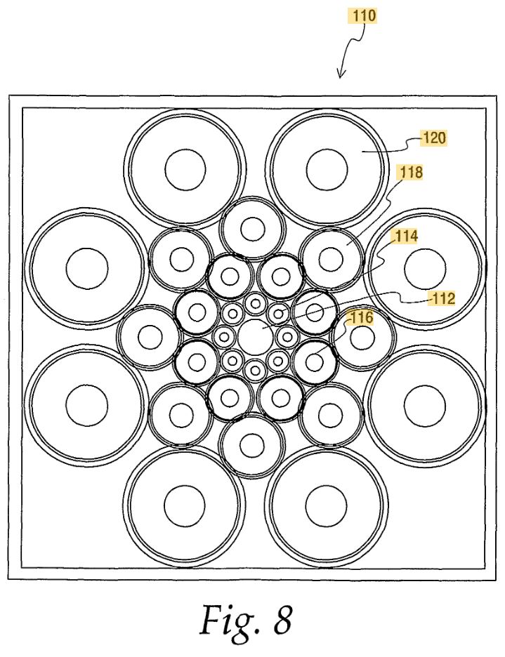

It's elegantly simple really.....it's a way to get drivers centers-to-centers closer, and move more towards a hypothetical point source.
On a flat baffle, it's pretty much impossible to keep multi-way sections c2c's within 1/4 wavelength at crossover.
Here's a theoretical example of a ring array attempt at that, pulled from one of Danley's synergy patents
Now drape that flat baffle with all its drivers over the top of a pyramid, and the whole thing collapses, bringing all the drivers c2c's closer in the horizontal and vertical planes, when the pyramid is rotated to have the base face the listener.

But if you want 1/4 WL driver spacing all the way down, I don't know of another realistic way (other than line arrays whose problems lie on the top end of the spectrum)
So, like said at beginning....it's all about trying to get as close to a point source, over as much bandwidth as possible.

Aaaaagh….ok….so it’s the point source presentation but the directivity control is still dictated by the size of the horn. So if you required directivity down to 500hz, mounting the midbass drivers within an MEH doesn’t help unless te size of the horn is the typical unruly beast I could live without.

Yep. when is comes to directivity control, size matters.
If you're ok with 90 degrees horizontal, 500Hz needs a 22" wide horn (conical)
If you like wider, say 120 degrees, 17" works for 500Hz
If you like wider still, well there's good ole flat baffles huh?
