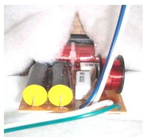

Now unfortunately, I have no data about the crossover - all I know is that it uses two bipolar electrolytic caps, one 8uF and one 3.3uF as well as two inductors, which would make it a second-order design. No resistors are used in the crossover. The inductors are not marked, and Energy has not (yet) replied to the mail I sent them asking for more data on the speakers. I'd be making a new crossover anyway, but knowing at what frequency it's currently set to cross over would of course be helpful...

Crossover:

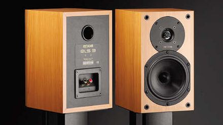

Important to understand what sort of driver you want here. I would guess it's a polypropylene 4 ohm type to work on such a simple filter. Bit like the Epos ESL-3. Epos ELS-3 loudspeaker | Stereophile.com
It's significant that it has a near transparent cloth dustcap, but a phase plug works the same way too.
The Peerless 830860 on a 120mm cutout is this type of driver:
Peerless HDS PPB 830860

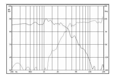

Haven't got much time today, so I'll just leave you some details of the Epos ELS-3 to mull over.
Thanks a lot for the info! You're spot on on it being a polyprop 4 ohm driver - I neglected to mention that in my OP. I just wonder whether I could file out the cutout and retain a somewhat circular shape... The tweeter on the Energys seems to be an 8 Ohm model by the way - measures at 6 ohm DC resistance.
I'll have to redo the crossover anyway, the problem is just that I have
a) NO idea how to go about that - I'm studying EE and understand how analog passive filters work, but we never got to the nitty gritty of designing filters for speaker systems and never focused on audio applications in general.
b) No kind of data on the tweeter at all, which I'd assume would be essential to designing a crossover to mate the tweeter together with any new woofer
Do you think there's even a chance that I'll be retaining the original tweeter and still get a good loudspeaker (as good as or - preferrably - even better than the original)? Apparently a whole lot of money went into designing this tweeter back in the day so it would be really nice to keep it as I doubt I'll be getting anything as good at a reasonable price point.

Also, I'll certainly remake the crossover. Electrolytics and ferrite-core inductors IMO do not belong in a good speaker's XO signal path. I have no experience designing crossovers whatsoever but if I'm gonna spend money on fixing these speakers up I might as well try to give them a proper crossover. That is, unless someone strongly suggests otherwise although I really doubt there's a compelling reason to keep the current one (except for the financial factor).
By the way, I'm from Winterthur too - funny coincidence!
Why do people who know nothing about crossovers have such firm opinions about components like electrolytics and ferrites? Just sayin'...:D
The real answer on general principles is always that poor components shouldn't be used in stressful and highly tuned situations. :cool:
I'm struggling to find a 4 ohm polycone here. Nearest I've got is an SB acoustics 5" SB15MFC30-4 : SB Acoustics :: 5" SB15MFC30-4
124mm cutout. IMO the bass Filter will be almost identical to the ELOK kit that SB do, third order because this is a low inductance design.
Well, I based my "opinion" (not very well founded as I am aware) off those of people much more experienced than myself such as Troels Gravelsen and Rod Elliott, who both seem to be of the opinion that a) crossover components should be of good quality (and 20 year old electrolytics are even worse than new electrolytics) and b) crossovers need to be carefully designed for a certain combination of chassis and drivers. The original crossover also has no impedance compensation whatsoever, which also makes me think that making a new one wouldn't be totally out of line. And reusing the old crossovers with a new driver that it wasn't designed to be used with just seems wrong to me, especially if I'm gonna be spending any kind of money on those drivers. Add to that the fact that I'll be able to relatively easy measure the impedance at my university (SPL testing is a different animal, unfortunately - I'll have to do attenuation matching by ear, if at all. Later versions of the Energy crossover had an attenuation network in the crossover so I'll see if I can get the values and schematic as an orientation) and I really don't see a reason not to make a new crossover as it'll also be a valuable experience. Rod Elliott has a great looking guide on constructing 2nd order crossovers on his website - I've been thinking about following that, although I obviously have no way to judge its applicability to my situation.
