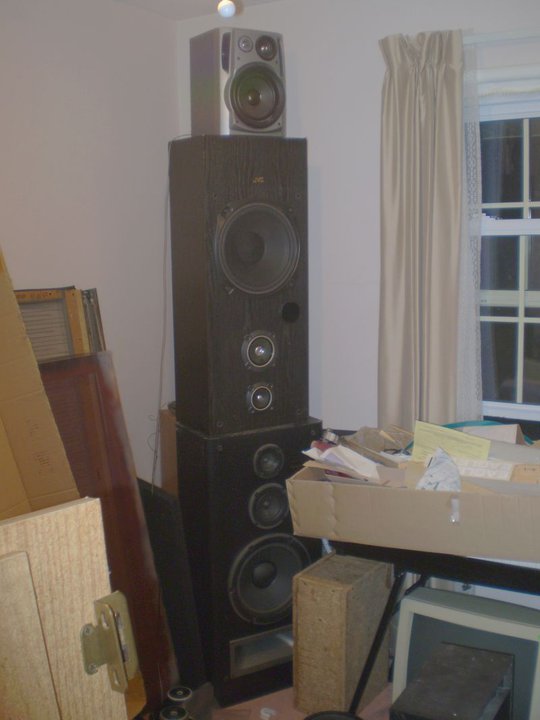

Yes,there is something wrong with the published data on the 299-283 driver.
For the modeling that I did I used the specs from the 299-284 driver and it was available at the time.
To me they look very much like that they are the same with little diffrences.
But you can't judge a book by its cover nor can you go by the published specs for the 299-283 driver either as thet appear to be wrong and don't work in Winlsd.
I modeled the 284 driver as an IB and closed box range .75cu ft. to 1.2cu ft. per driver and came up with some impressive SPL's and a good looking curve.
I will search my archives for the files and if I can't find them I will do another set of sims and post them for you or you can try them in Winisd as well using the data that I used.
I was going build 4 cabinets with 4 drivers so that they would be easier to move around and have a stack in each corner of my room.
Remember that these are cheapy's so don't expect a lot but the price is right!
The 299-284's look a lot like the 10's that I do have and the FR chart is the bottom one in the first set of charts in post #2 as measured facing the corner as I have it now.
All of those charts are of the same system although I didn't take the time to label them as too the measurement positions.
The first chart is of just the 10's though, in the corner with the microphone in three positions Ceiling, Middle and Floor.
Th middle one shows a notch at about 250Hz and this correspondes to the distance of the ceiling to the top of cabinet of about 4 feet.
The 8" sub box that you see on the floor is normally placed behind the top 12" cabinet facing the corner with the dual 10"s.
I get about 110db with this system at my listening position at about 12' to 15' away from the stack in a 18' X 11' X 8' room.
And it is clean sounding as well.
