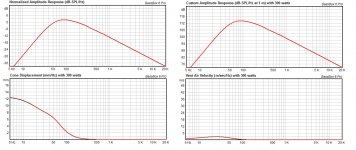

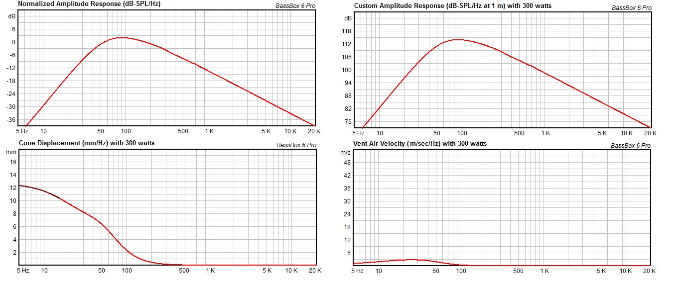

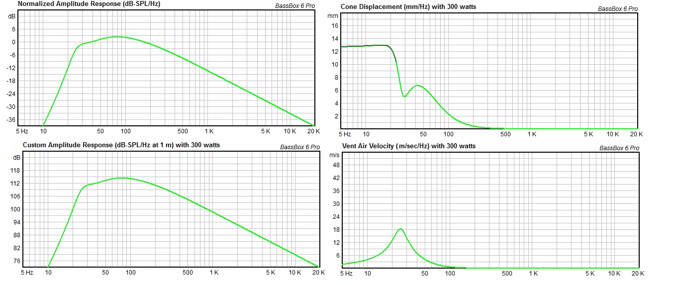

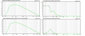

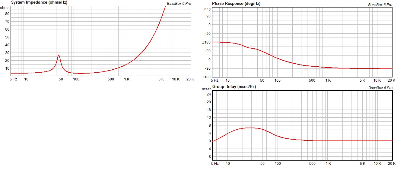

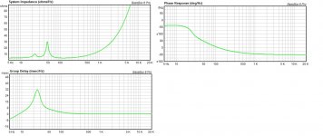

@ Duanebrow - I think the Lab 12 we ordered is a 6 ohm version! I was looking at the specs and think that it will be fine with a 4 ohm plate amp @ 300 W. Driver's Re is 4 point something which should be fine with the amp. Or am I missing something?
I didn't see a 4 ohm version of this driver. Also, the company that offers the driver here provides the 6 ohm version. We ordered one new from E-bay (few bucks saved) I was checking out the manufacturer's website but did not see a 4 ohm version (maybe was over-excited)

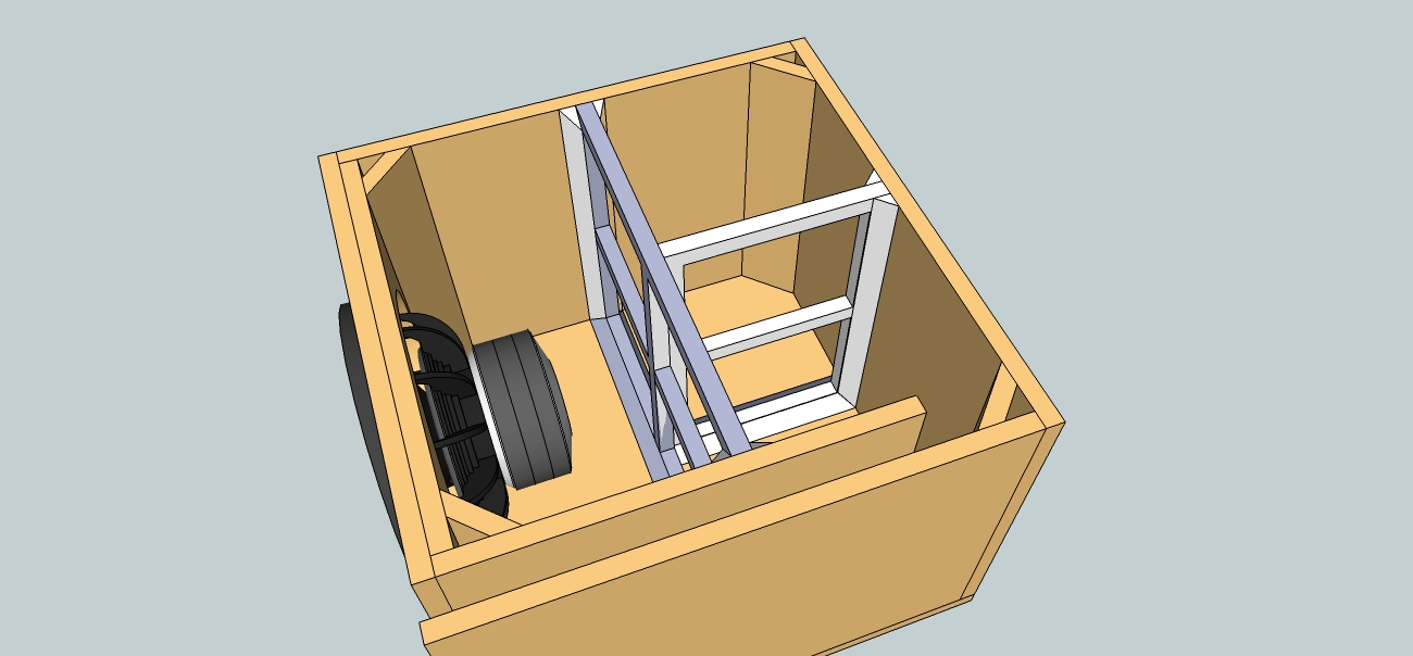

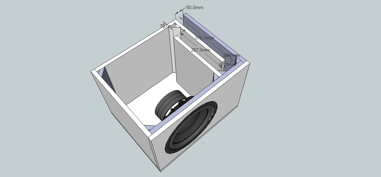

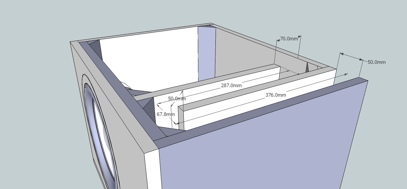

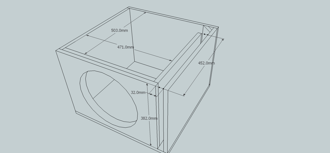

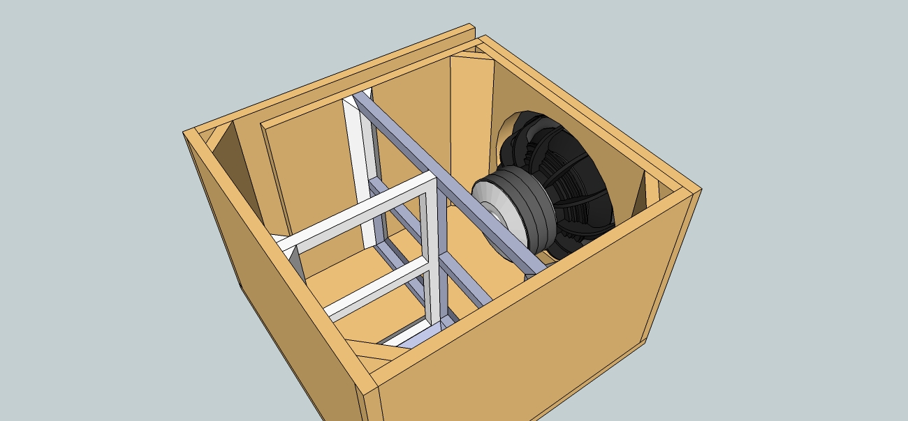

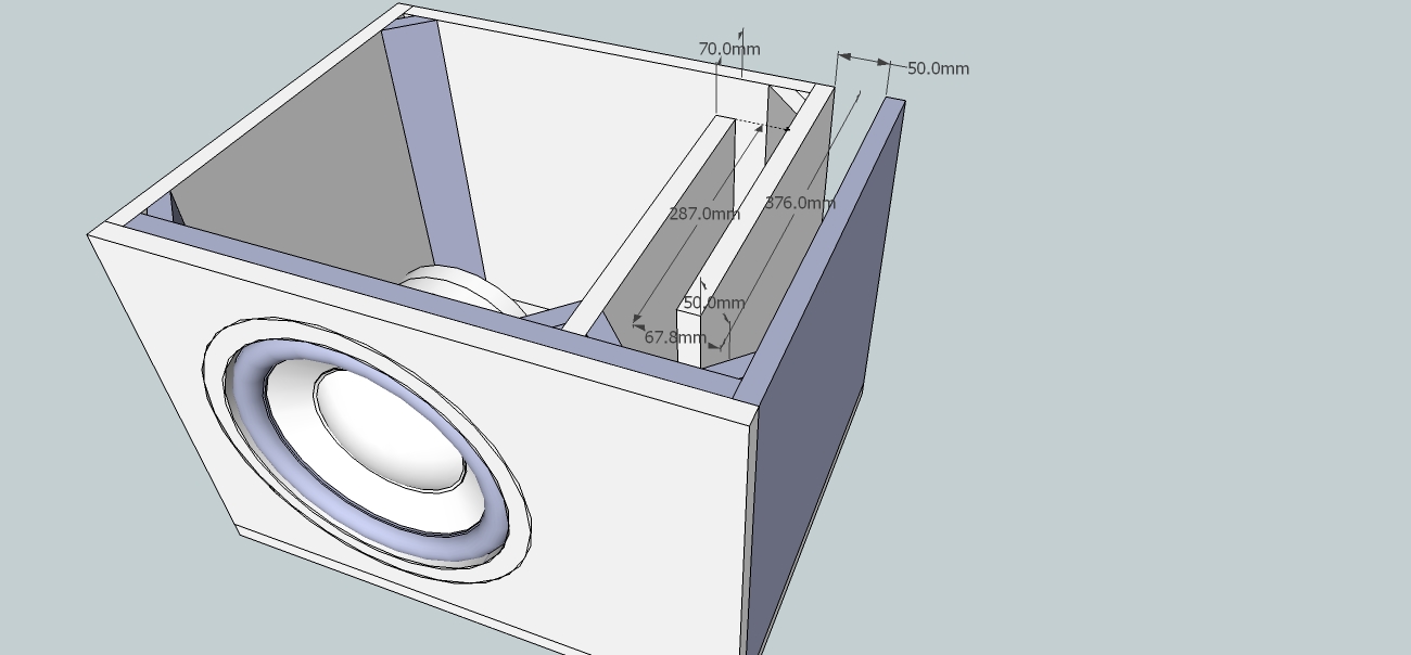

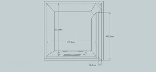

@Djim - thanks for the clarification on the bracing. I was not sure if I should extend the brace toward the front baffle. I will modify it as you suggest. I like the flaring on the port, but it will greatly complicate the construction and assembly of the box. I have basic power tools and I am taking the MDF to be cut by a third party on a table saw (less fiddling with sand-paper on the edges on my part) I've heard about kerffing or something, a procedure that makes the panel bend without breaking the surface. It looks really nice, but a little bit advanced for my carpenter skills.
On my design, I kept the corners as well as the double front baffle which aims to also reinforce and hold the port wall better. I will most probably get rid of the 45s in the front cause, as Duanebrow pointed out, they actually don't do much other than take space. I agree with this after giving it some more thought.

Djim, i really like the 45 flare! It didn't cross my mind earlier...

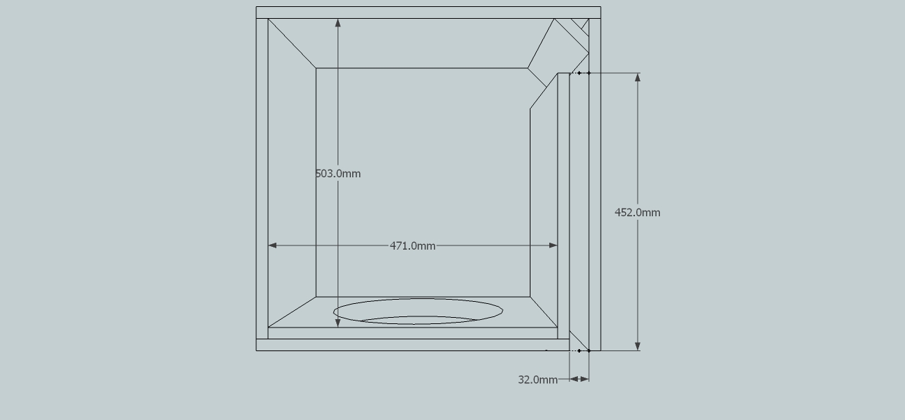

Anyway, I finished the Lab 12 box design, I haven't calculated the volume of all bracing though, but at least on design - I like the box! My friend was blown away, now all its left is for it to work I guesstimate the bracing will subtract a fair amount of volume!
Djim's idea about the 45 flare on the vent was VERY welcomed, for which I am VERY thankful. There are some minor touches to be done to the center cross section of the brace, I am wondering whether to make it 45 section all around in the center. Same 45s as the brace support. It will be like hexagonal pylon

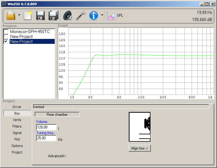

To clear my mind - I've been thinking about my Audiobahn 10" and.... I now understand the difficulty in getting good sound from limited space in messed up environment I've started calculating a new box and oh boy, its not easy! Working with limited space requirements is a pain...
I will be back with some calculations on the car sub later, but at least for now you can have a look at the Lab 12 box and tell me what you think.

Anyway... in the last few days we got the braces cut out, the box is very well cut. Currently its just assembled to have a look at it, no glue - nothing, specs down to the mm I redid the box design, added a separate compartment for the amp, made it slightly larger to account for the volume of the bracing inside.
Box Volume ~103 liter
Tuning ~29 Hz
Driver - Eminence LAB 12
Amp - Bash 300 (silver one, with the switch phase - yeah I know.... not much I can do there)
All that is left is to cut the double front baffle circle for the driver. All the parts are separate - I am thinking of gluing the two front parts together and then cut the circle - seems to be the easiest way. MDF glue, 4x45mm screws (pilot holes before that) and we are thinking of paint - for better interior matching
