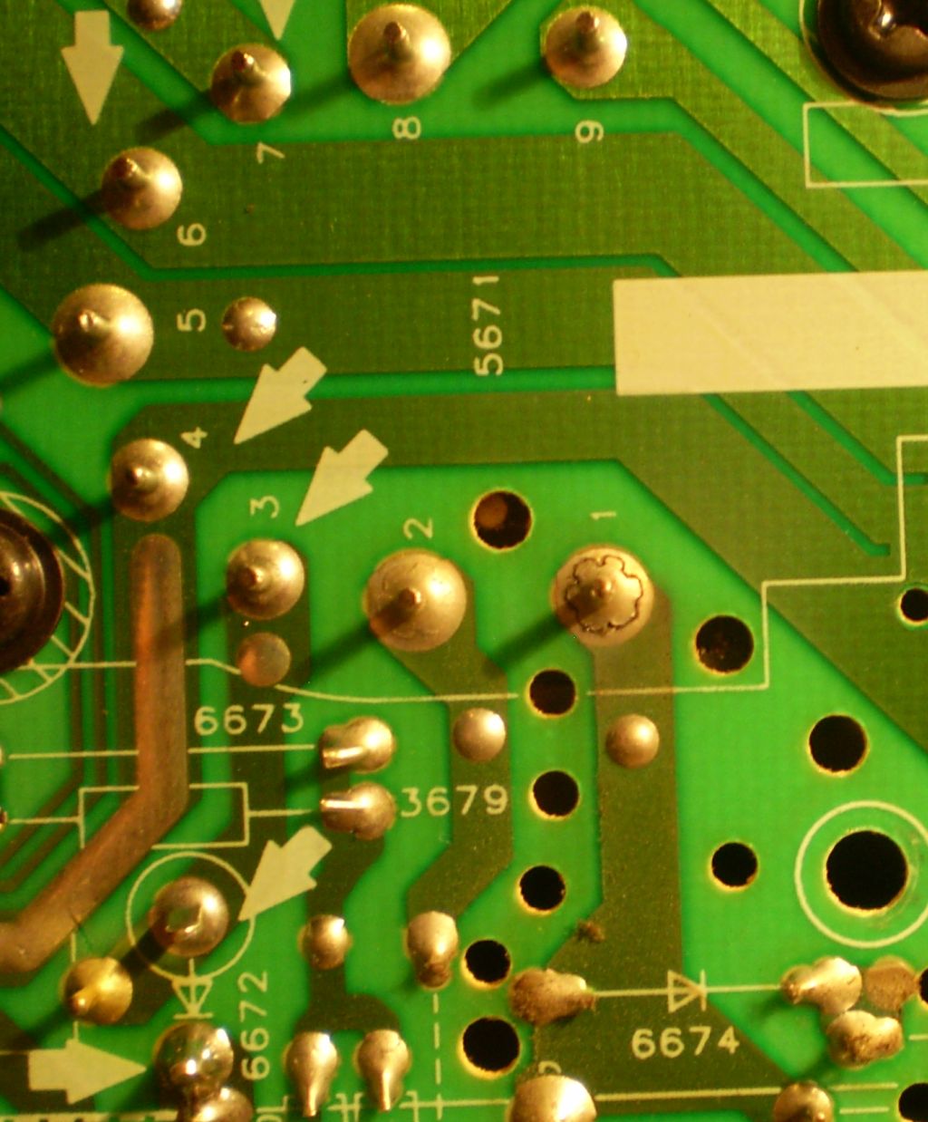

Oh I have cracked traces alright.
When they were damaged there was fire or at least smoke as there was soot on the caps of the power supply and inside the metal enclosure. The resin that covers the traces has been completely burned away below where the old resistors were. The PO ran beads of solder along the traces to mend the broken spots. I removes this as it was 1/8" thick and soldered in Teflon covered silver clad copper point to point.
What really sucks is I broke the glass tube from inside my solder sucker trying to get the huge globs of solder that had become lodged in side.
The woofers are fine. I hooked them up directly before and they are fine.
Seems there is an issue with the jumpers on the speaker terminals. This will also be part of my sleuthing.

That I couldn't tell ya.
They could be using the case as a common ground connection.
Check and see if there are any traces going to any of the standoffs.
Sometimes cracks can form in the trace were the screw and washer compresses the board.
As badly as that board is burn't it could even be conducting causing a short!!
I had this happen on the power distribution board in my Mackie 32-8 mixer and it shorted half of the supply to all of the opamps causing it to go haywire and a dead master section.
It was enough to drop the voltage from +/-18V to below 12V or less on each rail.
A bypass cap went bad and shorted and the whole area was burn't with nothing left but charred carbon.
I could measure the resistance of the charred part with my VOM!
I had to grind out all of the bad material with my dremel like a dentist would do for a bad tooth before I could repair it.
Fixed it and all was good for 4 years until the last recent go around with the those crappy aging molex connectors that are in it.

The PO replaced every thing.
He had already burned everything up and then followed the upgrade using the Dayton caps that is posted on the internet.
He did a shitty job. He snipped a lot if the leads coming out if the PCBS and then snipped the cap and resistor leads and soldered the new parts to the stubs.
