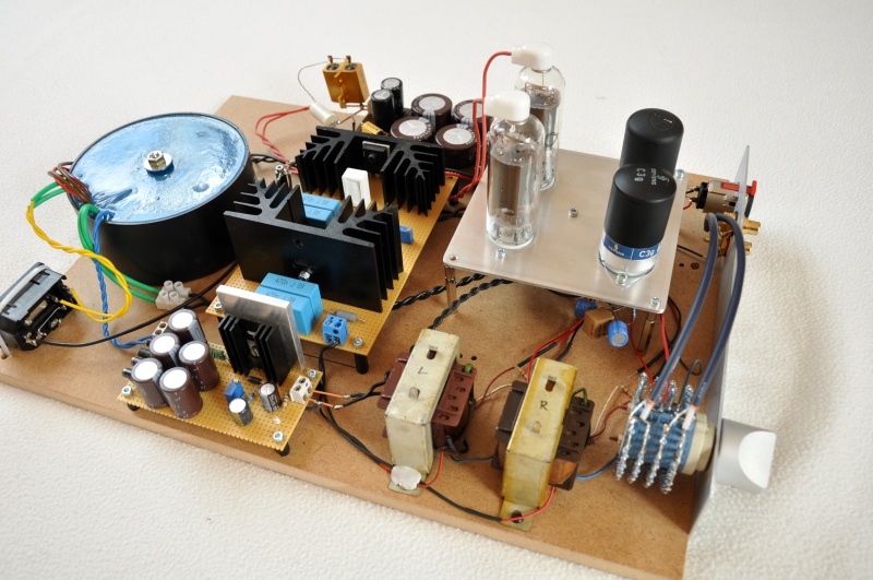

My latest, still on the breadboard...

Even with small vintage Grundig OPT's sounds gorgeous, very detailed and fast... brings you very close to the music. Custom made output transformers arrived today
The whole thing eventually will end up like this:

Building a similar amp only different output tube, on your 3D image I'm not seeing a heatsink, I think you're going to need big heatsink for those mofset.
It's playing for 30 some hours now... heatsinks are big enough. Only the mains transformer (potted toroid) and the tubes will sit on top, all the rest is hanging underneath.
Thanks for the picture, our amps will be such similar topology. But looks like you are using only one shunt supply? I was planning on one per channel as I thought I read there would be instability supplying 2 channel with one reg, would be a much less complicated build with one Salas reg.
regal,
there is absolutely no issue with supplying both channels with one Salas reg.
My Aikido (parafeed btw) is also fed by a Salas reg and performing beautifully for almost a year now. Compared to the previous psu which was CRC soundstage with even one reg has improved considerably. I don't really understand why but now noticed the same with my C3G-spud pictured above.
As for the question parafeed or SE... I couldn't tell a favourite. In a tube amp there are so many variables that the choice of output topology is just one of many... for sure I prefer transformers over anything OTL now...
