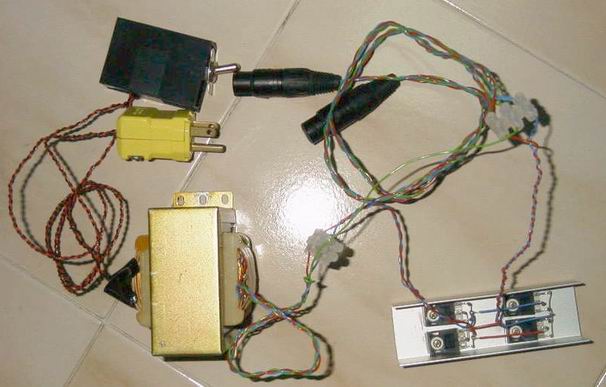

Help!! Irritating sound of my GainKlone
Nuuk said:
When building prototypes, don't just leave everything just sitting there. Screw the transformer onto a chunky pice of timber, the rectifier bridge too and even fix some of the cables down.:nod:
Yes - after some recent mods I was left with a bit of a lash up. odd bits of cheap wire here & there... I thought it was sounding good until I did it all properly this w/e with careful layout, earthing etc with cat 5. The improvement was suprising ( noticed immediately by my other 1/2 ! )
cheers
mike
weak transformer
For me, athough it may not be the only responsible for the sound you have, your transformer is very weak.

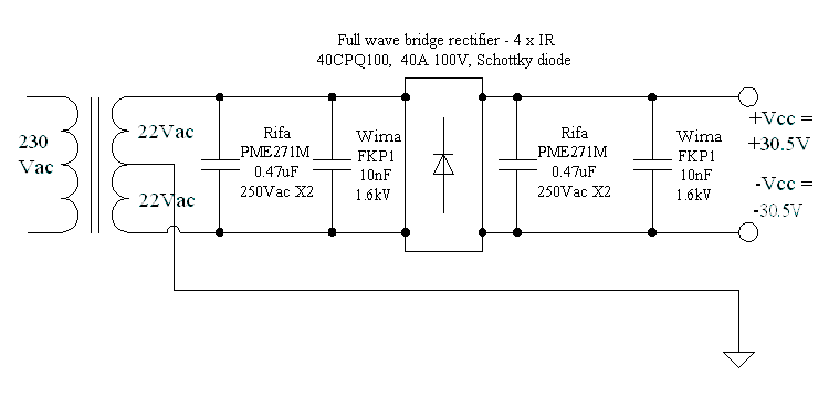

Kuei Yang Wang said:
Finally, the two parallel capacitors before and after the bridge rectifier are SERIOUSLY bad news in my view. remove the 0.47uF Cap and place it after the Bridge to not loose it's use.

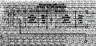

For many years I put a cap like this ( often upto 4.7u !!! ) in this position and without really knowing what it was doing I noticed a HUGE improvement in the sound. ( Also the transformer warmed up a bit !!! )
Having done some spice research on this recently, I now realise that this cap has the effect of drastically reducing the frequency, but not the amplitute and lenght, of the ringing in low resistance secondaries.
My current idea is to keep the 4.7uF with 100ohm in series and .47uF across them both. This stops the ringing and removes and fast transients that might create any RF nasties.
I hope this does not sound too wacky:bigeyes:
If it does here is the test cct I used - try it and see what you think
cheers
mike
PS the voltage source is 18V AC

tiroth said:
I think you are hard at work on reproducing Calculating Optimum Snubbers.
Yes - this was my starting point, but as you can see it was not my finnishing point;)
based on my previous experience I think the bigger value caps will sound better. If the 1st cap is about 10 times smaller than the second its is quite easy to find a resistor value that will stop the ringing.
with 10uF & 100uF+10ohms the tendency for ringing simply merges into the next mains cycle - this is probably going a bit too far but who knows it may sound best of all as it is also quite a powerful mains noise filter !
cheers
mike
to see what is going on put a current meter in between the snubber cct and the TR coil and a voltmeter between ground & snubber caps.

A look from above:
And a schematic for those who like that sort of thing:
Sayonara
Let’s see what I am going to do
1. Remove the wima bypassing caps to the 1000uF electrolytic
2. Move the RifaX2 caps after the bridge rectifier
3. Add 0.22ohm white coffin wire wound resistors between the transformer and the bridge rectifier. Insert two Wima 10nF cap before and after the wire wound resistors.
4. Improve the wiring + arrangement (nail them on a board), transformer upgrade at later stage.
5. CONVERT to inverting configuration. HALILUYA!!!
6. Lowering the value of the resistors used in the amp circuit.
7. By pass the input 4.7uF cap.
8. Add 0.22 ohm Power film after the out pin and the binding post. I think I need a heat sink for this resistor or I have to attach it to the chassis of the amp. So far I can only find Meggritt MPR20 with this value in my country.
9. Upgrade Transformer to 400 or 500VA, +/-24Vac
I will also try the sunbber circuit suggested by mikelm.
I start off with the most cost effective change.
So far I had removed the bypassing wima caps and one set of RifaX2+FKP1 combo before the bridge rectifier, the other combo is still in the circuit. The effect: the bass region of the sound clear up quite bit. Previously, I perceived the bass to be good, but a little on the face, too up front. Now the bass have cleaned up, the on the face feeling is gone, the music is more relax and at ease, but still not quite there yet. Another thing I have noticed, with the bass cleaned up, the mid and the high are also clearer, the high is also more extended and slightly more prominent. I would say the sound before the removal of the caps is more muffle. The improvement is positive.
Kuei’s diagnosis is spot on. Alikato! Kuei San.
Again thank you everyone. I will feedback the effect of each change once I have done them.

Koinichiwa,
Yes. Bypassing is a dicey game. I know people who routinely use just a single bypass. If your "lwo-Z" Electrolytic cap has a "normal" parasitic inductance (say 300nH - gives 180mOhm @ 100KHz and you a 470nF bypass you get a high Q resonant circuit at around 420KHz, quite possibly in a region where it can add to the instability o the circuit.
Yup. BTW, this basic suggested snubber can be much improved upon, I suggest the late John "Buddah" Camilles article in Sound Practices on "Reducing Diode Noise" for a really comprehensive treatment how to kill the various rectificaion noise sources....

The type of snubber Mike suggests as well as the even more extensive ones by John Camille need to be accuratly calculated for the given mains transformer - they are NOT universal. Getting them wrong is worse than not having them.
The simple CRC PI Filter recommended above is nowhere near as effective, yet it is much less critical and close to "universal". You could try using a large value capacitor on the "rectifier" side of this CRC circuit, have a listen.
