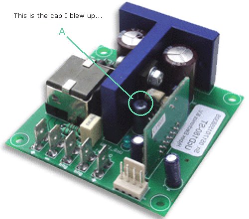

Anyway, awhile back I toasted two UCD180's by putting power to the outputs. I reversed the orientation of the boards and spaced out as I reconnected their existing harness. Power on - POP - smoke - a silent, imagined, tiny electronic scream as sudden death ensued...
+/- power connected to +/- speaker.
I blew the top off the cap labelled A in the picture - nuttin left but two metal leads and a plastic base.
Whatever it was inside that cap was spattered everywhere. It looked like tiny shreds of fibreglass.
Both amps blew the same cap - that is - on the right of the heatsink as shown in the picture. They did not blow the identical cap on the other side of the heat sink.
I am just a hobbyist wrt audio hardware and I'd be obliged if you could help me answer a couple of questions.
1). what did I blow up and what does it do?
2). Is it possible that that cap is all I blew?
3). Shall I solder it out and replace it just for grins, or is it hopeless?
4). If it isn't hopeless could someone tell me how I can specify a replacement? Kevin sent me to Digikey (for a 22MFD 63v cap) but the choices are mind-boggling. There's a bunch of different ones. Which one is right?
1-It's a high ESR electrolytic bypass cap used for snubbing the power rails.
2- Unlikely, since it's just a decoupling cap it would still work without it if nothing else was blown. Check for blackened components as a first step.
3. Hard to say, proceed with caution.
4. Look for other burnt components first.
classd4sure : Thanks for your answer :
On a close inspection of the board (top and bottom) I find no evidence of toasting - no flux runs - and no discoloration of components. It doesn't smell like burnt pcb either...
Would work without it? Hmmm. I didn't even try to run it after the pop. I powered down soooo fast.
:confused: Maybe a good meatball test would be to hook it up to my power supply and see if it works before ordering the caps? :confused: Might tell me if anything else if cooked. Unless it might fry the power supply? :eek:

Thanks for the ID on the cap and the heads-up on where to find it. Not to worry about finding it for me tho, I've got to learn this some time. Why not now? ;)
