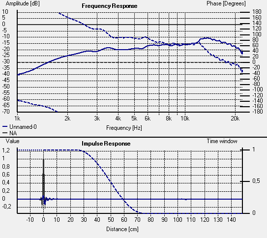

I guess there must be an option in Holmimpulse so you can
include both of the measurements in the same display.
I only saved the file as png so can't do it.
Do you want that save all new measurements to do it?
I don't need new measurements be saved, if I understood you

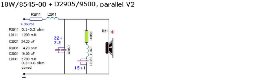

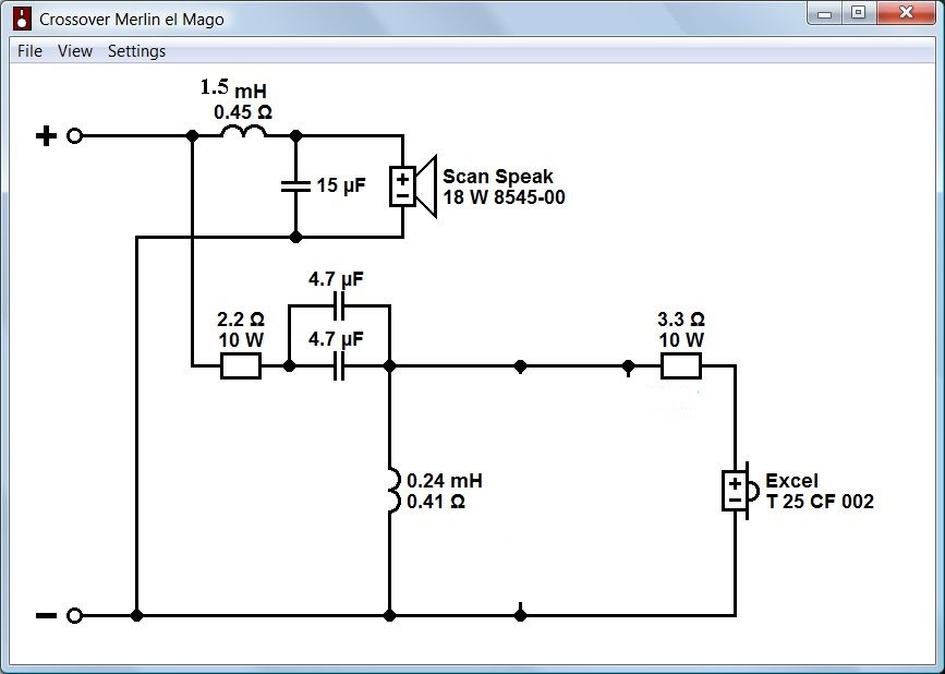

correctly. RLC filter in your circuit is unnecessary. It lowers
a bit the response in the 2kHz region. We will design a new
one with steeper roll off. What exactly passive parts do you
have to experiment with ? I would like to see the impact
of installing 1,5 mH that you have in RLC in place of 2mH.
We want the bass response a bit to the right so the tweeter
does not get so much low frequency energy and that way
XO point will be higher.

Yes, only the DCR of the 1,5 mH will be 0,6 ohms. Does not matter.
We could modifiy this filter of yours if only you had the parts
for trying out.
I found out how you can make the responses to appear intersected.
There are those a,b and c objects on the measurement menu and their
check boxes. When you record bassmid, uncheck the tweeter box
and vice versa. After both measurements, put a checkmark on both of
them and hit the print screen button.

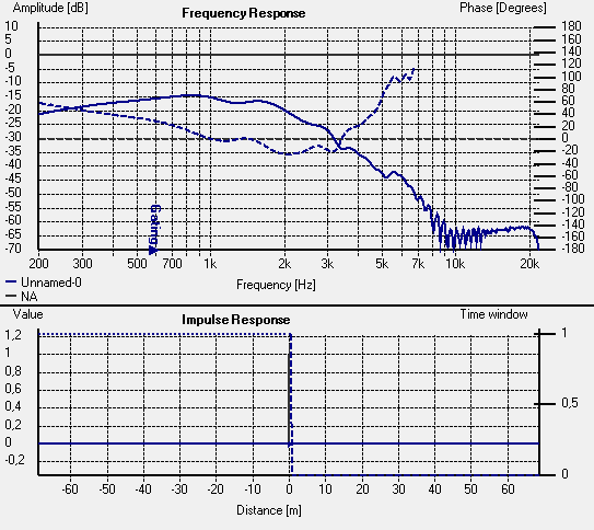

Lojzek,
as this is merlin's 1st time taking measurements, I would think that it might help to first make sure that his methodology is correct and his graphs are accurate before trying out different xo's based on them.
