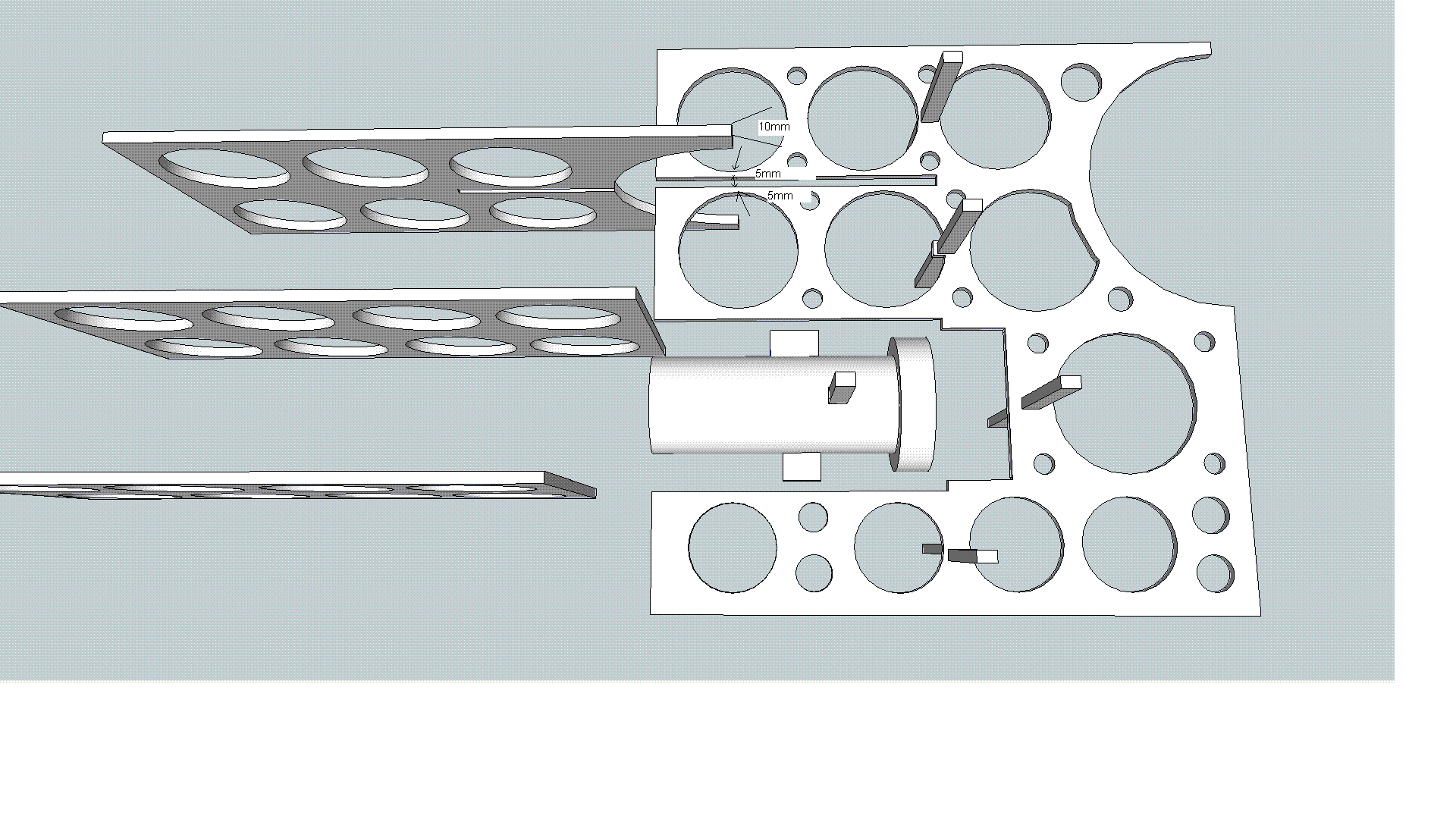

I was trying to show a minimum of 20mm between the circular cut-outs.
5mm from each circle cut-out to the next bracing panel and 10mm of panel thickness.
See attached.

For the bass cab, I'm not sure I would use the bitumen pads on the walls because by adding mass to the walls, we reduce the resonant frequencies of the panels which sort of defeats one of the purpose of the bracing which is to raise the resonant frequencies. But a layer of felt (or carpet underlay) and then a layer of memory foam or acoustic foam should work well. But always leave a clear path between the port and the driver.

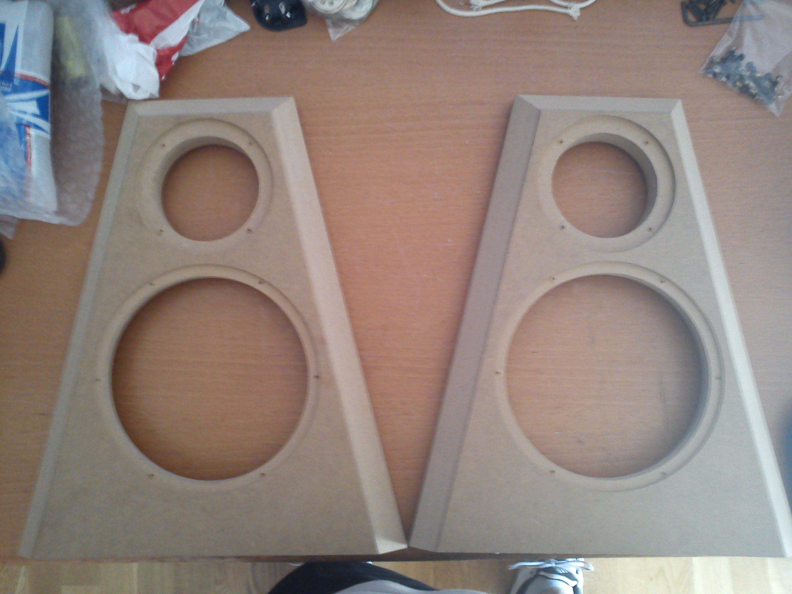

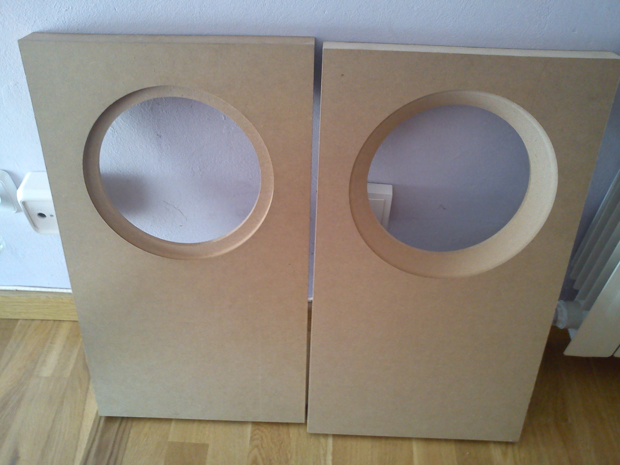

Baffles are looking good.
It's hard for me to tell exactly, names are different over here, however yes it does look like the right thing.

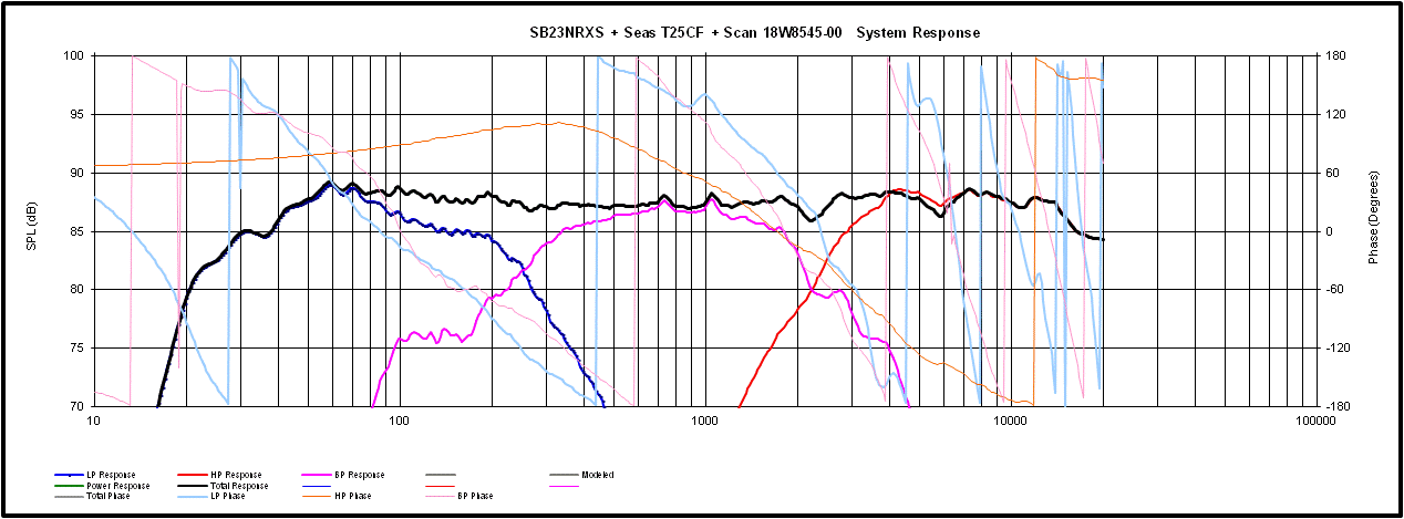

I asked because room size affects the low frequency response and that affects what I do with the xo. In the end though, you are going to be the one that has to do the listening and make any final adjustments. With any luck, it'll just be a few resistors that need changing but I'll show you exactly what does what and walk you through it as much as I am able.
I'll post a new xo for you shortly.

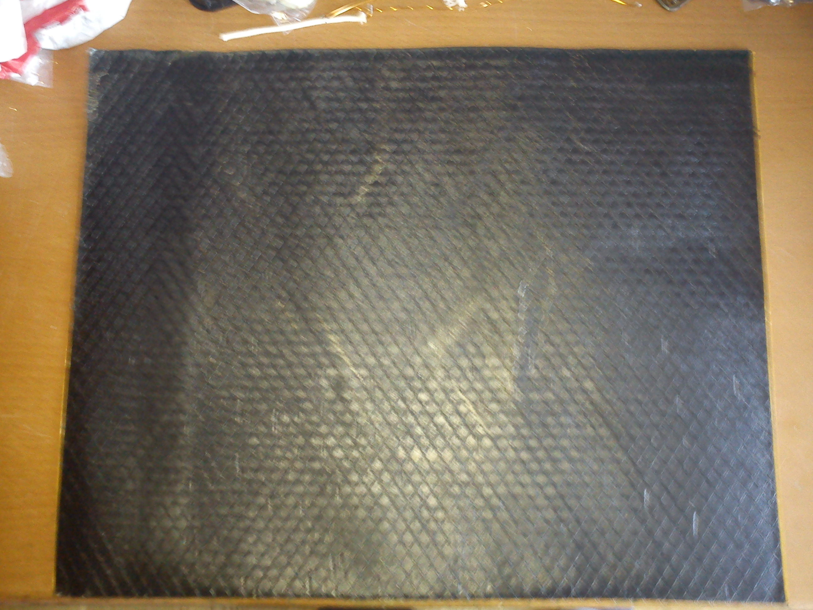

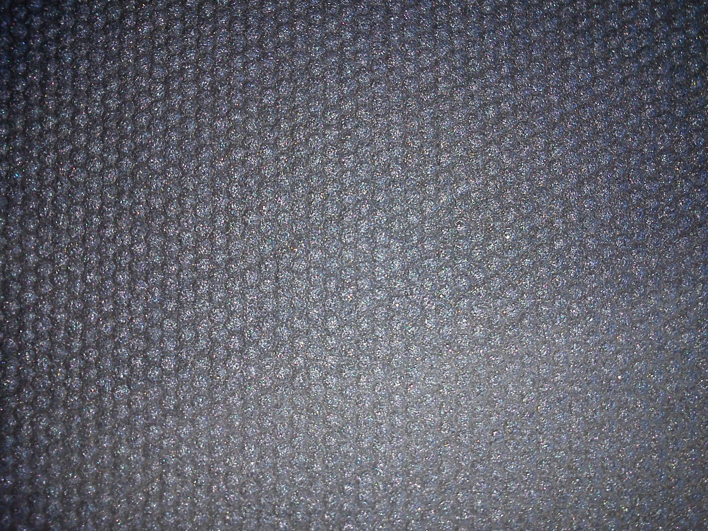

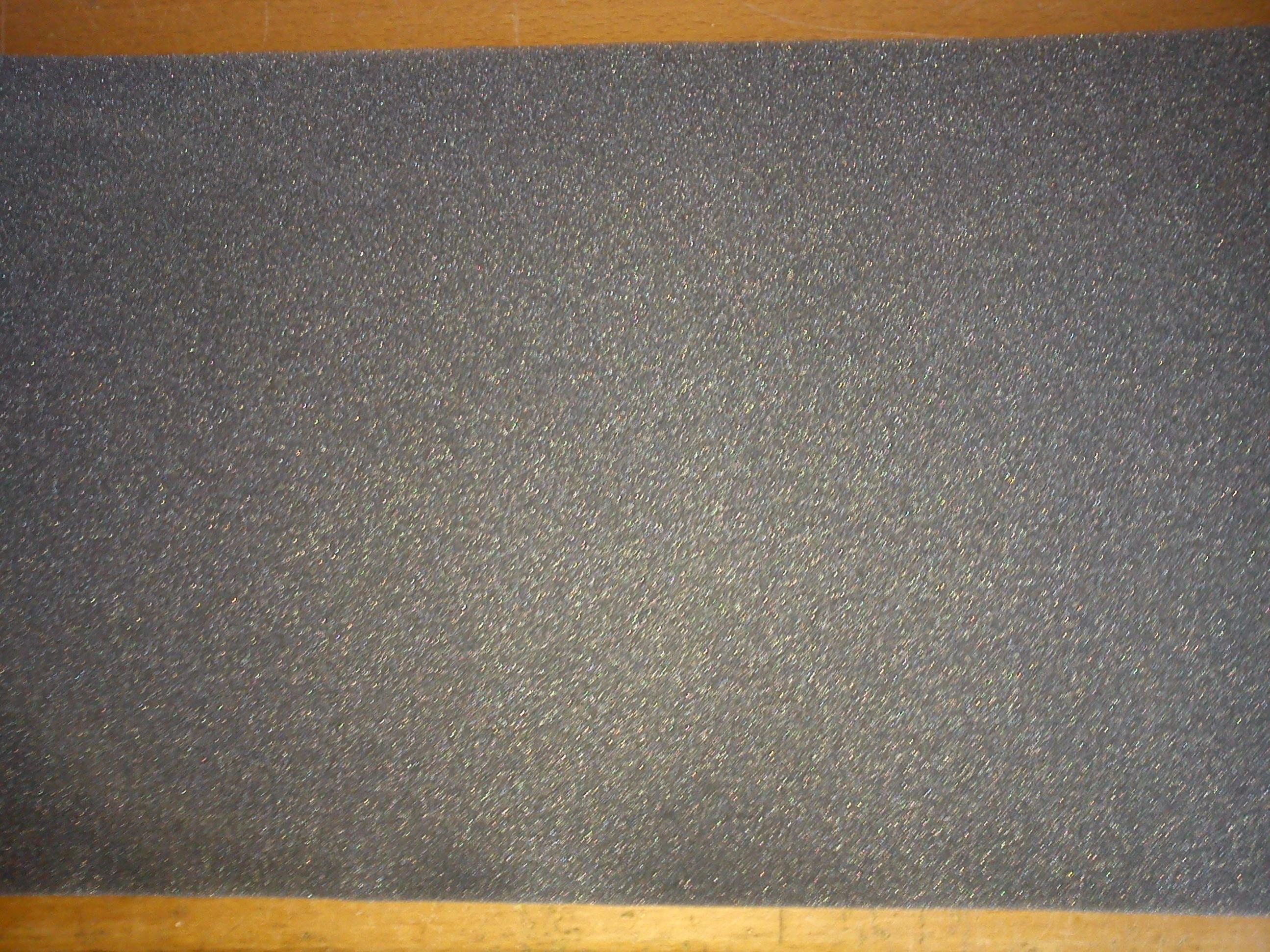

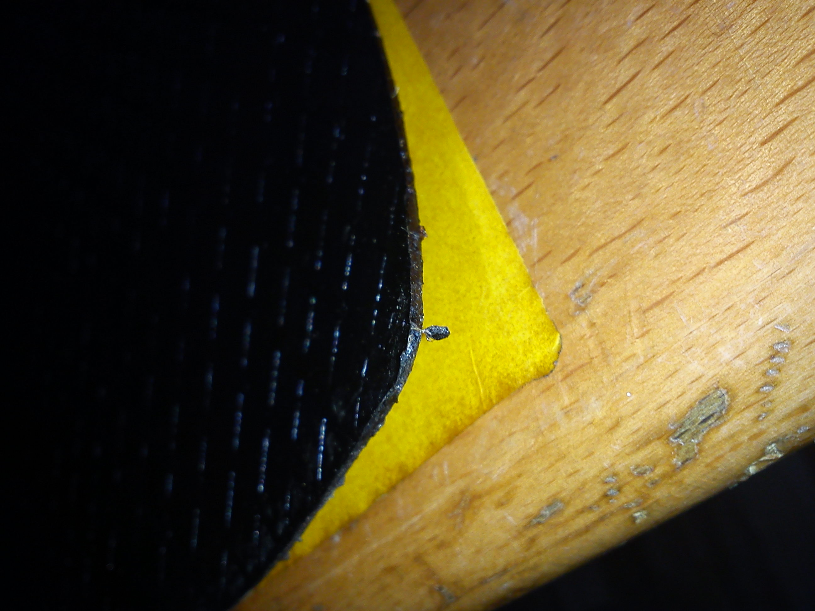

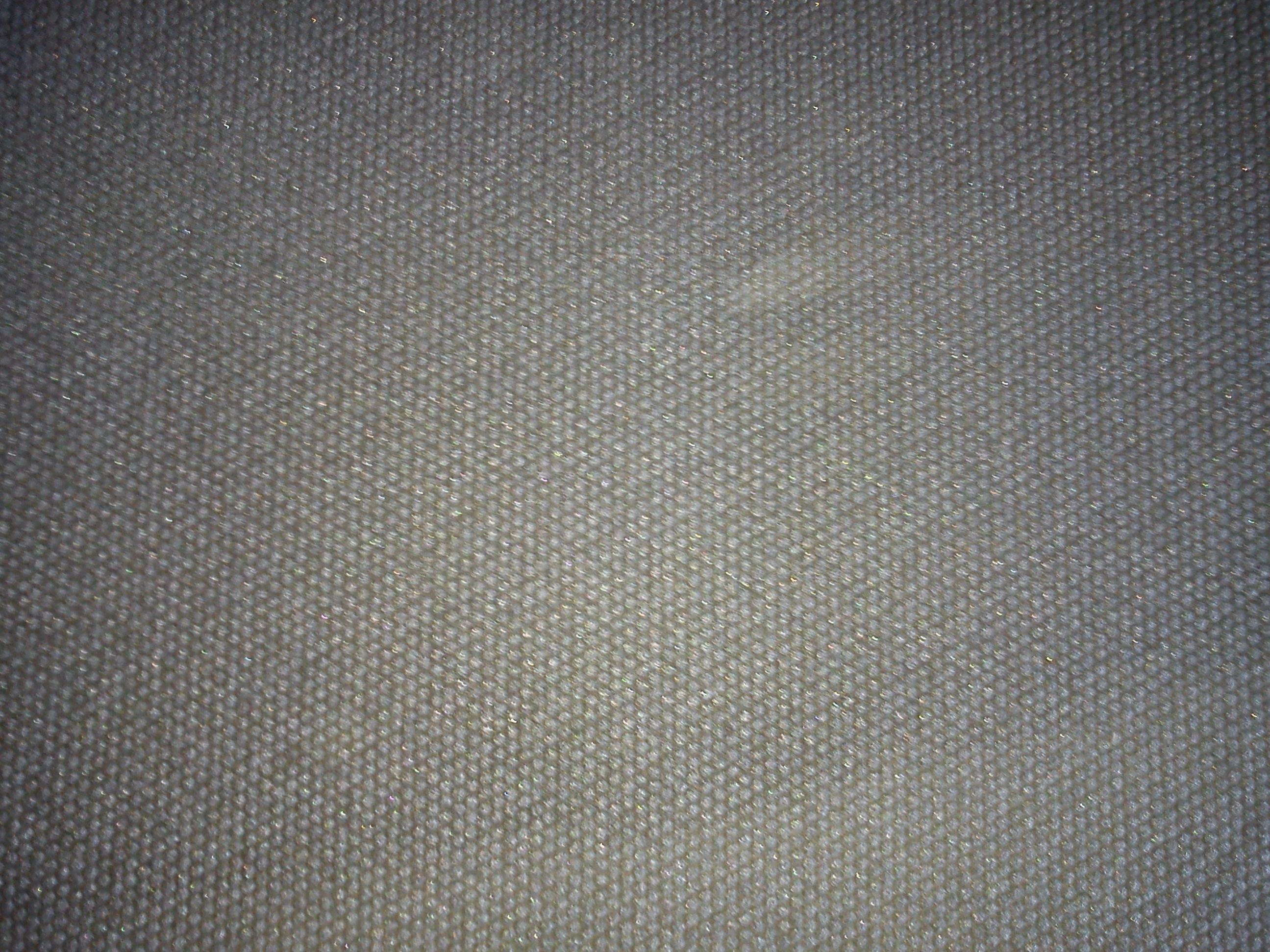

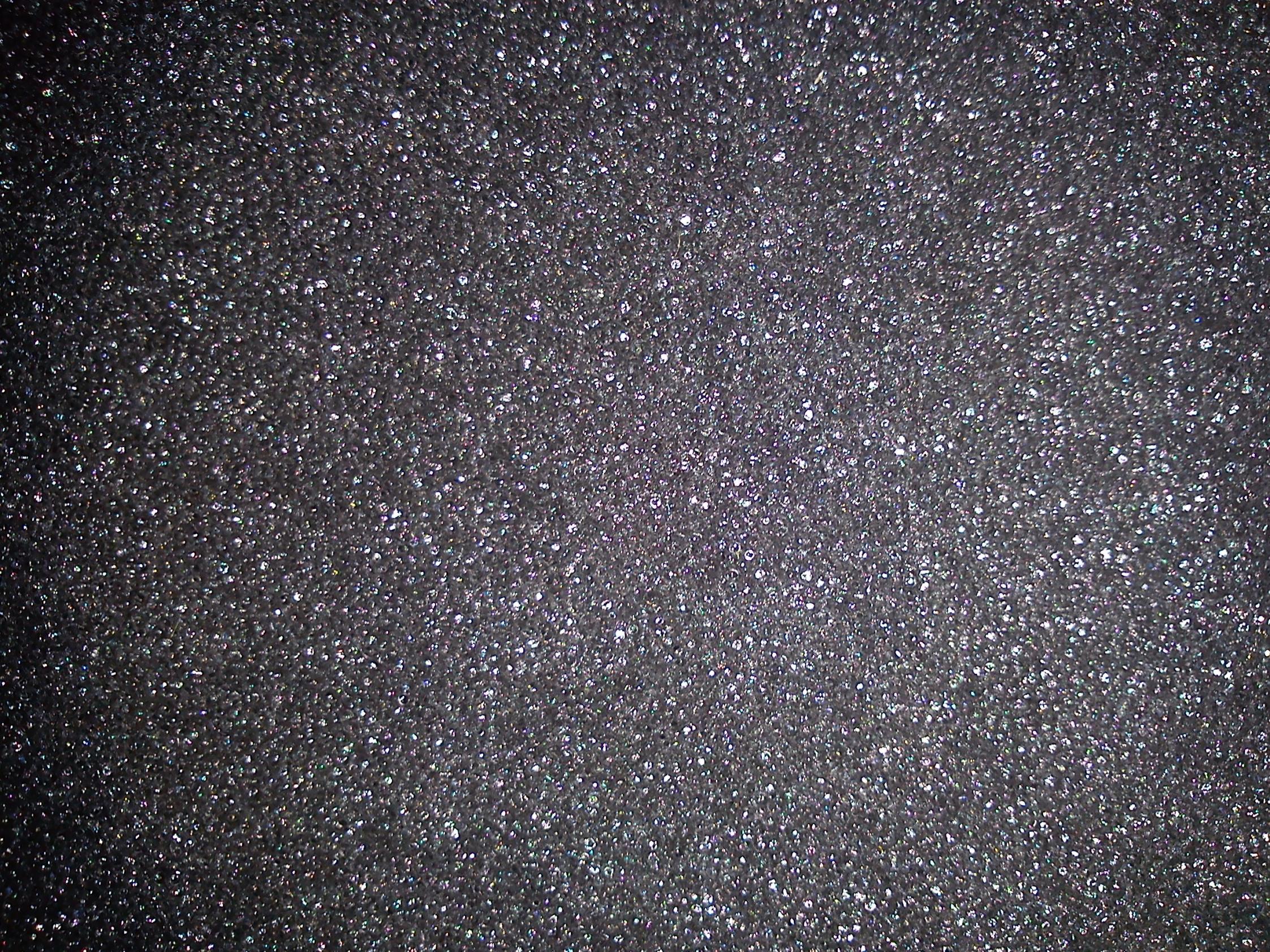

Self-adhesive bitumen pic + foam recommended for the local seller, I guess that will be not too mucho for the mid-high cabs two bitumen layers + one layer of 1cm of foam?

How thick is the bitumen? Aim for about 4mm thick total.
Under normal circumstances, I'd say 1cm of foam might be adequate but your top cab is a different situation which is actually good. The volume is too large for a sealed enclosure so use extra higher density foam to fill it up as I explained previously and therefore do a better job of absorbing the backwave. The sound will be cleaner. So 10cm thick in the back (top to bottom) and 2-3cm on the side, top and bottom walls leaving the driver free to breath all the way around (so maybe scallop a little foam out right at the sides of the driver).
For the bottom cab, I would try it first without the bitumen. 25-30mm of foam on the walls (you could try it with or without felt) should probably work fine.
