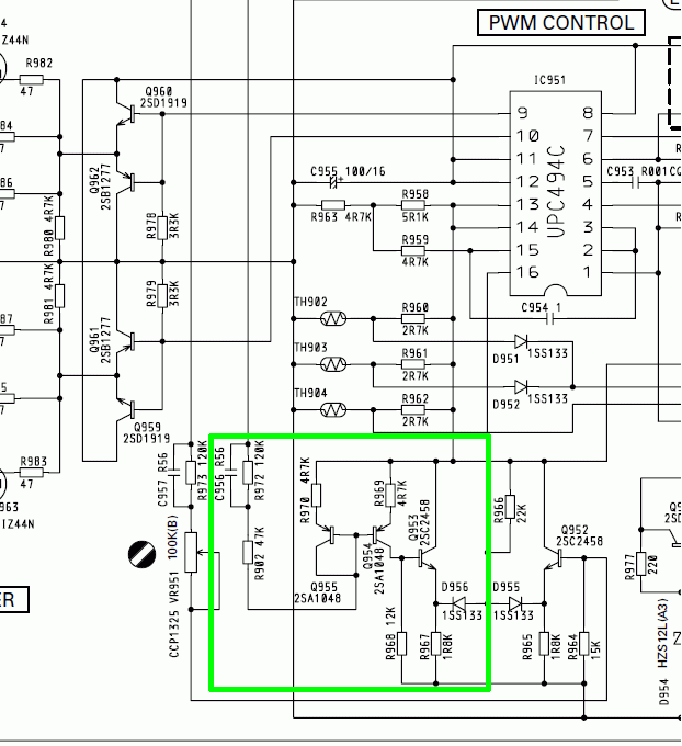

The highlighted components in the attached image show the part of the circuit that's supposed to roll back the pulse width when the negative rail voltage becomes excessive. If all of the grounds are OK, these would be the next components that you need to check.
I swapped the inductors and, surprise, the negative went down.
Now, with the VR951 all the way down, the voltages are +25,5V and -34,4V.
If I increase the positive to the expected working voltage of +30 the negative goes up to 39.
Now the gap is "only" 9V and the negative voltage is influenced by the VR951.

I know it's not of much help however the pin 9&10 voltage of the IC951 is now 3.84V, in line with the other working amp.
The bad news is that the VR951 is all the way down so I can not reduce the voltage to the desired 30V - something is still not 100% OK but way better than before. I think I'll re-mount the Sanken and see if it improves.
If it's regulated, it would regulate it with or without the inductors.
It's likely that the negative half of the regulator isn't working properly. If Q953 isn't conducting, it's allowing R967 to pull the voltage on pin 16 down which would tend to make the regulated voltage higher than it should be. I'm assuming that the pot should be relatively close to the mid point when the rail voltage is 35v.

The regulation control loop is compensated to be stable with the inductors in place (with a zero very close to LC filter resonance to provide some phase margin, see RC network before the pot). Removing the inductors moves the LC resonance to a much higher frequency (L changes from 135uH to a few uH from transformer leakage inductance) and is likely to cause oscillation, which may be fatal under load. Also, that kind of inductor-less regulation results in high stress on the push pull MOSFET, rectifiers and +B capacitors, and high EMI, I have analyzed it in detail on Alpine amplifiers.
Both rails are linked by duty cycle, they can't be regulated separately. The only way to get very dissimilar rail voltages on that SMPS topology is a faulty output inductor or capacitor, or a strongly unbalanced load. That's how I figured out that the inductors were the problem.
The feedback circuit just regulates the highest of the rails (at the expense of not controlling the other) but not in the same proportion, my math tells that the negative rail should be limited around 35V (R902) while the limit for the positive one is adjustable from 21V to 38V (VR951).
If it's not working that way, you should check all the feedback components (stuff around the green square) as Perry suggested. There may be an open resistor or solder joint on the negative rail sensing (plus the inductor problem).

In the W.E. I have checked the section Perry circled (well, squared) and all is OK.
I mounted the inductors I'm sure are OK and the finals. Voltage is OK. It's stable in the 35V for both rails. I'll check the other two inductors before placing them in the other amp that I use as spare.
