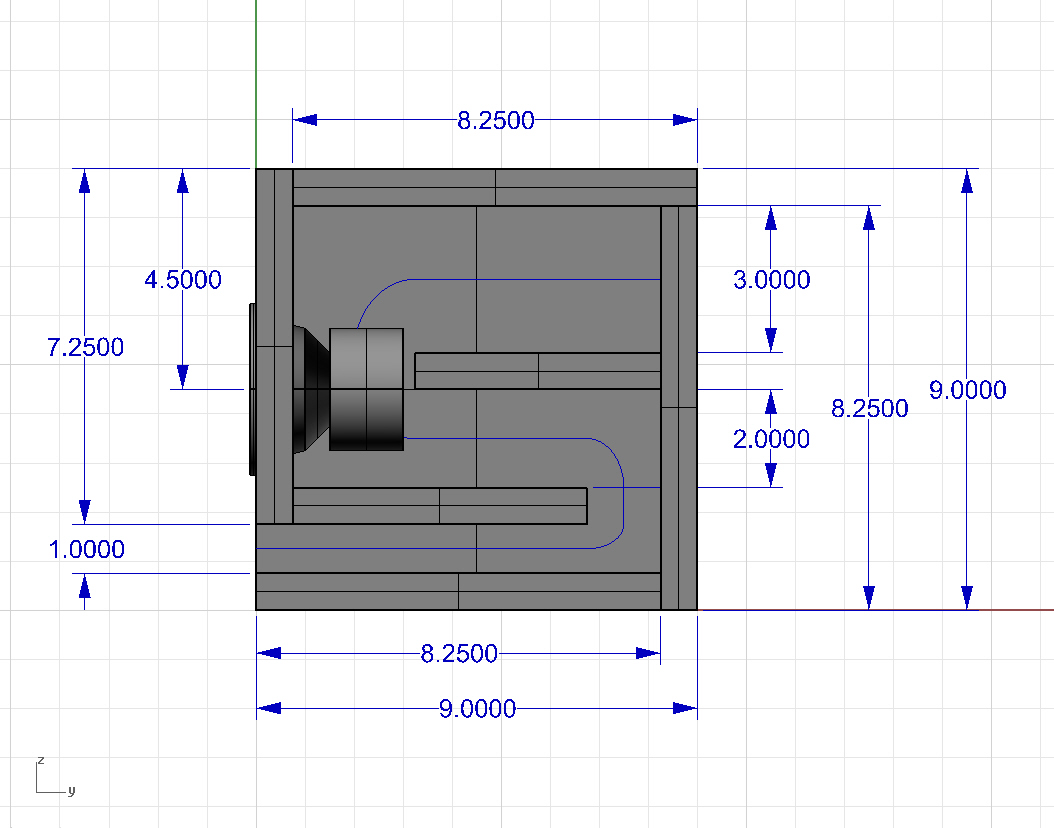

I built a pair of these boxes for those drivers. I like the sound of them.
Mike
Is this a Transmission Line? Looks interesting. Could you specify the cabinet width and MDF thickness used so I can calculate volume?
thanks
Edit: I deduce that you've used 3/4" panels.
It is a TL. I can't find the write up or the post from which I got the info, but the inner width is 3 1/2" wide. I believe I used 1/2" stock for it, but had to use 5/8" thicknesses for the inner pieces that made up the TL "dividers."
Mike

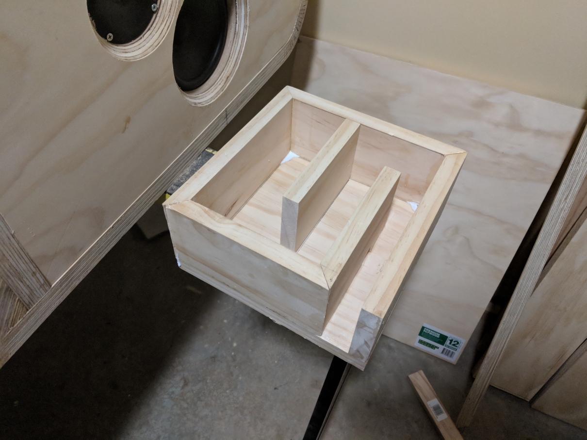

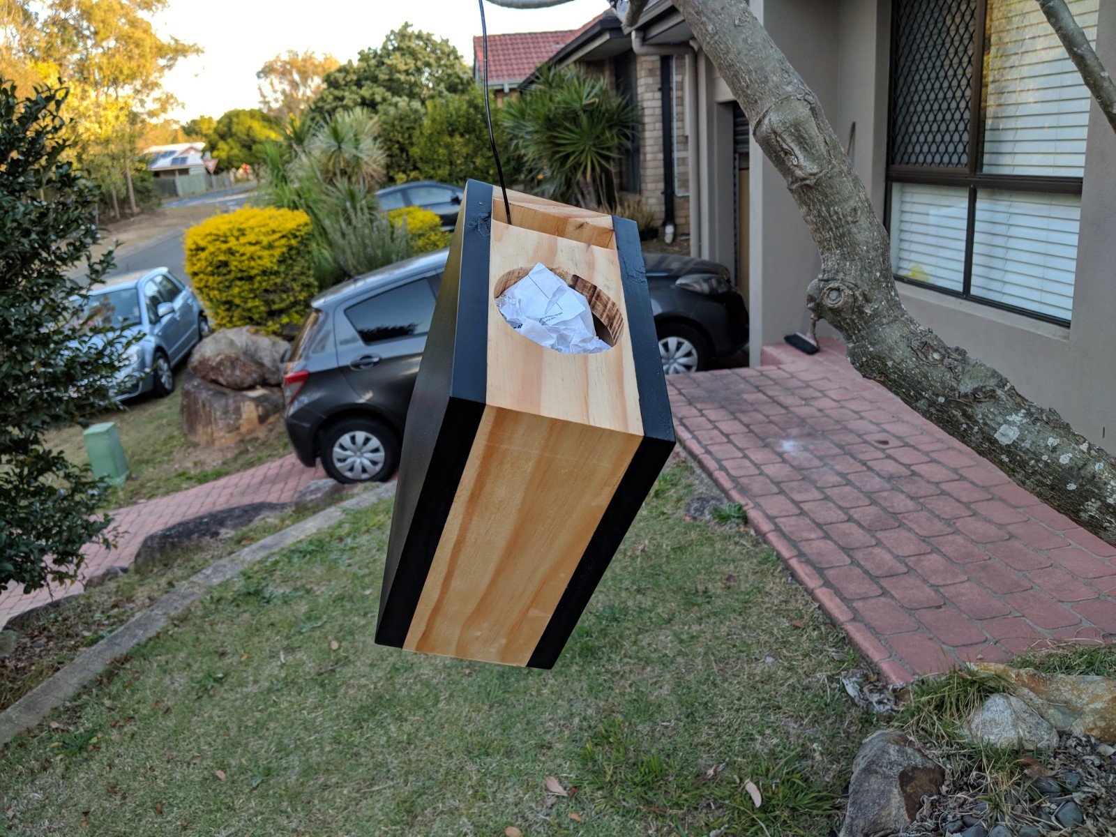

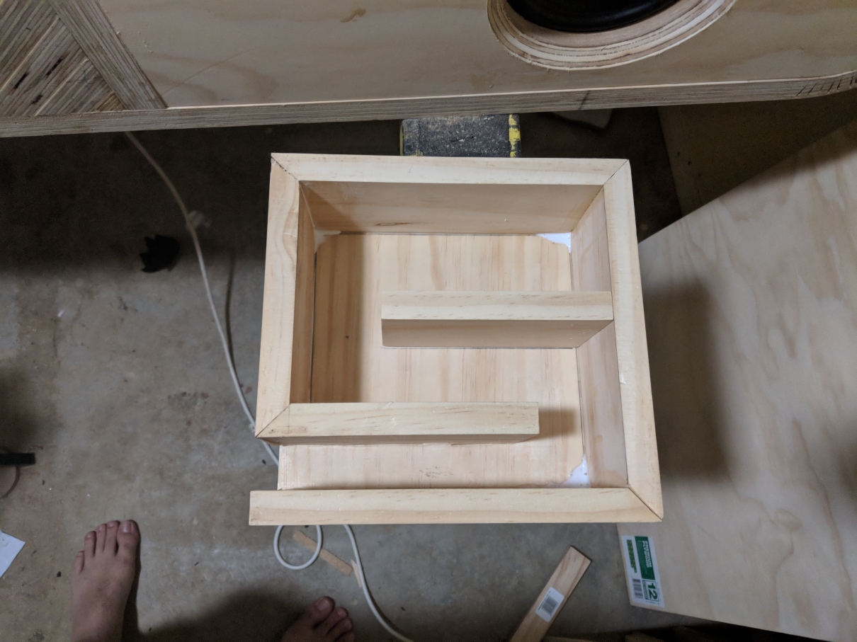

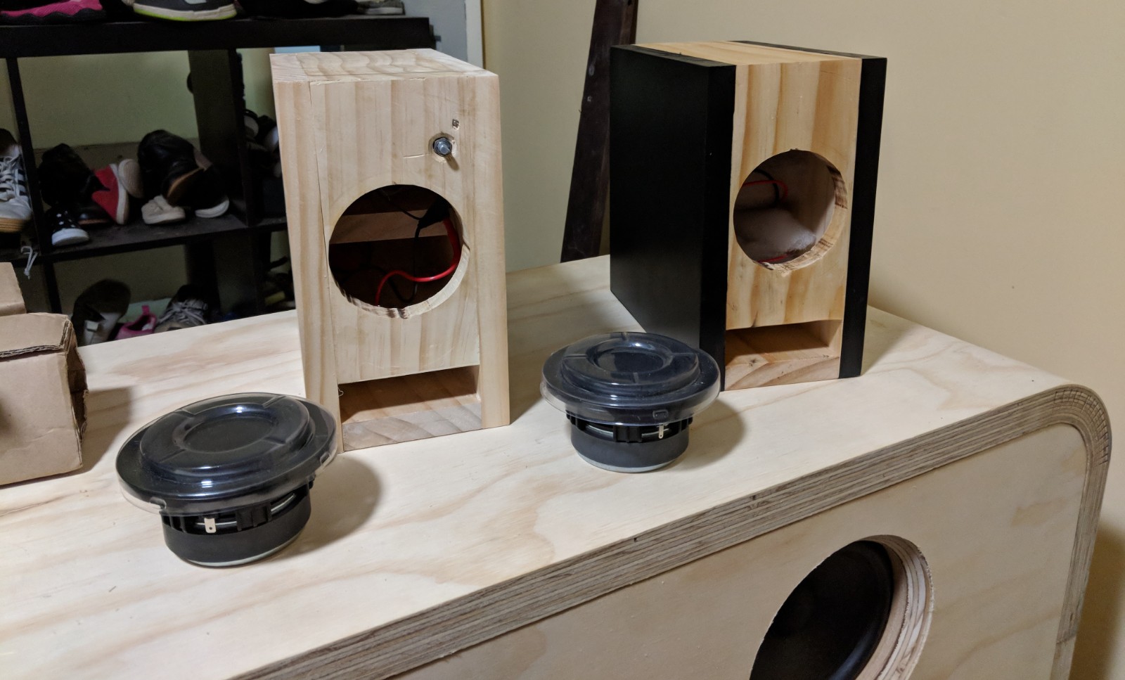

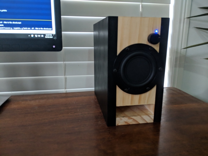

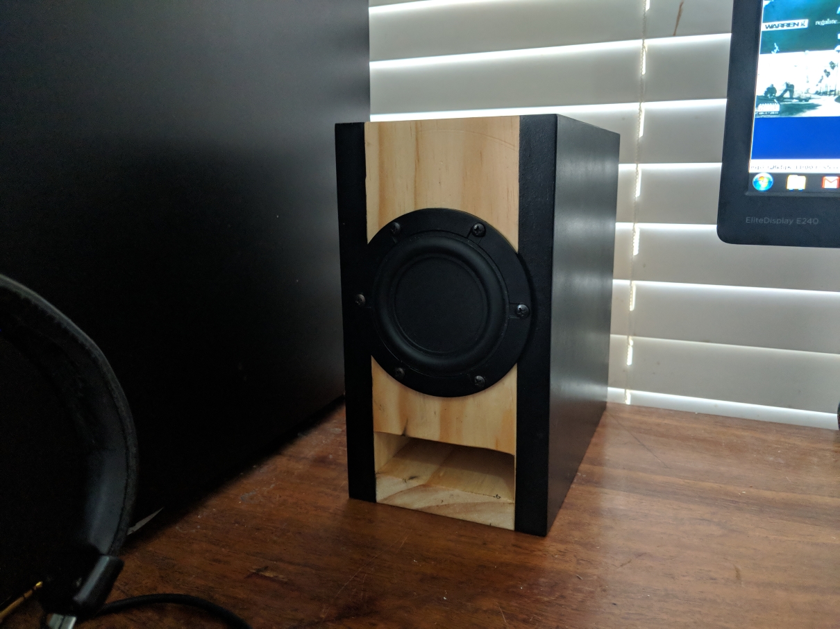

I know i'm about 2 years late on this post, but based on this thread and seeing what @mikejennens posted with the T Line i had a go. Used the T-Line Box, a pair of the tectonics and installed a Dayton Audio DTA-2 amplifier board (2x15w\ch) and it sounds pretty good. I have them at my PC and tested them on a few netflix movies and then some cd quality mp3's and was quite surprised.
