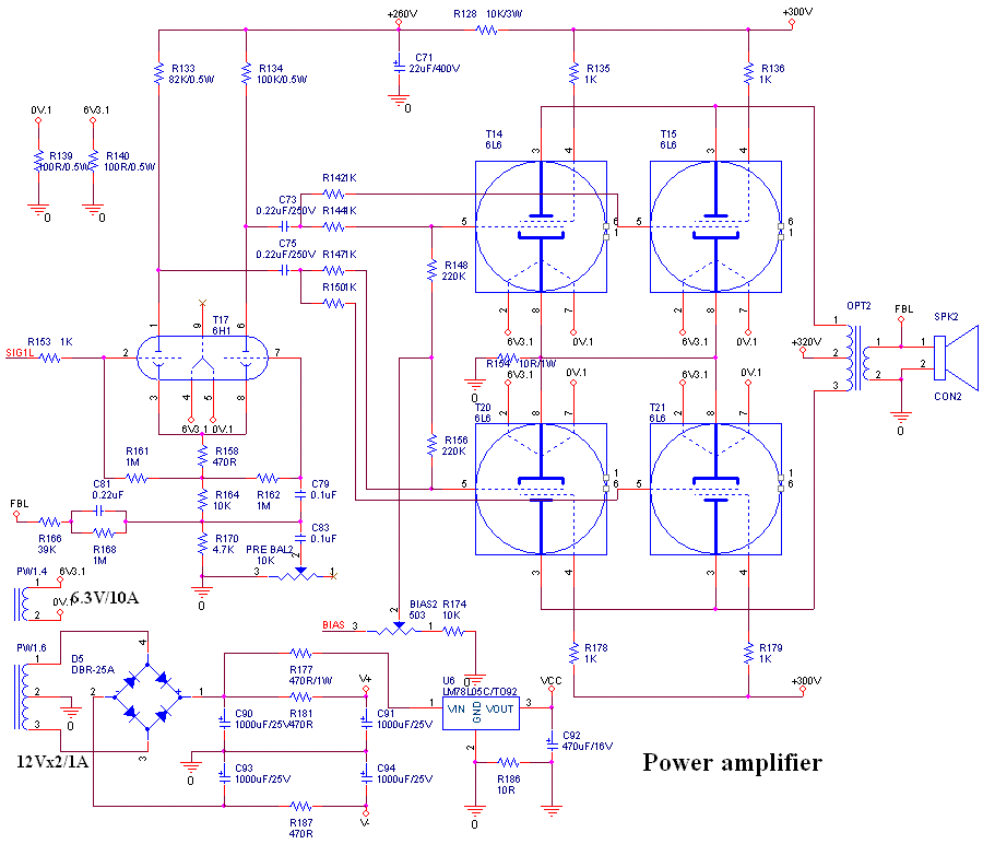

I was going to use a solid state rectifier because i have a load of dead smps boards from pc power supplies with 600v silicon rectifiers on them.
