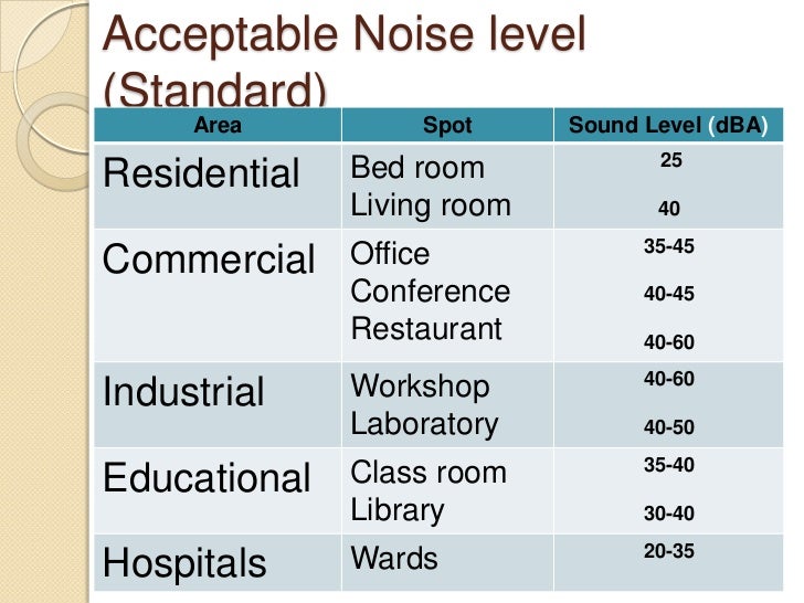

A wide-band residential noise floor of 45dB or lower might be a bit of wishful thinking? I have an app on my iPhone and iPad by Studio5 Digital that includes a rudimentary SPL meter, and FFT/RTA - it's quite interesting to be sitting at my office desk at break time when no machines other than the HVAC system running, and see fluctuations in the 65-70dB range, and just the typing on keyboard peaking at over 75dB A. What is even more interesting is the spectral content showing how much of that energy is below 100.
Noise in daily activities is definitely interesting! Not to descredit you in any way, as I've done the same with my iPhone, but obviously using an iPhone as a mic won't exactly be accurate- although they can give you some interesting relativity based information.
I got the 45dB from the average of a few sources; a few I can't find right now
NPC Resources: Typical Noise Levels
decibels, dB - Word Information
Room Acoustics and Noise Floor| JaguarAudioDesign.com Blog |
The Best Tweak - Make Your Room Quiet - Audiophile Review
http://image.slidesharecdn.com/nois...iation-health-effect-12-728.jpg?cb=1338793664
Acceptable <i>dB<sub>A</sub></i> Noise Level
