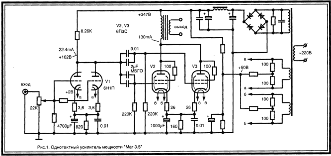

Also, due to budget constraint i've decided that the best way would be to go with these great Russian 6P3S-E military tubes, Russian equivalent of 6L6, that sound amazing given their pretty low price and ruggedness, but also due to the fact that 6L6 should be in theory a tube that's suitable for any kind of music. (please correct me here if i'm wrong). I have also considered KT88, but to be honest i don't know how well would it behave while playing tight and punchy riffs of AC/DC or Whitesnake - no concerns with classical though...
To add to the issue - i tend to think that a single 6L6 in output stage would somewhat be insufficient for driving the speakers while not being too distorted and compressed for the heavier genres, so:
I've thought of using 2 6L6 tubes in parallel to provide me with more power while retaining that SE nice tone.
Am i getting this part right, or am i just overly doubtful about a single tube in SE power stage?
I realize that i've written a lot, while expressing my opinion which is almost entirely made on assumptions (and experience in guitar sound, which i am uncertain how much i can use to get the HiFi sound i desire), so please comment on anything i've written here, i'd love to hear your experiences and recommendations.
Also, take a look at the attached russian schematic that i've found that uses 2 beam power tetrodes (6P3S) in parallel SE amp and let me know if this is any good...
Hope i didn't bore you to death with my theoretical/philosophical approach to this topic, but i have absolutely no experience with anything else going through tube amp other than a guitar or a bass (which is still a guitar :D)
Thanks a lot!

You reckon that SE even with double the tubes in output would struggle with 90db speakers?
What would "suffer" the most in that case? Would it be needed to run the amp really hard, introducing too much distortion/ lack of power/ weak bass/ or something else?

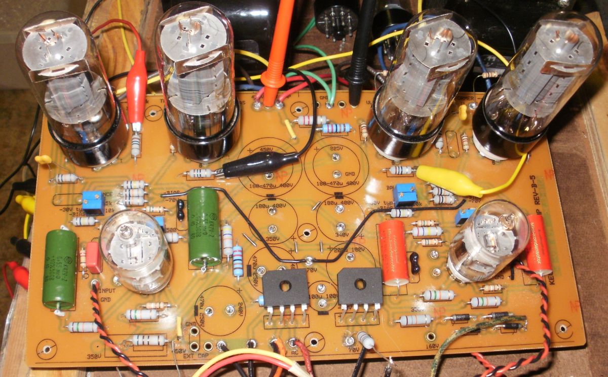

Just a pic of a 6L6 based PP amp with 6P3S tubes. Do you want to make one from scratch? This is a toner transfer etched in the sink version.
You can upgrade with Svetlana 6550=C= tubes, they can take higher screen and B+ voltages. The 6P3S tubes preferred 6.6kRaa output iron, the 6550 can handle 4.3KRaa output iron with minimal feedback.

Wow, that amp looks great!
yeah, i was going to build it from scratch...
I have a guy here in Belgrade that winds transformers, so i'll "design" transformers that i'll need - or order to my specifications rather than design.
Since PP amps need more components it might be a better idea for me to go with PCB version rather than point to point, which i adore and have plenty fun designing and wiring...
Hmmm - i always thought that 6L6 type of valve likes to see around 4k on primary of the OT when working in AB1 class :confused:
Is there any schematic you'd recommend going from for the beginning?
The first question that arises is - what sort of bias to use? Cathode or fixed?
Also what sort of phase inverter and first stage?
