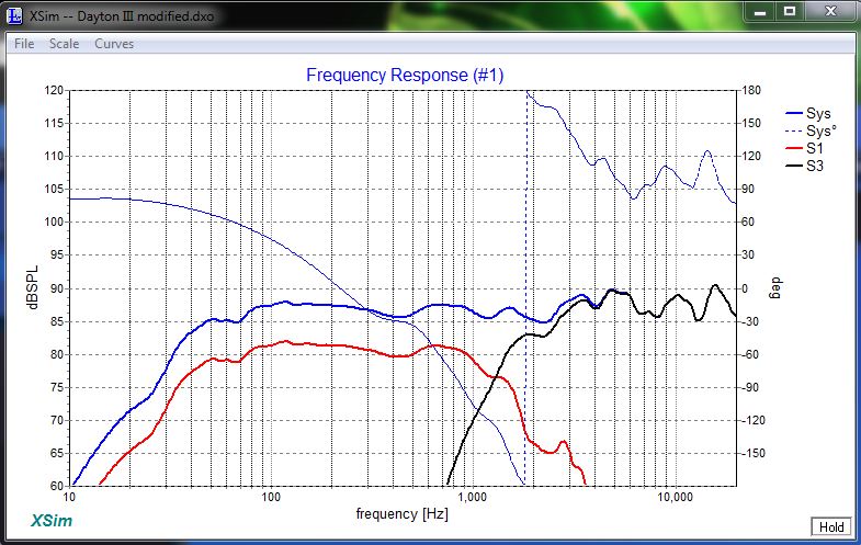

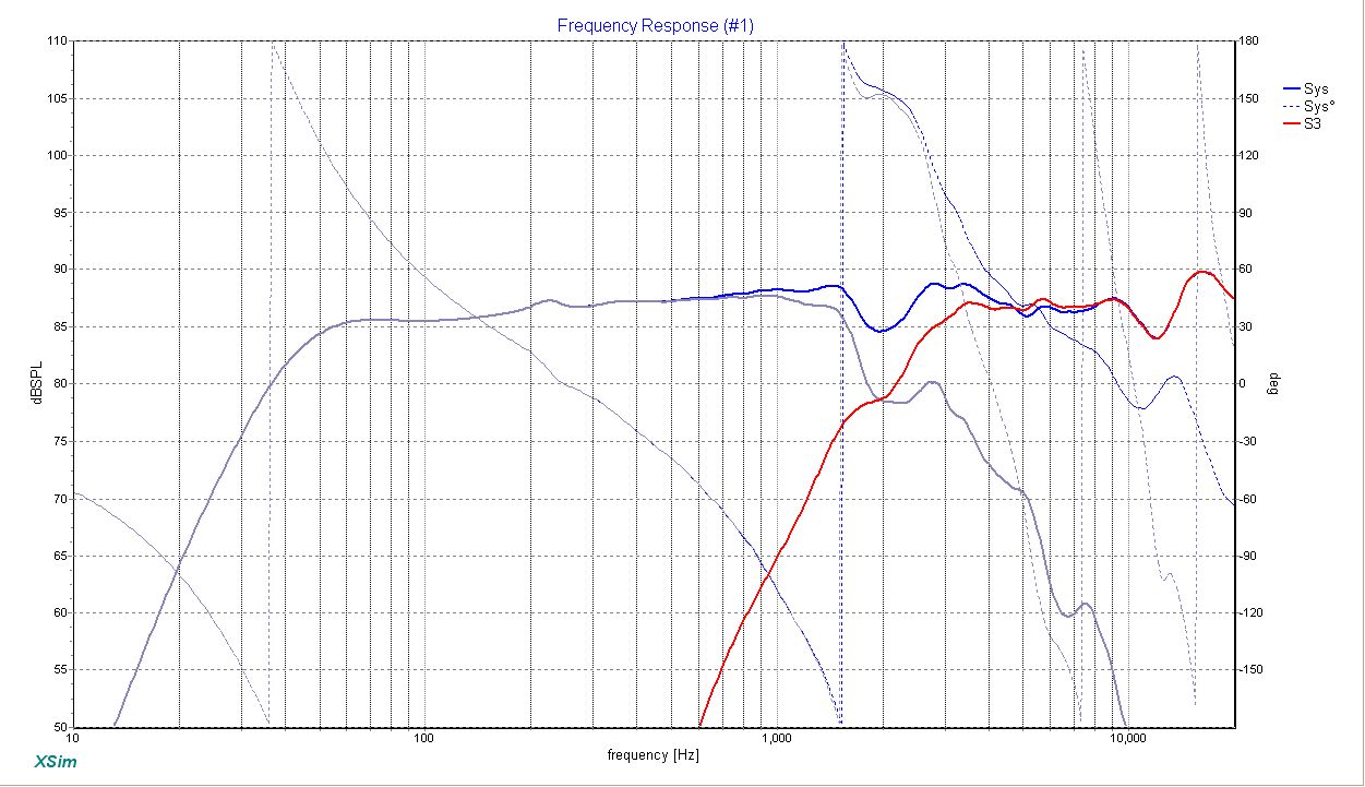

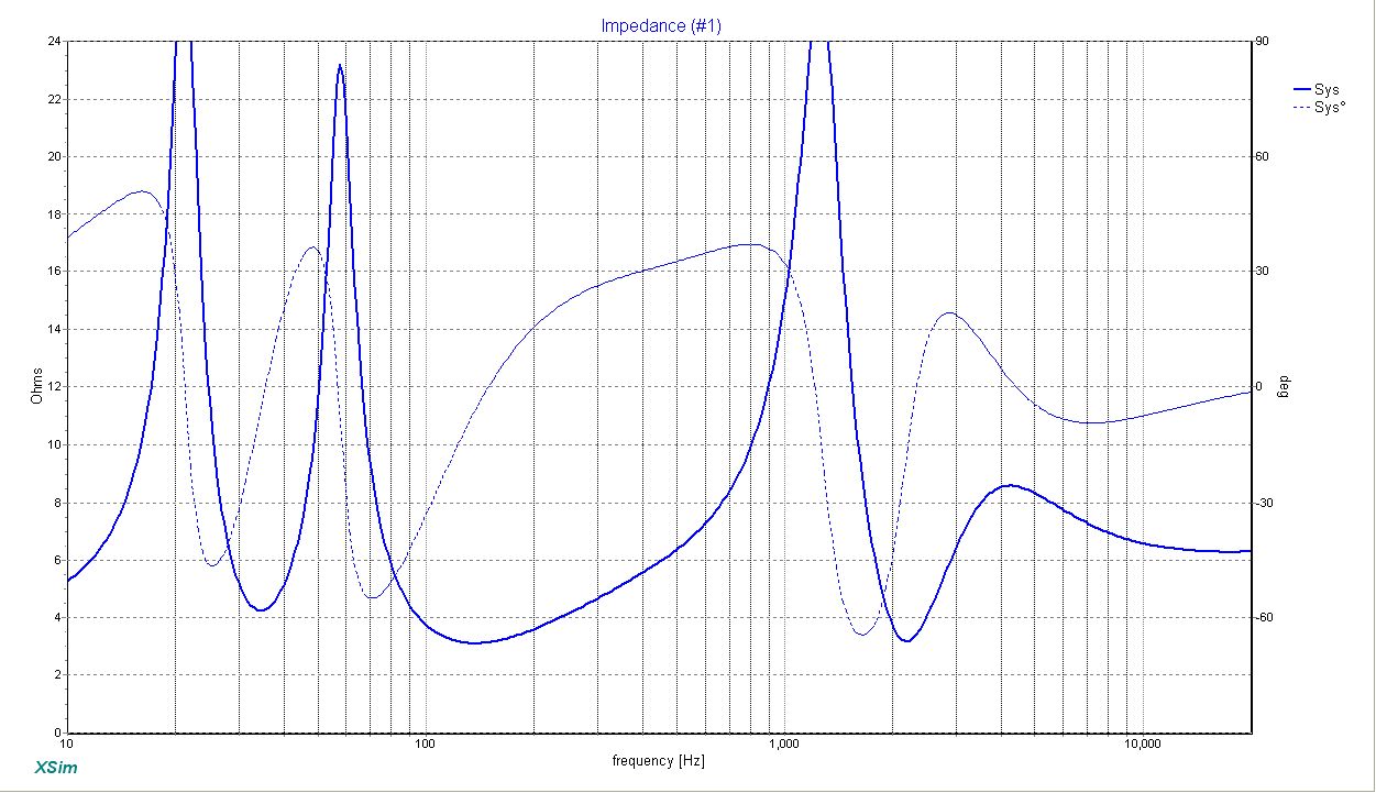

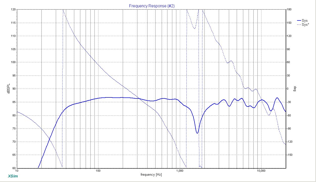

I fiddled around a little more and came up with this one. I ultimately turned the LPF into a 2nd order around 1500Hz which smooths out those goofy speedbumps at the XO by dropping the massive woofer peak while the tweeter is still 2nd order at 2k. I also got rid of that notch filter thing and added Erik's favorite symbols. :) I've left the tweeter 8ohm resistor there for now, which drops the tweet by 4dB - although the jury still seems to be out on the accuracy of PE/Dayton's measurements other than they're wrong. Either way, it's super easy to pop in, or take out.

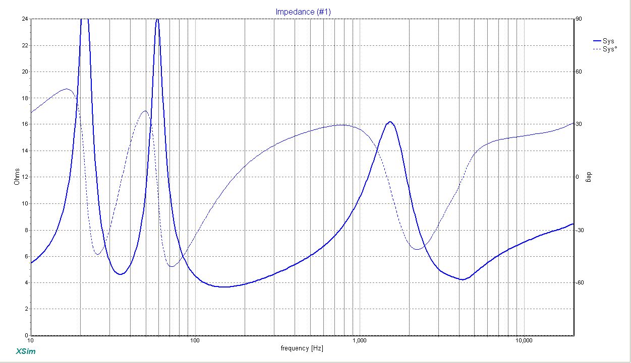

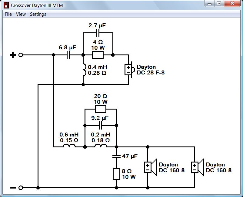

I tried whipping up a version where I hooked the DC160-4's in parallel, which looked quite nice actually - until I looked at the impedance graph and realized it would ultimately become a 2-3 ohm speaker. :eek: Shoulda seen that one coming. :p
My goals for this speaker are:
A) Make a reasonable first full-range speaker with a crossover that I (mostly) designed
B) Loud enough that it can easily be used for shop speakers or an outdoor boombox or tailgate with good, solid sound - but no critical listening will be done on these speakers, so I don't need to spend hours modeling and buying expensive mics and such to measure it out properly.
WinISD says that 2x DC160-4's in 1.2 ft^3 tuned to 38Hz will play at 104 dB at 50w without running out of cone excursion. F3 is at 35Hz and F10 at 28. Given that I haven't modeled the baffle or distances, would my goals be reasonable with this setup, or does baffling and distancing really play a huge enough factor that it would actually sound significantly different to the 'normal' ear that's not listening critically at a backyard party?

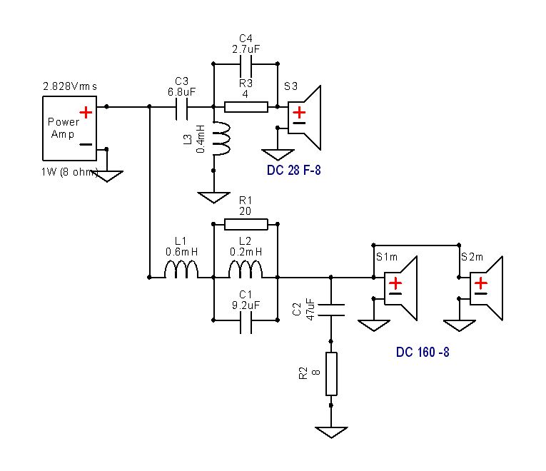

yup U need to model baffles, my instinks (sic) say your design will be more of a near field aka light on bass in larger spaces. Why? Because BSC is changed significantly. Yours needs double the L since you raised impedance to 2x the above the other design. unless you have hugely increased baffle faces or have fixed it in a corner wall.
BSC is largely compensated using 1st order from the total combination of series L at the speaker impedance Xsp calculated roughly when F (baffle width) is at -3dB /half power (Xsp=2*PI*F*L). You may get more spl's for the outside party but at a much leaner sound. that is why for 2nd order the L and C ratios don't follow normal electrical filter theory.
IDK but the d'appolito array was originally designed for 3rd order only, but that may have changed? see John K web site

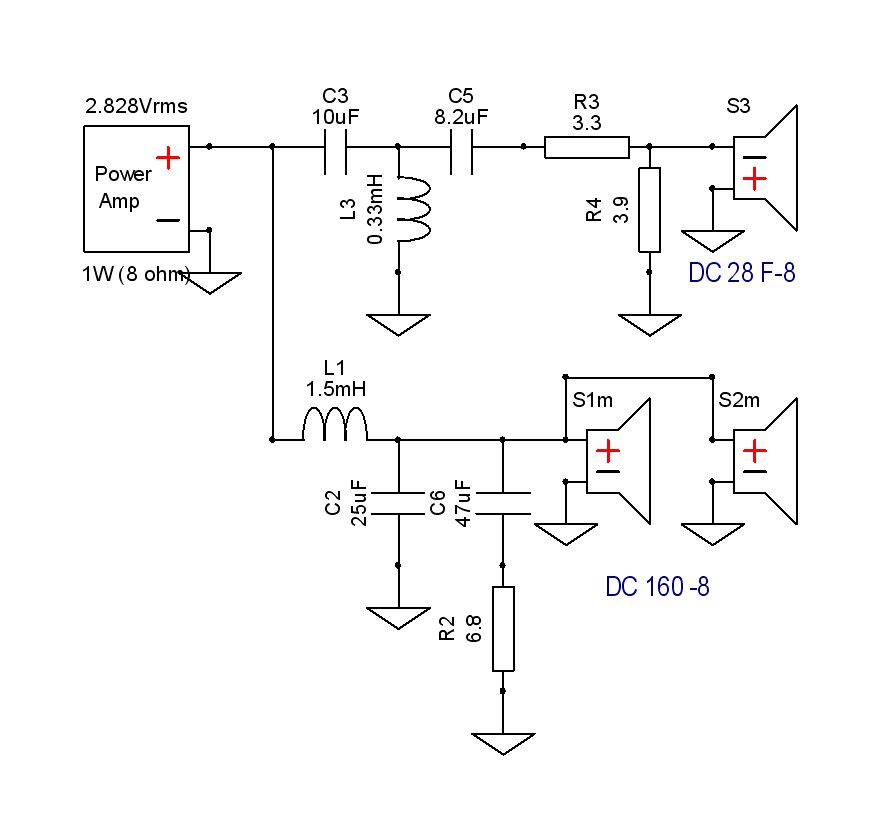

Infinia was trying to tell you that your initial filter made for
4 ohm nominal impedance ( 2 of 8 Ohm units in parallel)
has to be changed to accomodate for a new nominal
impedance of 8 Ohm( 2 of 4 Ohm in series). In order to
do that you would double the inductance value of an inductor
in series with woofers and since the situation gets complicated
regarding the space you want your speakers installed, this
may influence the filter parts values in a way that you may
end up using completely different values. In short, the closer
your speakers are to the walls, the less you need to think
about BSC. The farther you get out in free space the more
you need BSC so it sounds fuller.

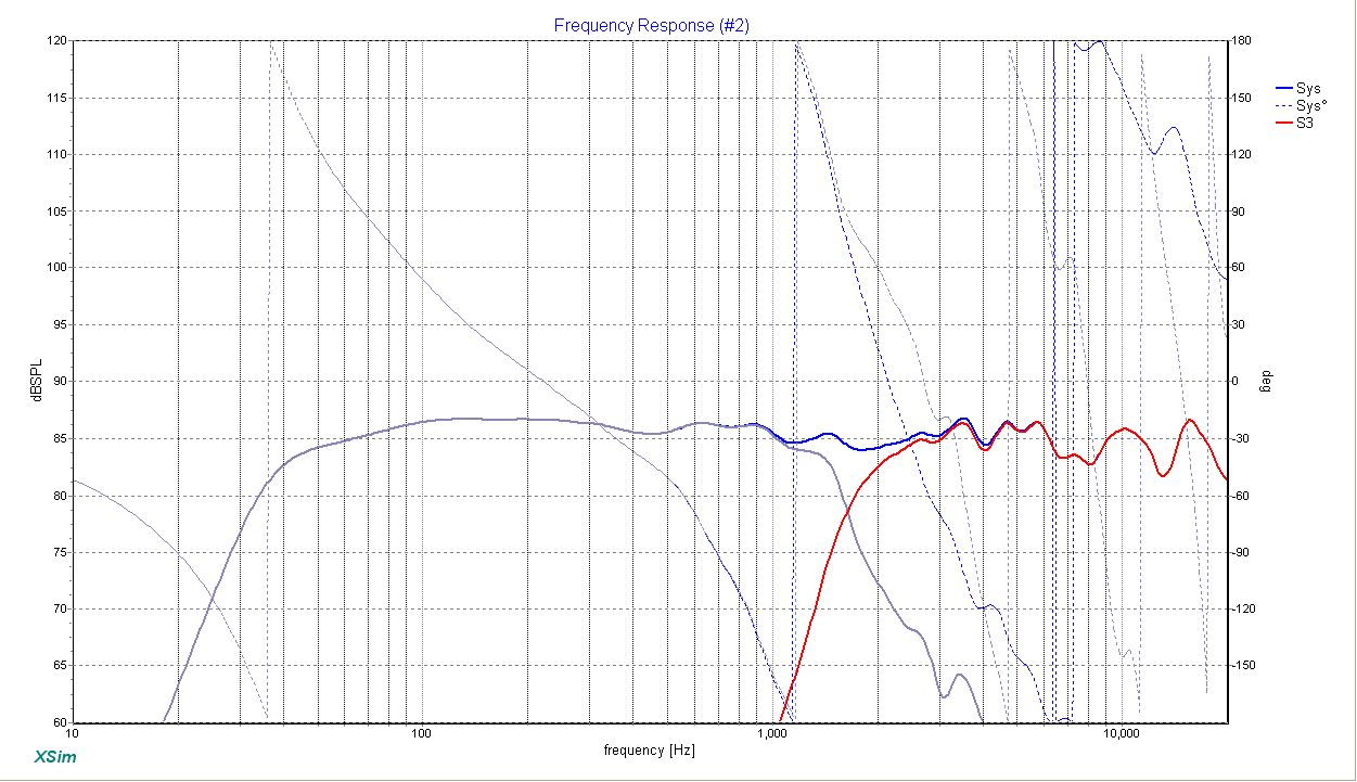

Shall I attach the 4 ohm woofer frd's and bass reflex zma's
along with Zaph Audio tweeter frd and then you can play
with it?

take your 2nd order low pass filter, if you make L dominate it behaves like a 1st order filter before the C kicks in. .
use the classic formula for Xl = 2*PI*F*L at the half power Xl = R load (speaker impedance by definition) use this to compensate for baffle loss. (valid assumption assuming effects of LC is more than a couple of octaves away.)
then solve for L given the baffle dimensions estimate frenquncy when response falls by half.
select L from a vendor and model Rdc parasitic losses in your favorite bass box calculator.

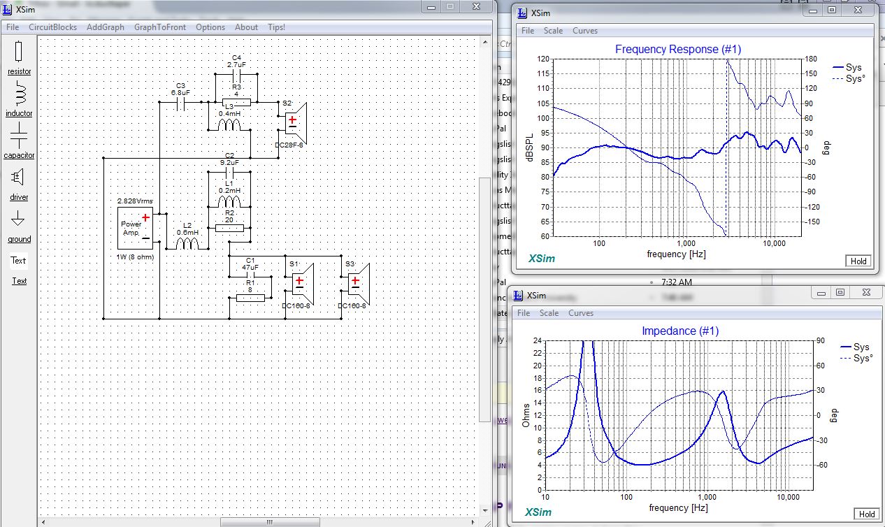

I thought I already compensated for the ohm change...? My inductor value increased by .2mH, I changed it into a 2nd order, and I dropped the crossover point by 500Hz to boot. At this point, I'm not really worrying about the speaker placement as it's intended to be a very portable setup and not sitting in one particular spot at all. I just want to get it sounding "pretty smooth" in an outdoor environment for this one. More complicated and proper versions may follow, but I don't need to go too crazy on my first build. I should figure out how to add a baffle to Xsim though...
Sure! If it's not too much bother, that would be awesome!
that's the 1st step in any good speaker design deciding how much baffle loss your going to tolerate, everything else follows. it's not a simple tweek unless your spare inductor /parts pile is large. Id assume the design your basing yours on has been voiced for decent bass so simply scale it by a factor of 2* (0.6+0.2)=1.6 mH. otherwise... enjoy your lean-n-loud but less sensitive speaker
